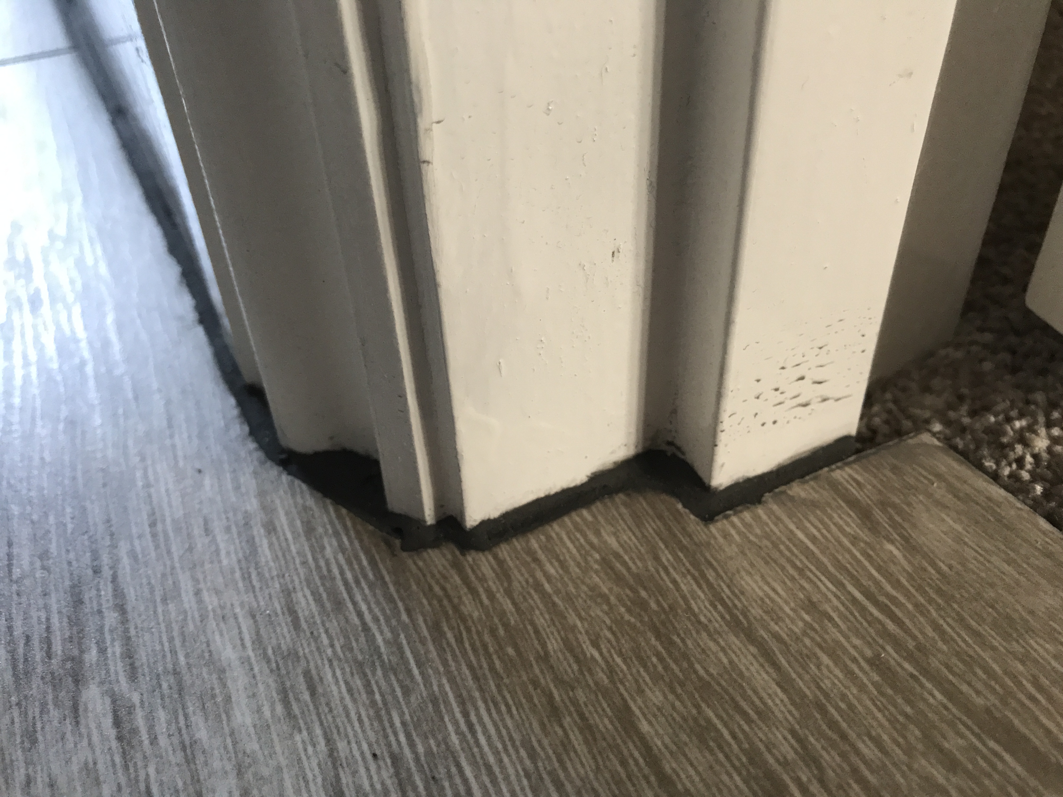

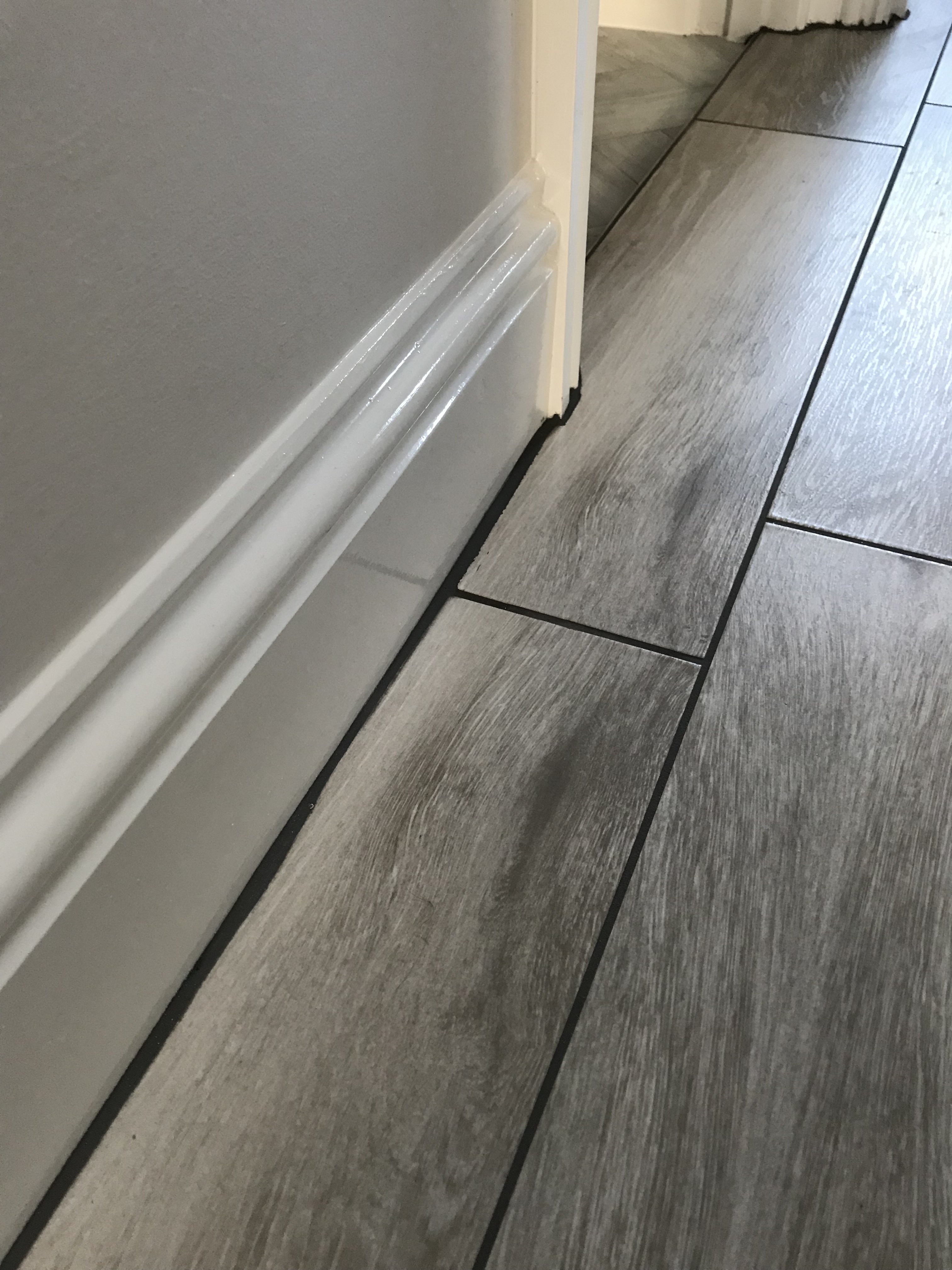

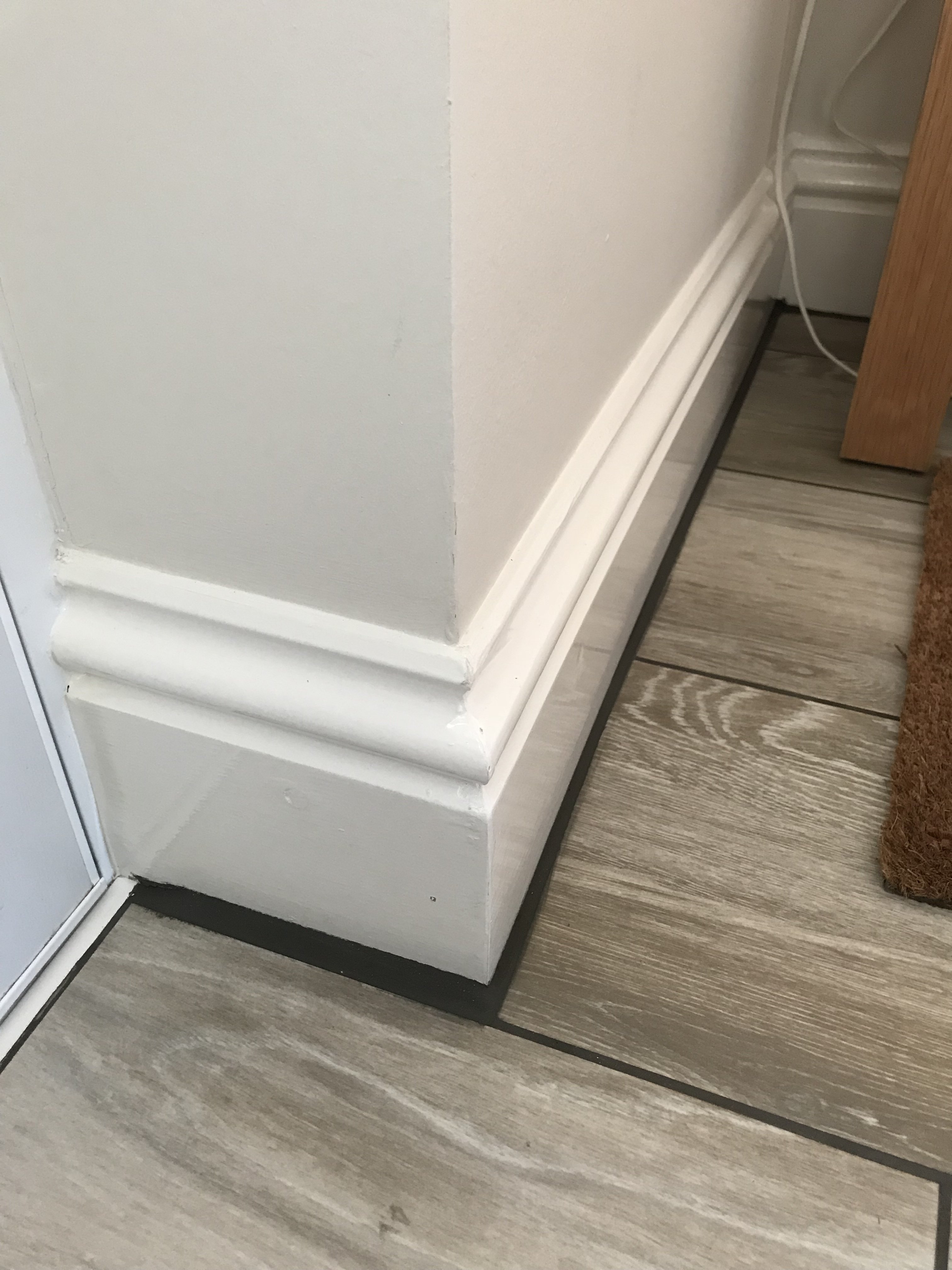

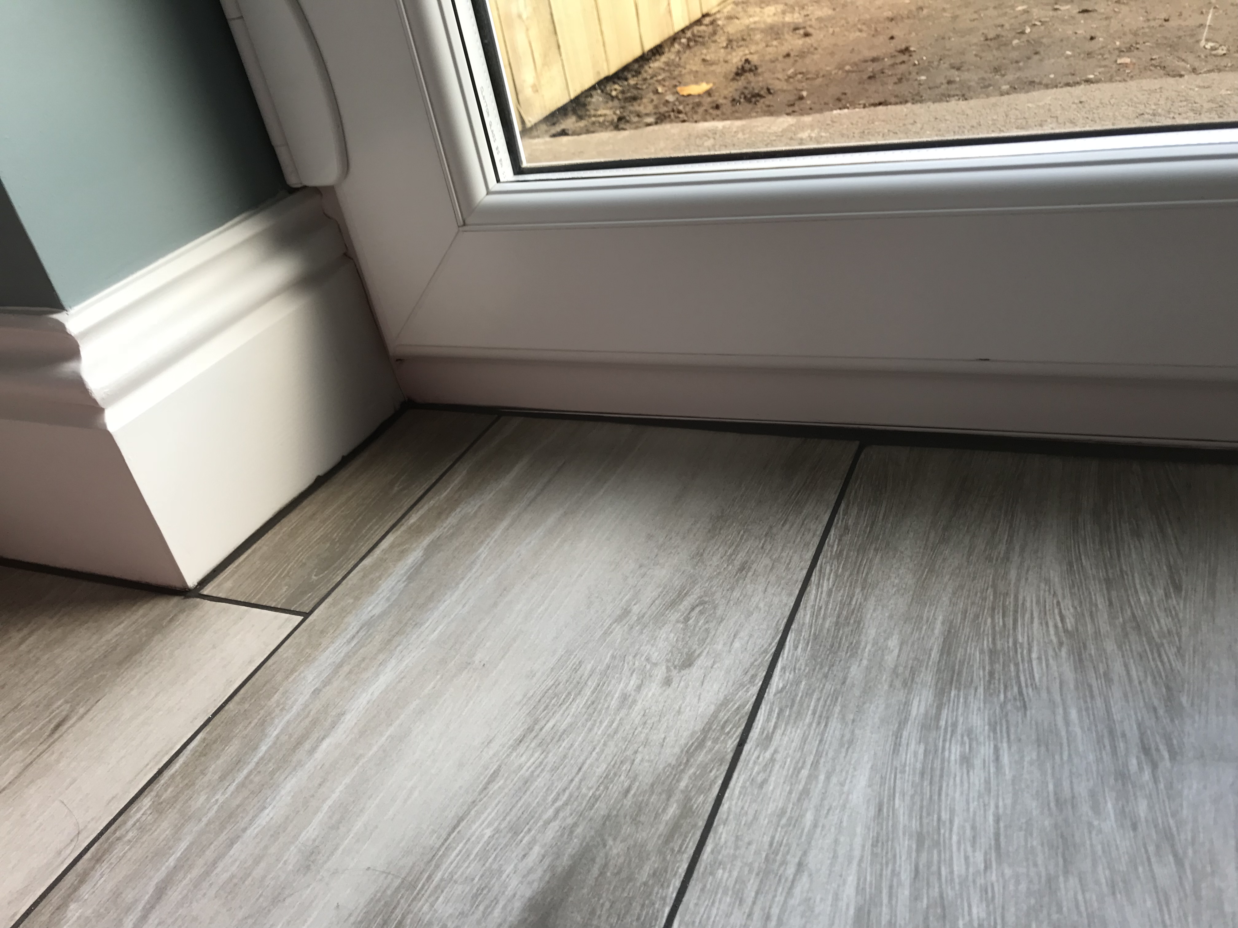

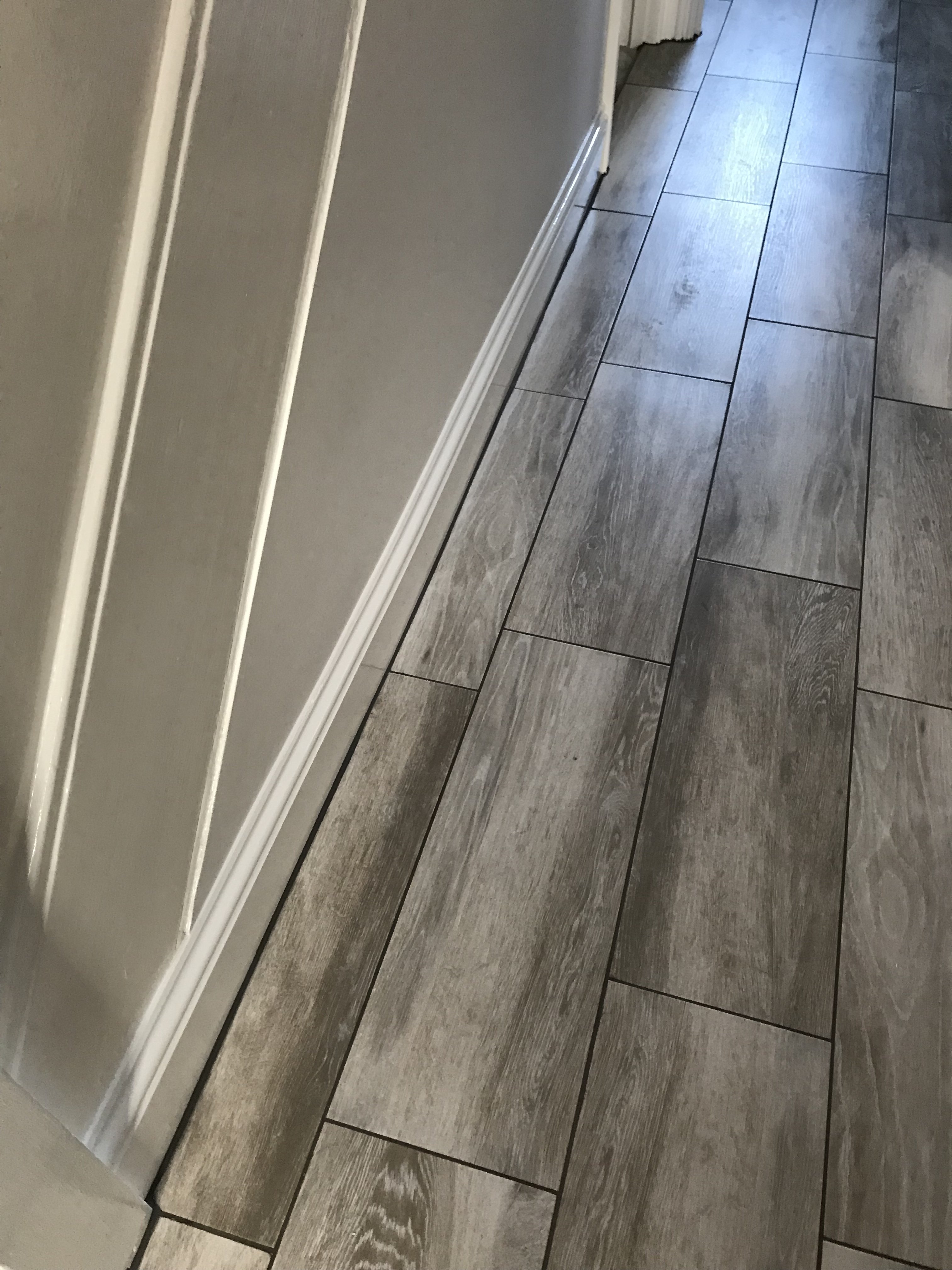

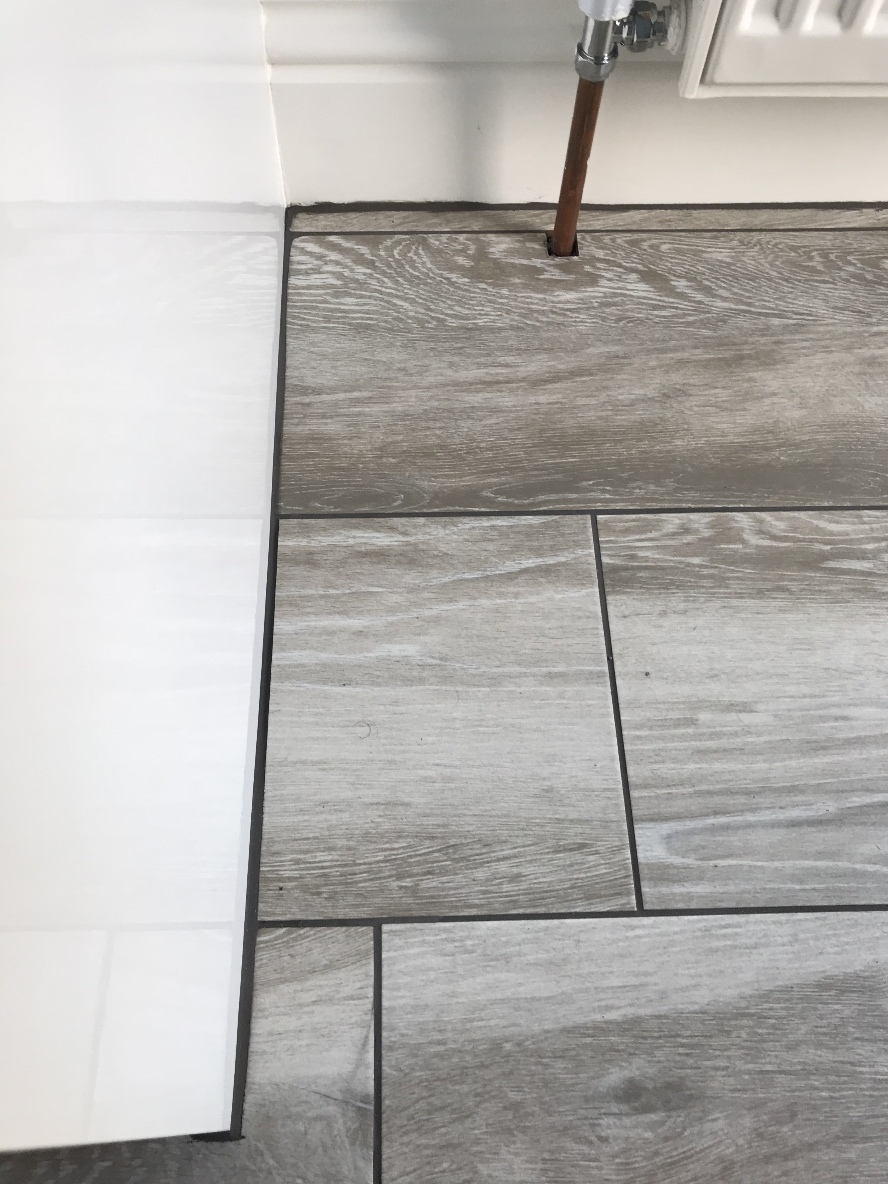

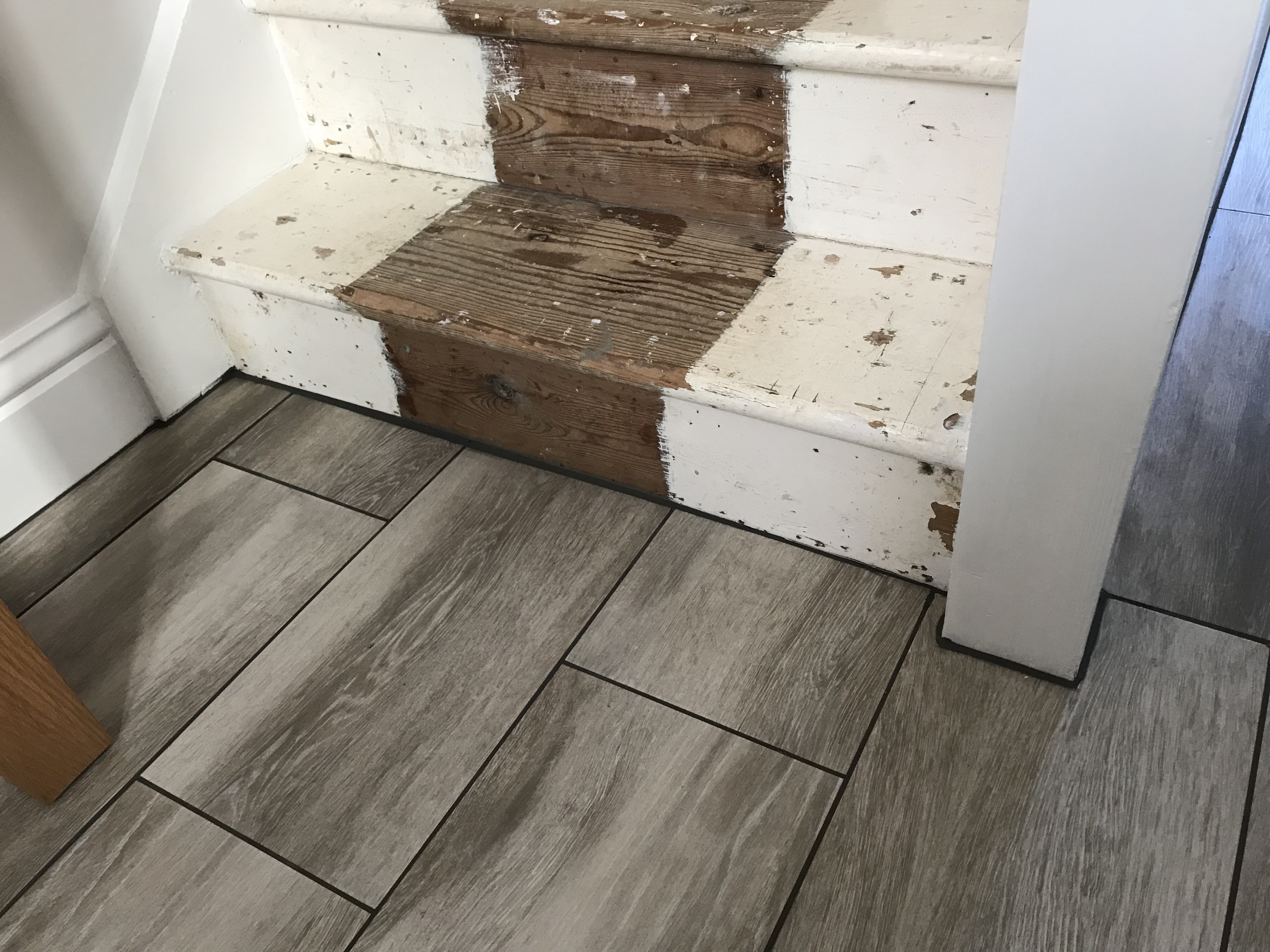

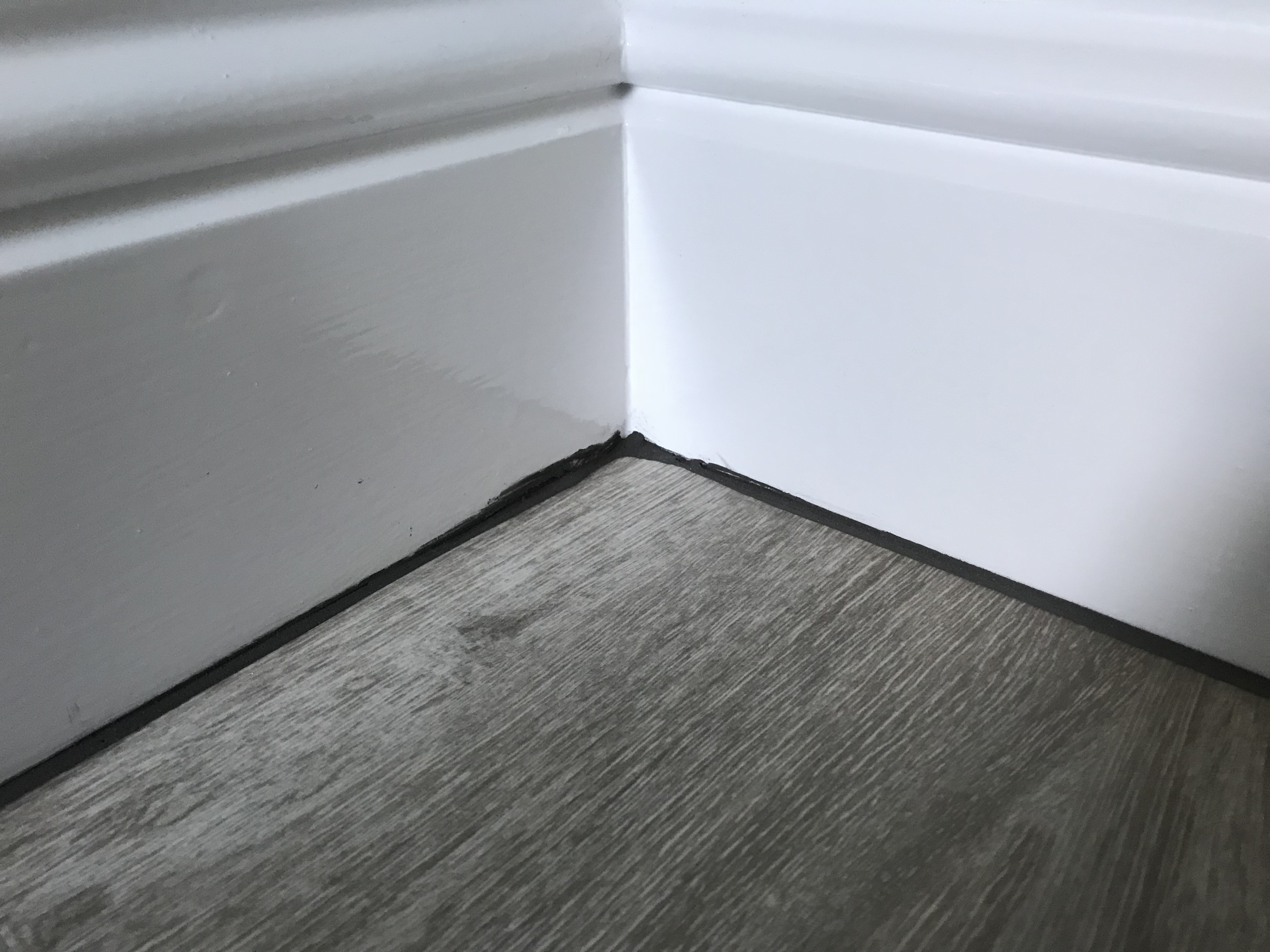

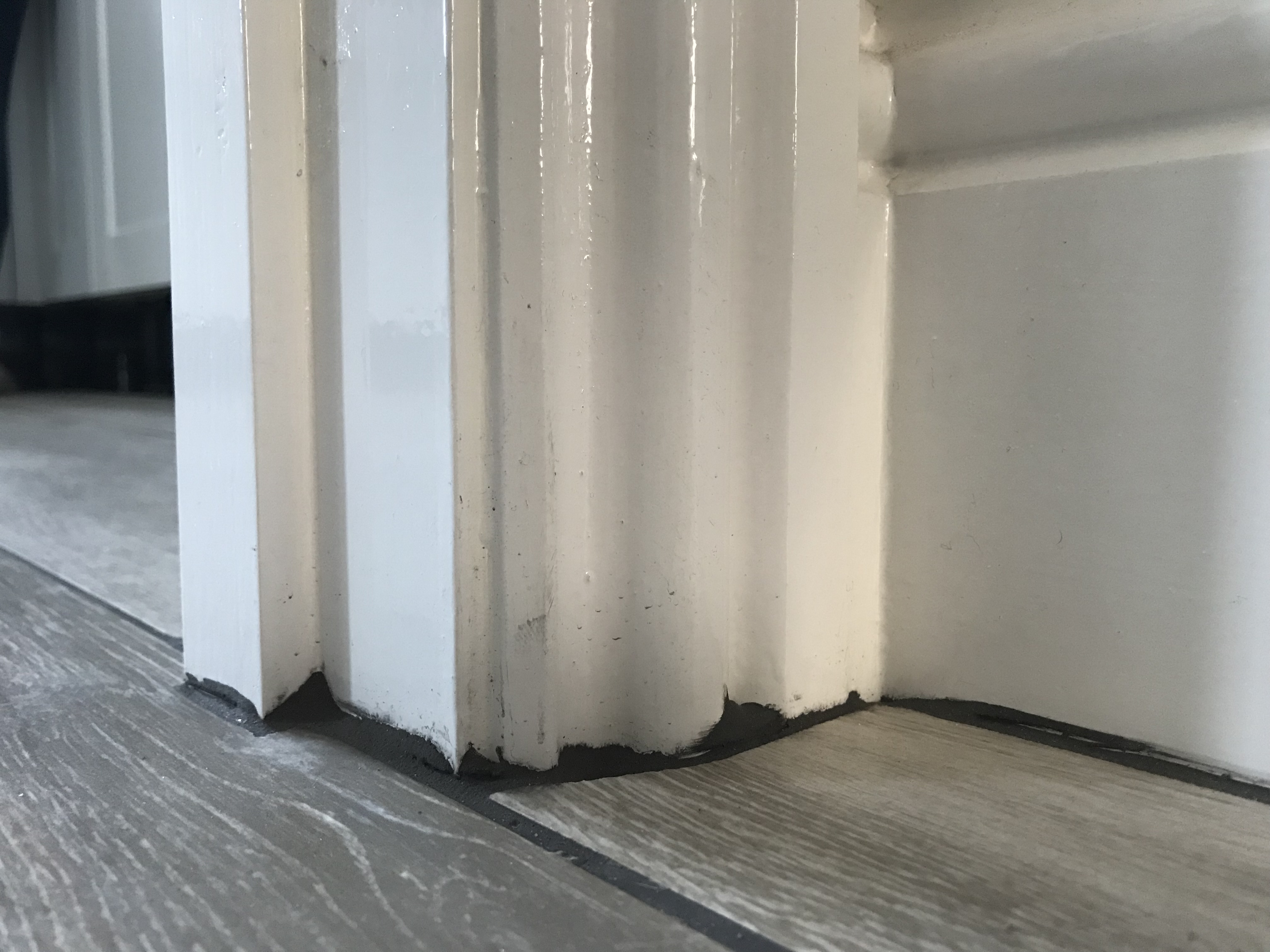

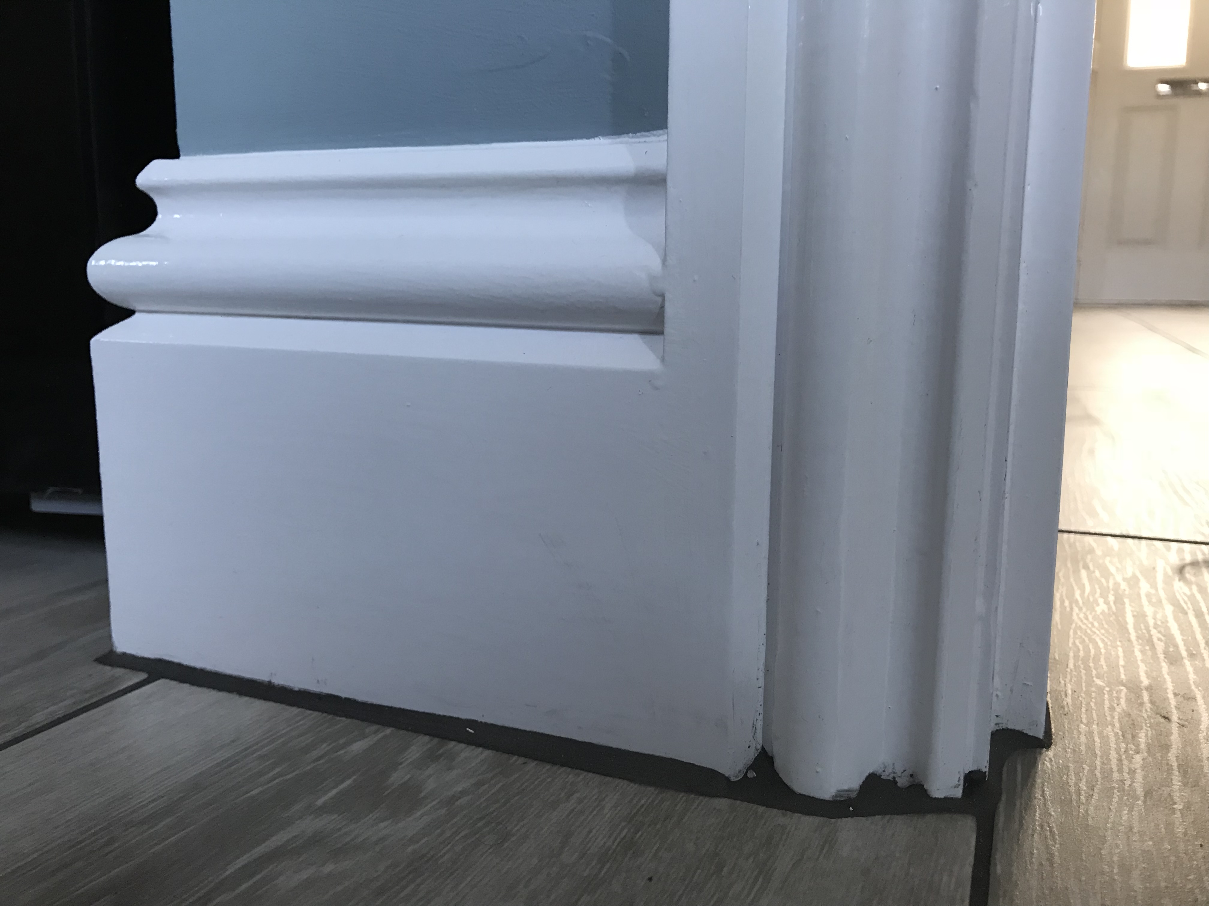

The problem that I would like to ask advice for is the quality of the grouting around the edges that are next to the skirting boards.

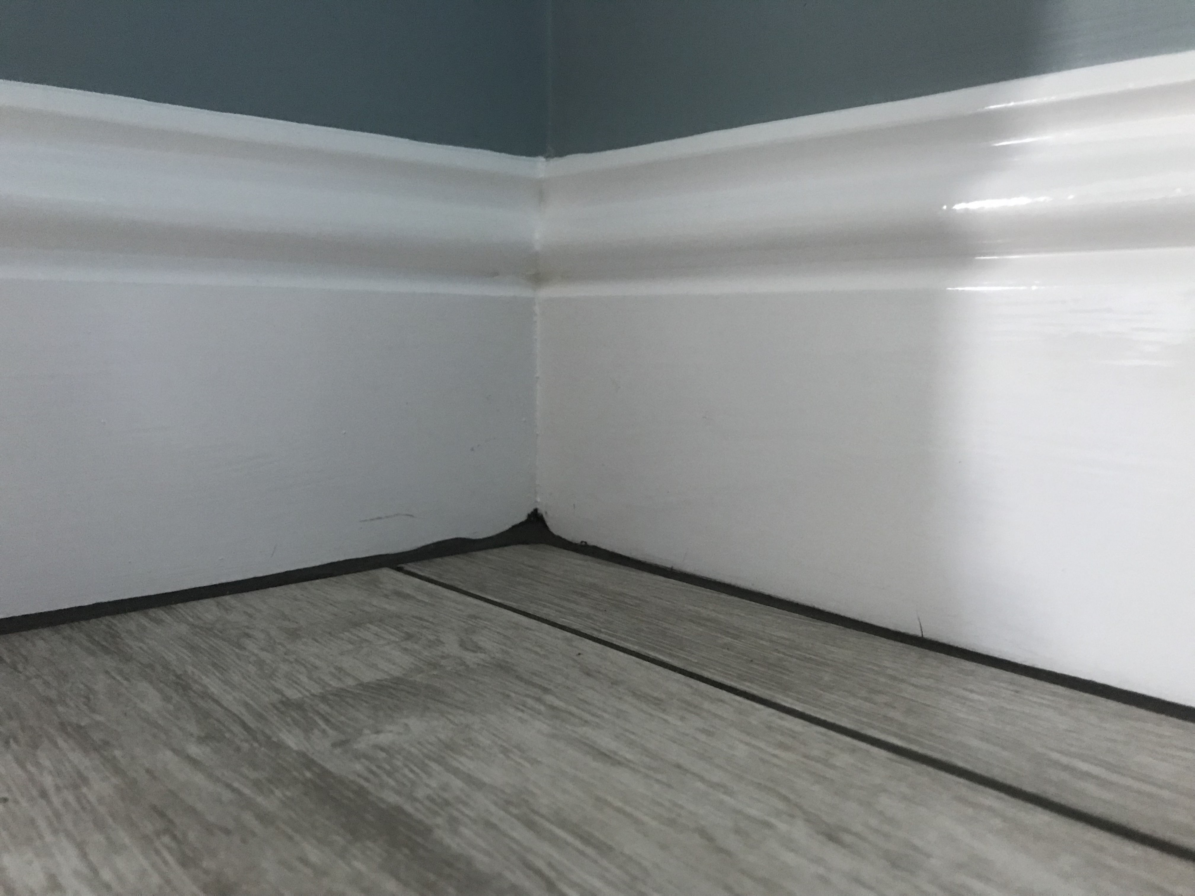

In places the line of grout is very uneven with wide and then thin parts.
The grout in places is not flat at the edges but has been sloped upwards - something I’ve not seen before.
The corners look really bad.
Generally speaking we are fairly happy with the tiles and grout lines between tile to tile but at the edges where the skirting boards are - in my opinion looks terrible!
As a complete novice and someone that’s had no prior need to use a tiler until last year I was just wondering if what I am describing/what can be seen on the photos is considered acceptable?
In my opinion I don’t think that it is acceptable and we are certainly not happy with finish at the edges considering the amount of money that we have spent.
Could someone give me some advice please?
And how it can be rectified?
I intend to tackle the issue next week with the tiler directly as he’s coming back but I’m unsure how this is going to go.
So far we have had a pleasant relationship with him - so that has to be a plus point doesn’t it?

As he’s tiled up to the skirtings, the joint between the floor and skirting should really be Silicon, giving effectively an expansion joint around the floor area.
It’s just not very tidily done tbh.
Get him to remove grout and clean the the skirting and replace with white Silicon to match the skirting.
Dark pigment grouts are notorious for staining everything they touch and a mare to work with at times, I’ll always advise that some paintwork re finishing will be necessary.
It’s nothing worth getting in to an argument about, if that’s the way you want it to be finished, then he should respect that and change it accordingly.
In a perfect world, the skirtings would have been fitted after the floor was completed, eliminating this kind of issue.
I’m guessing that taking the grout out and applying white Silicon as a replace will be an easy job?
You’ve had the skirting gloss painted before the tiling was done and now the dark grout is standing out.
Like @3_fall in this instance a movement joint is required. Normally this joint would either be siliconed in a acceptable colour white/black or the decorator would normally use a flexible chaulk which would then be painted to match skirting.
As @3_fall and @timeless john said, it should have been siliconed as it needs an expansion joint a better finish would have been skirting removed and replaced on top.
It also looks like the tiler has cut around door frames and not finished it well.
Ideally he should have cut the frame and slid the tiles under to give a cleaner finish.
You are best to ask him to come back and remove the grout and replace it with Silicon.

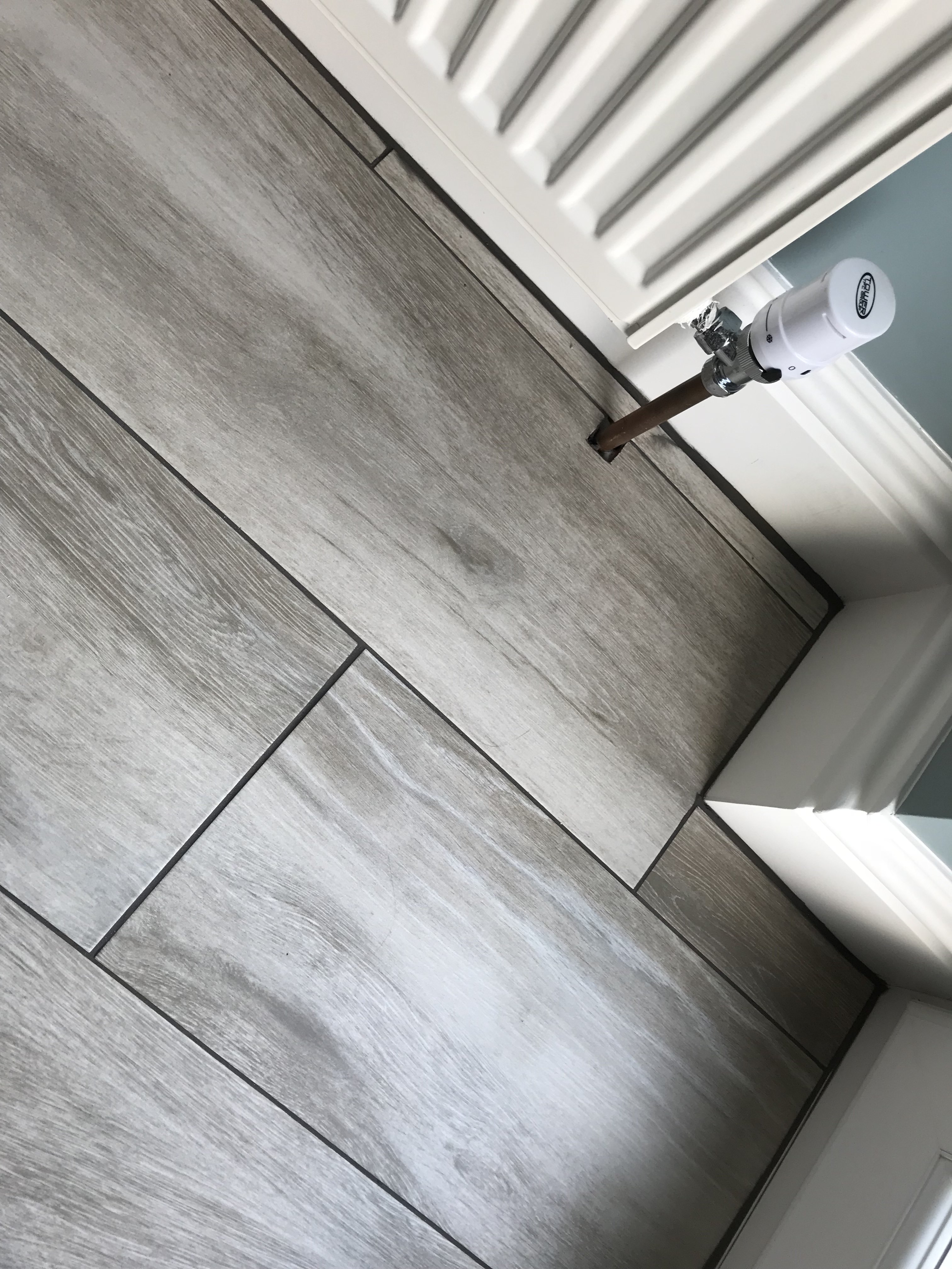

Also you can purchase pipe collars for the radiator pipes to tidy it up
