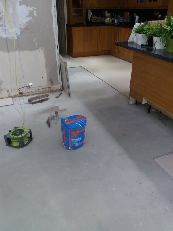

I wouldn't walk all over wires with spiked shoes personally. I use a spiked roller with an extendable painters pole which goes to about 3m long when it's extended, that's normally plenty, it really really helps to spread it out nice. If you do need to get down and trowel it, I normally just tickle it with a large notch trowel so your only moving 50% of it with a sweep, if not you end up just moving the slc away and causing more problems than your solving.
I always mix a full bag at a time, then when it's ready to pour I pour about half into a normal size bucket so it's more manageable then I pour it in a line etc so it's not all getting poured in one big heap
