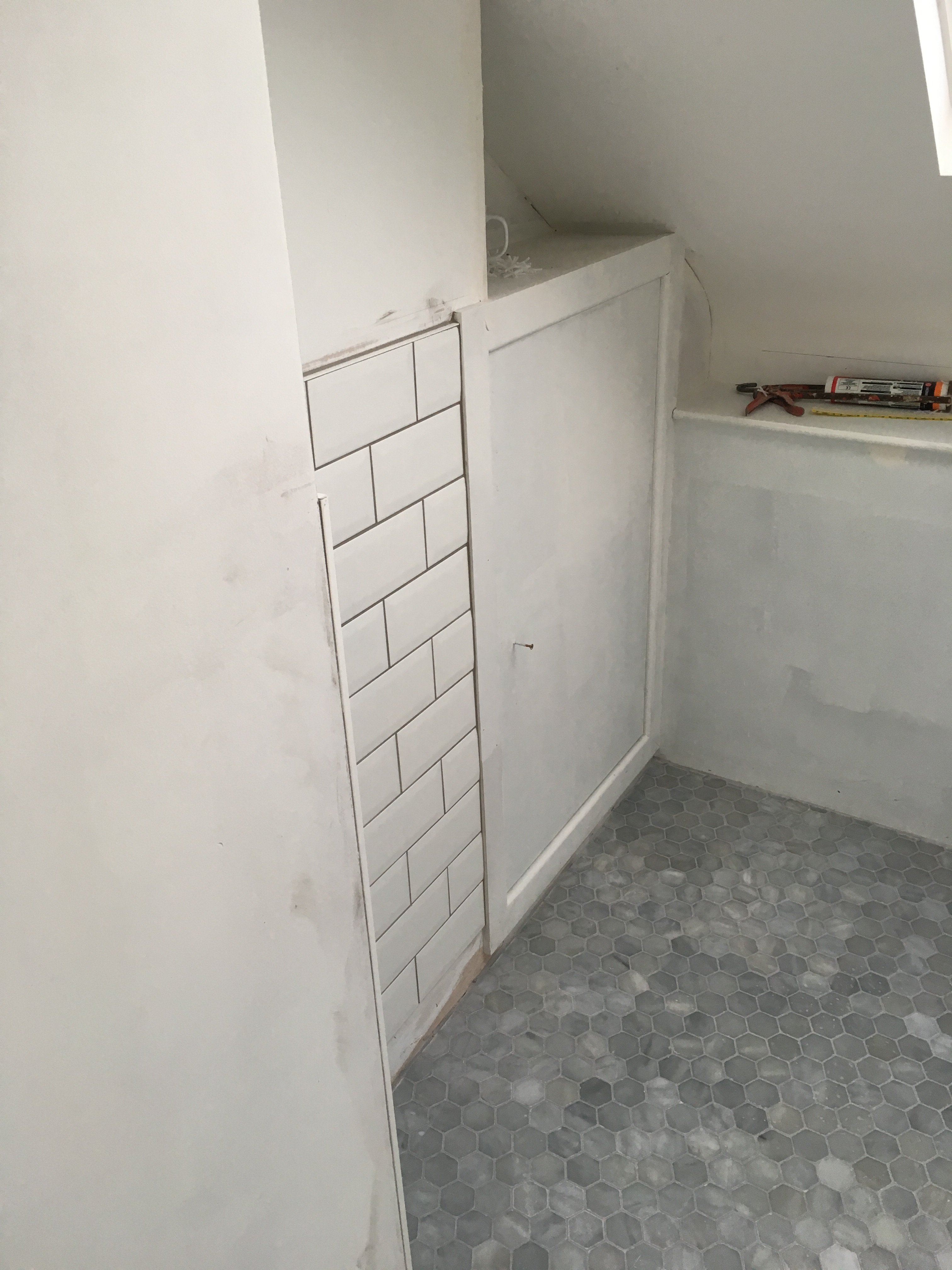

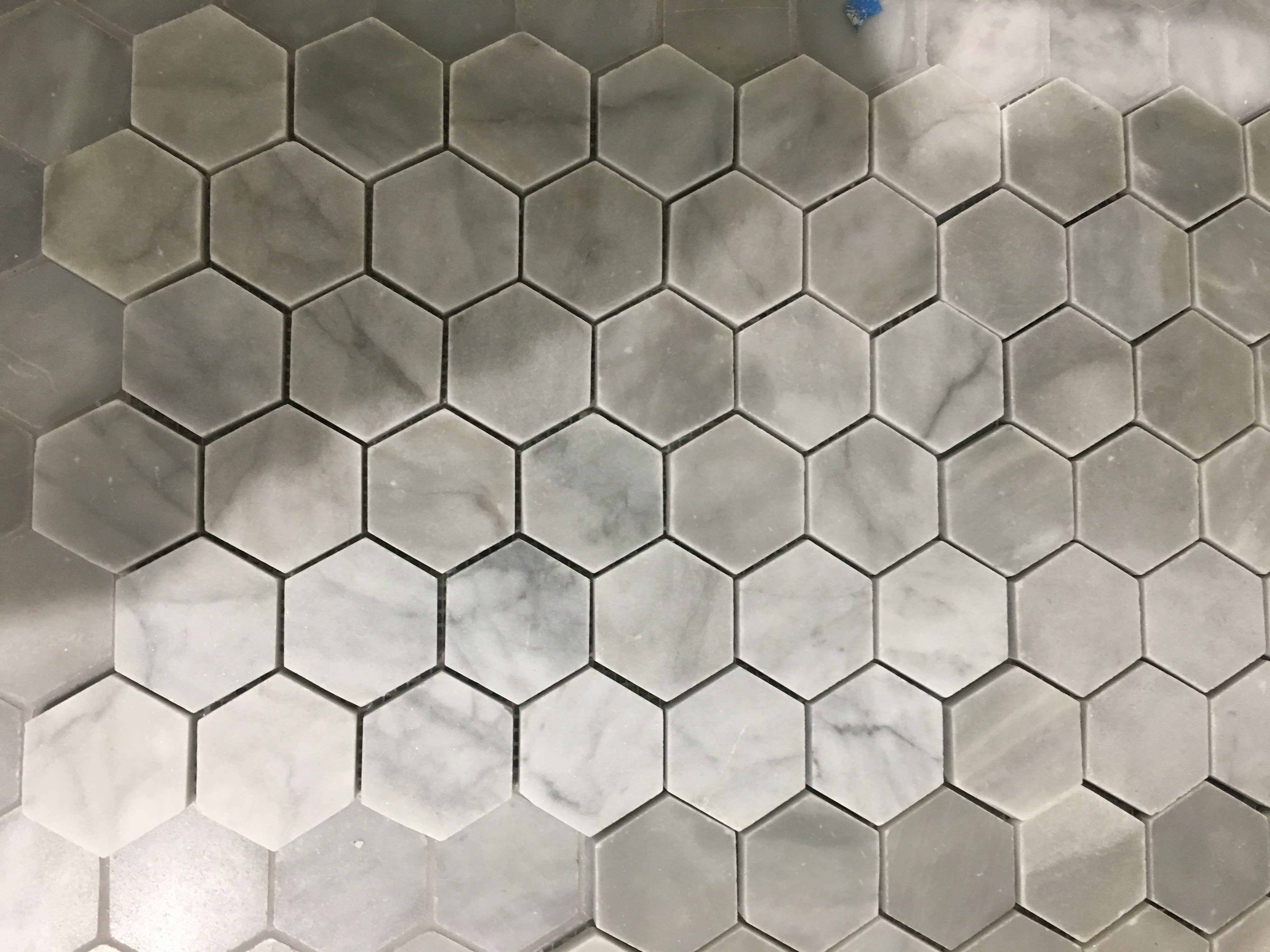

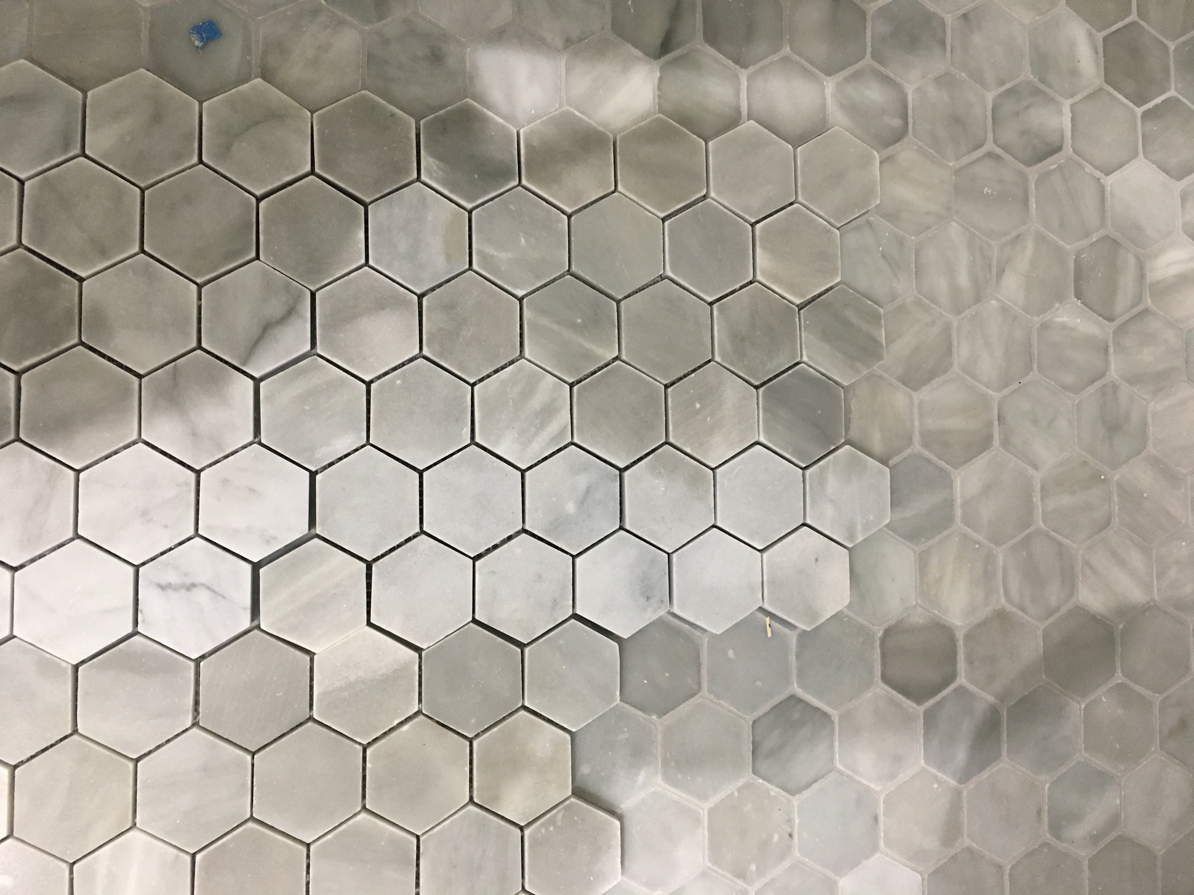

Is this ok? Natural stone floor not level after tiling
As well as the adhesive moisture ,we have the latex moisture to release through the tile to.
I would stripp a section, we have a product wax off. If you or fitter want to discuss the runthrough in morning , give me a call on our tech line

The tiles are fired earth bridghampton and the job was "finished" 8 days ago. I've held back a third of the money we agreed, but still he isn't cheap! We were recommended this guy as we wanted a top quality job, doesn't seem like we've got one at the moment. He also retiled our other bathroom, ceramic tiles over the current floor tiles I think that looks ok. Ceramic tiles though probably an easier job
Despite all the excellent advice, you don't want to be doing anything to this floor yourself!
Get back to whoever recommended this tiler and ( if it was Fired Earth) get them to have a look at it.
He could have already ruined your tiles but if you try to undo his mess he will just walk away with two thirds of your money and you'll have no recourse to pursue a claim.
So it's your Dads fault - for putting the floor in out of level and recommending a tiler out of his depth.
Us Dads get all the blame and we're only trying to help.

Hi all just had a very useful chat with @Lithofin BOB and sent some pics to the fired earth technical team. Hopefully can be sorted
I was wondering about the toilet, the pan is not level due to the floor. My dad thought maybe use rapid set but then was told could stain the marble tiles. Any ideas?
