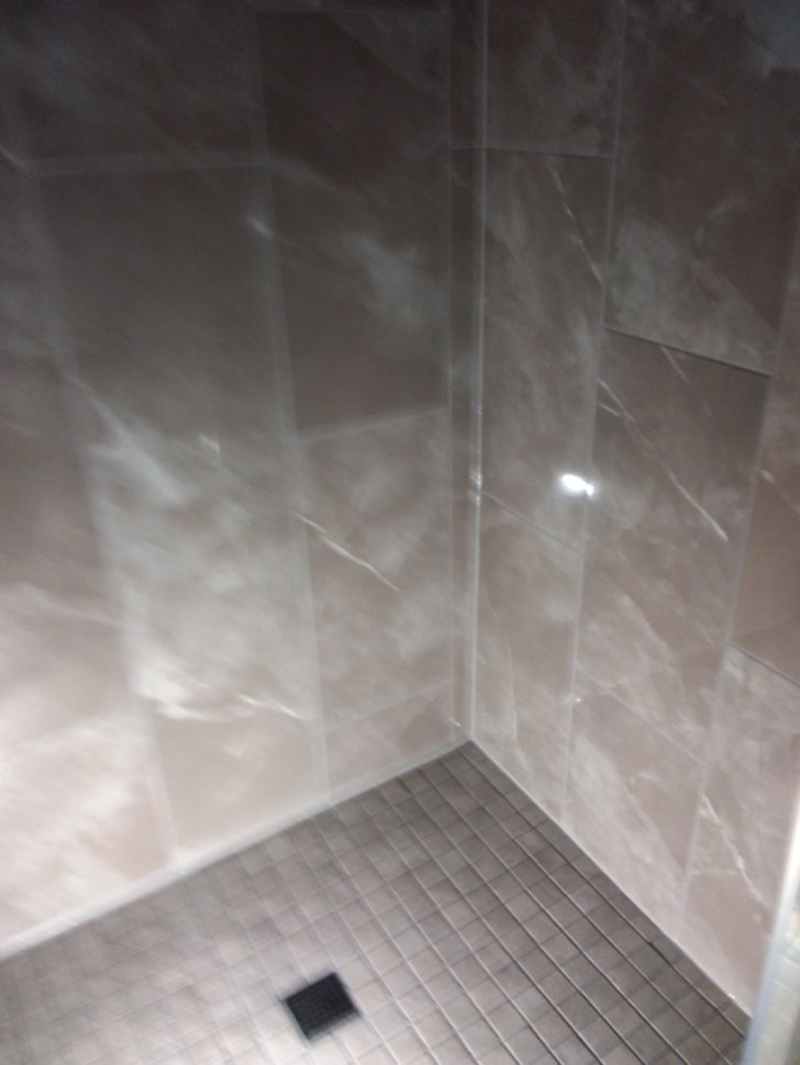

I'm starting!!! This will be my first attempt at preparing and tiling a small stall. It's my own place that's sitting there not being used so I started to fix it up on my spare time. Our local code does not require the types of testing you mention though I would like to try it anyways. It's not the tanking i'm concerned about, it's trying to make the tile look nice.
I'm done. I redguarded the durock, and got to work. The floor with 2x2s came out perfect, but I'm not too proud of the walls. The first tile I set was 1/2 inch off the center of the back wall, then I continued straight up to the ceiling and went to lunch. Came back 30 minutes later and noticed it. I can't believe I screwed up the math. I'll try to add some photos so you all can point out the mistakes.....already told the boss to find a tiler for his shower, though I would never make that mistake again. It's just too much work for what he pays me.
Here are some pictures. Go ahead fire away, I need to learn. I. Threw in an outdoor pic just to show the house. 20191203_131125.jpg20191203_131336.jpg20191203_131226.jpg
