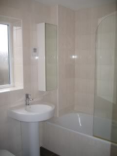

Trying to get this one done in 7 days which means I can rest up a bit before the next one. I feel broken.
Usual thing of gutting and ripping out.
Only 3 walls to tile and for the first time I'm using 6mm ceramics (1st time since tiler school anyway) Only ever had porc + natural stone jobs. Can't believe how fast they are to work with.
Nice Pacific Blue suite:
Finished the day making new framework for shelf:
Wish all baths had such deep wooden frames - makes a tilers job a lot easier!
