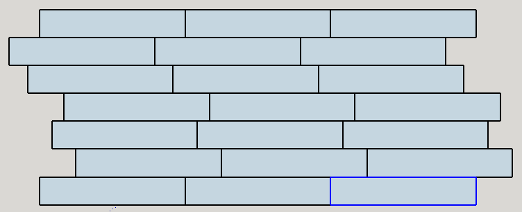

Can you draw me a diagram of a short random bond Paul please, don't quite follow.

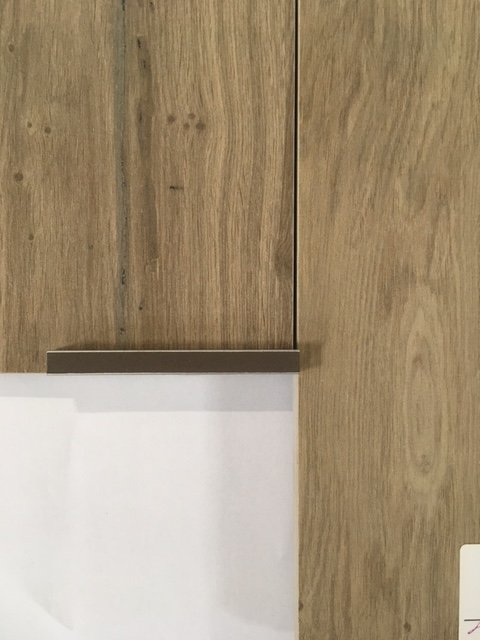

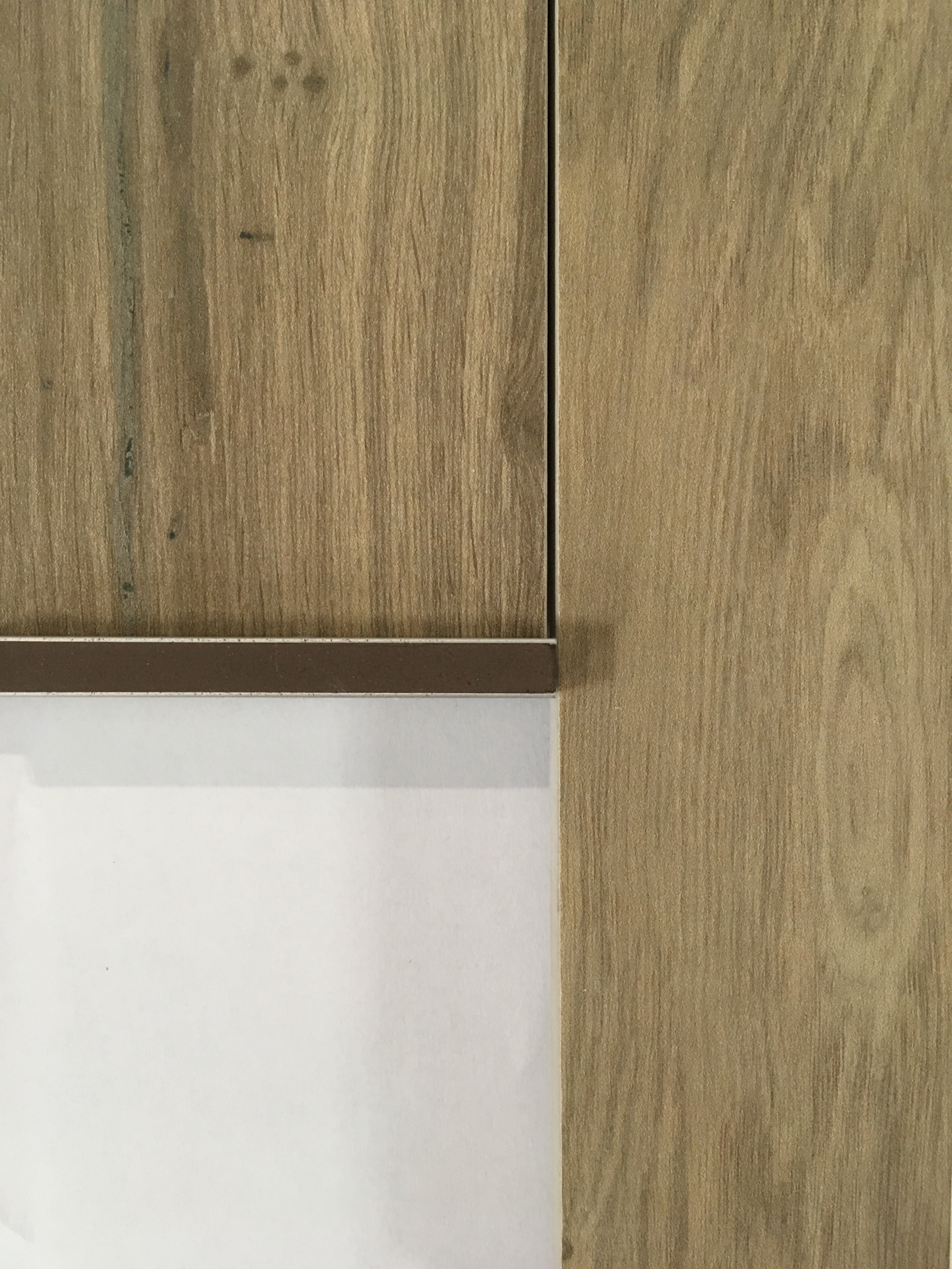

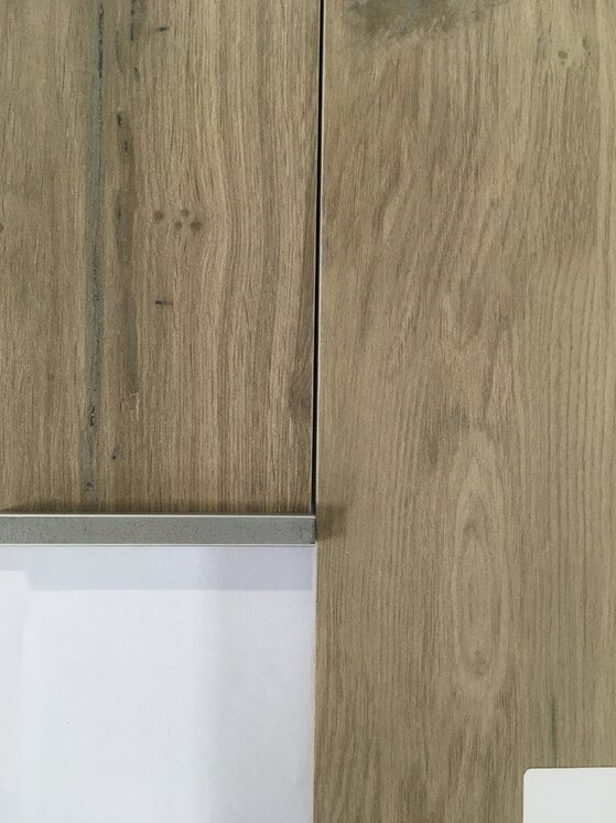

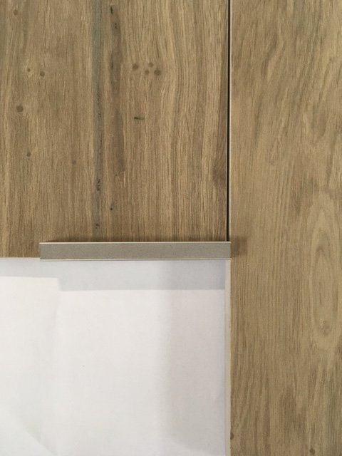

Obviously it's personal choice, for me, I'd go for a darker contrast.
Reasons being that with a darker colour it won't as a rule change colour with wear,tear and washing.
Also if you look at the average timber floor,there is a noticeable joint between the planks, which in a lot of cases appears very dark.
If you have a lighter colour it instantly looks like tiles.
In this, the tile is 1200x230. The stagger is random between 100 and 300mm (quarter). You could go longer if the tile is flat enough. but this is my preferred layout.
