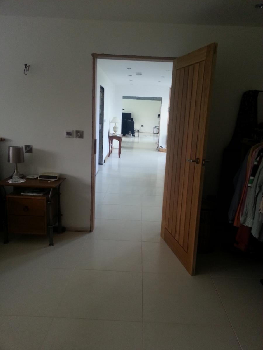

3 options , loads if rugs, retile (obviously out of the question , and you have less chance than a snowball in a coal fire than getting money out of the builder, even if you could he would most probably go bankrupt 1st rather than pay up) or fill the cracks , and live with it [emoji22]look on the bright side it will have the 'lived in look' [emoji41]
The problem you will have is they will open up again , the heating HAS to be turned on before any tiling as it will move with expansion and contraction [emoji22] and limestone is a soft arse stone

So, in your opinion, you think to create expansion joints restrospectively across doorways etc would give a better chance of no more cracks than simply filling in the existing cracks with something flexible. I do appreciate the chance of no more cracks is slim whatever we do!

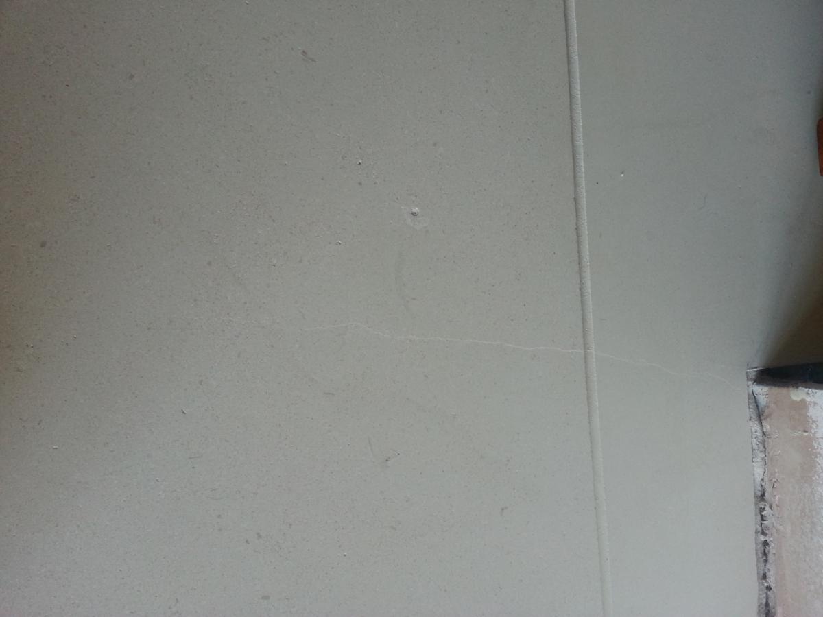

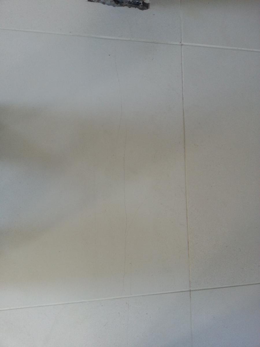

You say you filled the cracks for your friend but they got worse. My question, which nobody has answered directly is... should we could we do the same OR does just filling them risk more cracking than we would get if we retrospectively created as many expansion joints as we can in suitable locations - down the middle of the main room & across thresholds etc? Won't hold you to it obviously - appreciate it's not an exact science & nobody can really say what will or might happen!!
Here's some more pics
