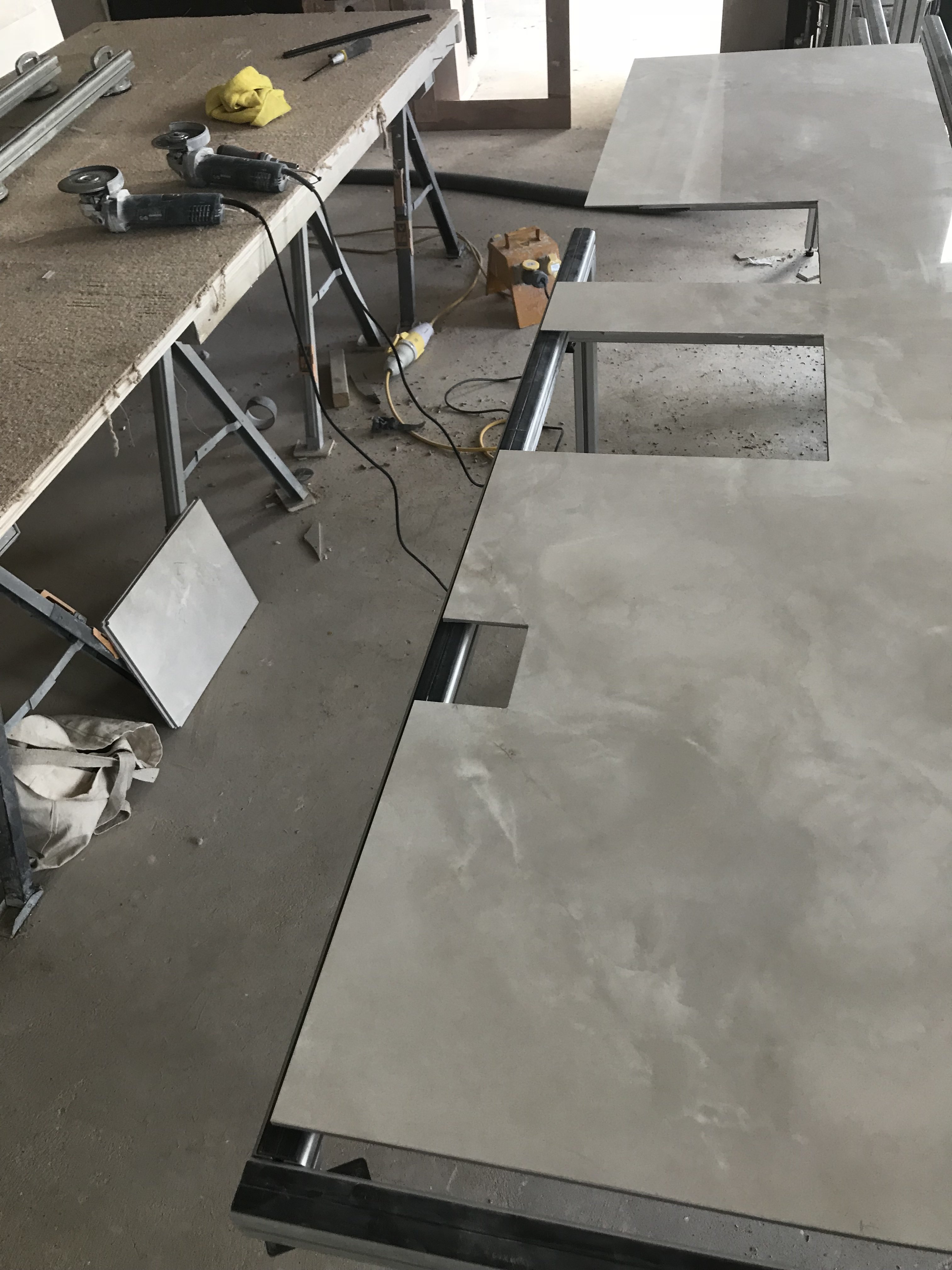

This is my second table that’s used when I need two set ups.
It’s made up with two toughbuilt C700’s & two C500’s, but they’re far too low for you.
C 700’s are height adjustable, C 500’s not
I just put two 12mm sheets on screwed together, very stable. Carpet takes out vibration and you can cut flat on table in to carpet which is sacrificial.
So there’s no need to overhang the tile when doing cut outs for niches whatever.
View attachment 97506 View attachment 97507
Yore gonna need a lorry soon the way you’re going Marc.
Might not be far from the truth there mate haha but when there’s two of you and a lot to do, waiting for a table to come clear is both a waste of time and damn irritating haha
I’ve no doubt about the amount of kit you need to turn out the work you do but bloody hell theres a lot of it 🙂
When everything is assembled, yeah there is mate, but everything I have can actually all be broken down small enough to fit in bags or tubes, except a full sheet of ply 🙂 but invariably I get the Builder to provide that, I used to take my own, now I just tell them it’s a requirement.

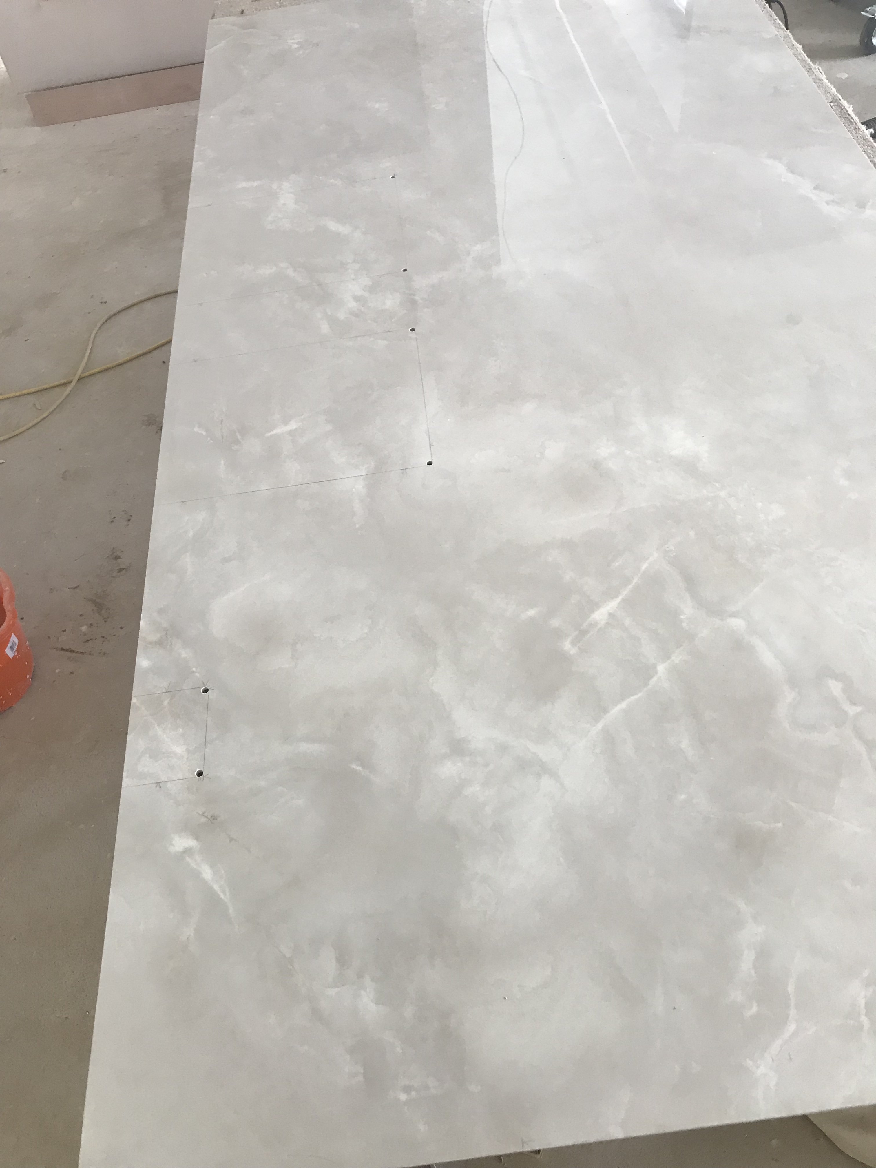

Here’s a quick series of images of prepping a tile for half of a double niche.
First one marking out and drilling corners.
Then cutting out niches.
Then reducing in size.
Fitting a frame to move it over to my main table to mitre all the niche areas.
