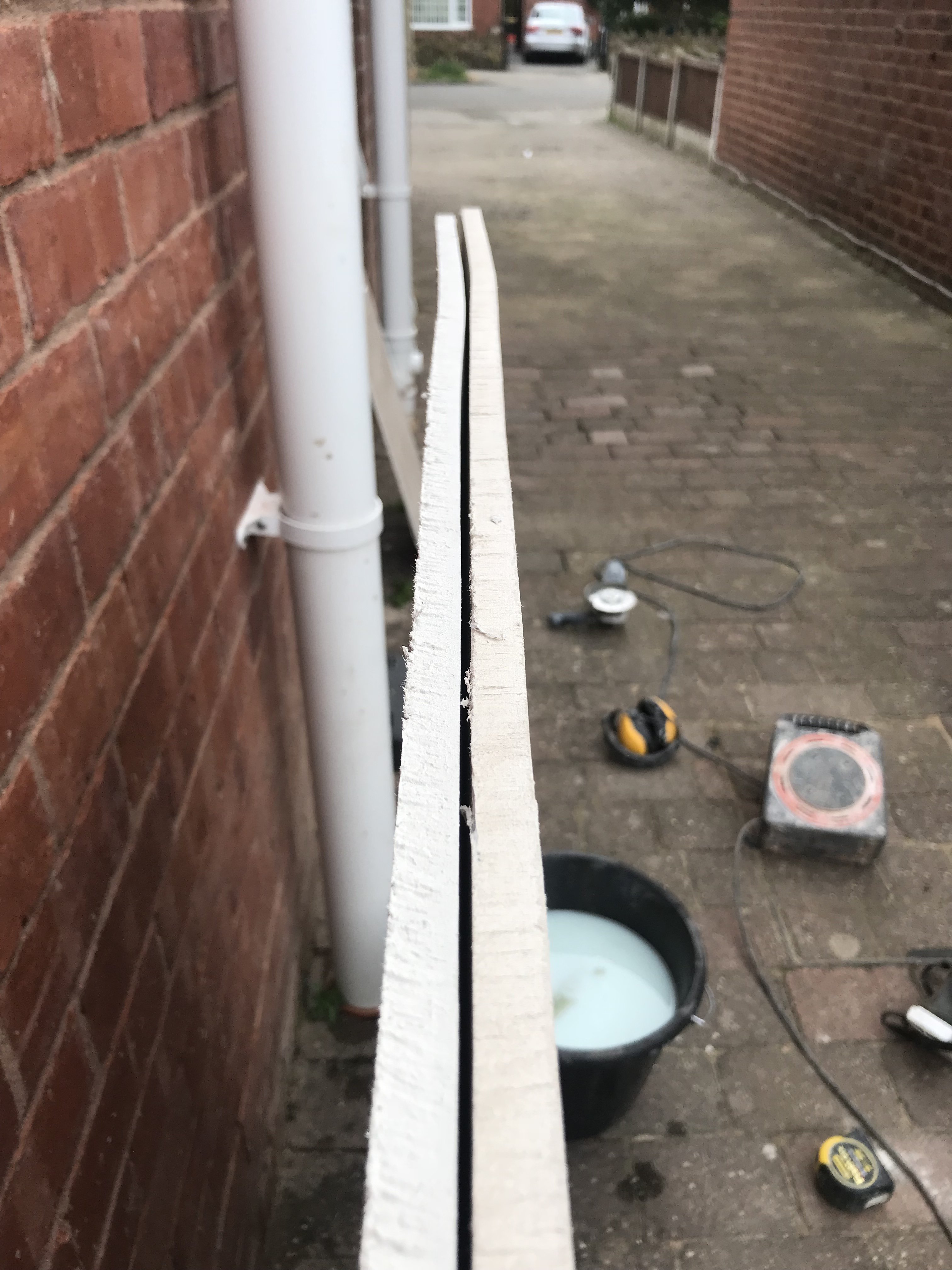

A grinder will always be the fastest way, 12mm is tough but also the only board in the UK that can span 600mm centres without the joints bracing
