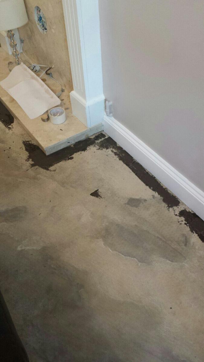

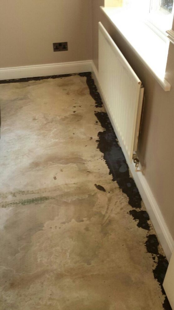

Jobs my own living room. Ripped up carpet and grippers leaving the screed with small holes and a little crumbling around the room edges from taking up the grippers.
Knocked up an SBR slurry mix and then when tacky applied some addy to fill the holes. Be alright won't it?? Lol ;)
Floor is level, not too worried as I have a 4mm foam underlay mat and 10mm laminate going down.
First img is slurry, second img with addy.
