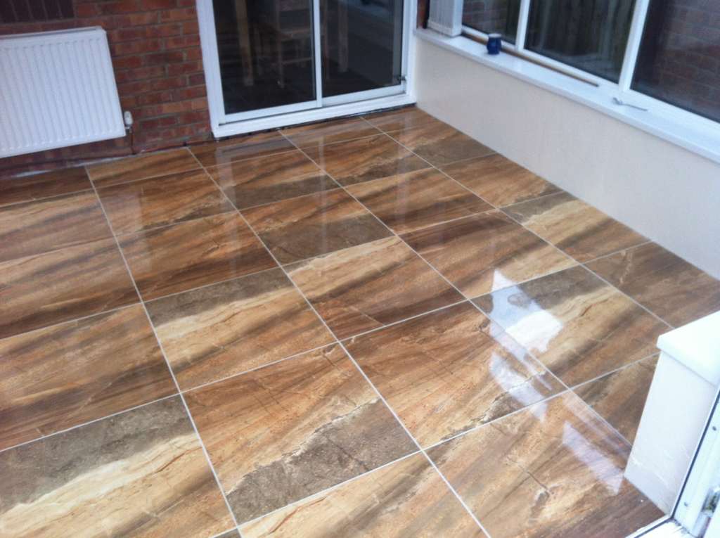

Just finished this today , thought the snow was gunna prevent me getting there. Lol.
nice work Dave, what tile is that?

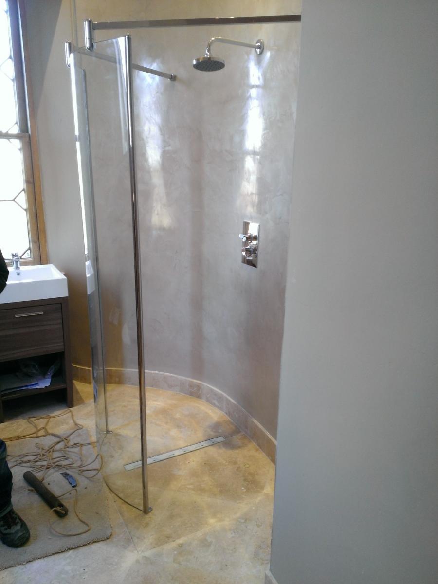

Venetian Marble wet room done last week. 2 coats carara (grainy marble), 5 coats clasico (Very fine marble)

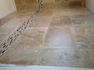

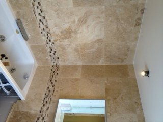

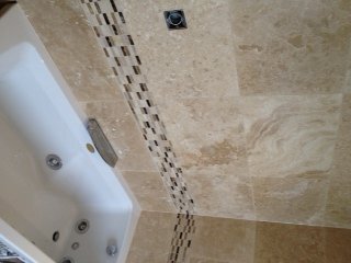

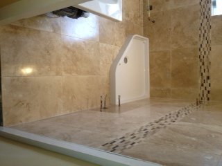

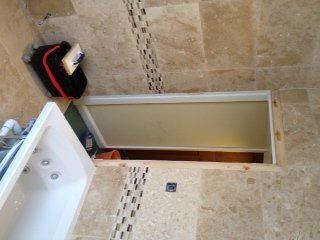

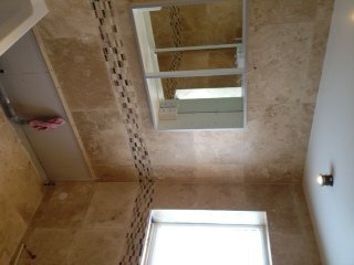

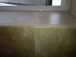

600x400 travertine bathroom finished yesterday. Thanks to the guys on the stone forum regarding what sealer to use. Opted for Ltp colour enhancer and stainstop. Customer initially wanted a polished look but advised against and they are thrilled with the results. Will hopefully be able to get back once finished.
Setting out vertically was dictated by the customers insistence on the position of the mosaics leaving small cuts top and bottom. I advised against trim around the window and butt jointed the tiles, filled with grout and took the edge off by hand with sandpaper.
Not the most experienced with Travertine so all comments welcome.

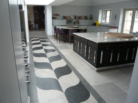

P1090689.JPGthis is a picture of the kitchen completely finished on a job i entered for april 2012 JOTM.
Stone fixed vix blue limestone
this picture taken many months later than when we completed our work.
kitchen smallbone of devizes.
