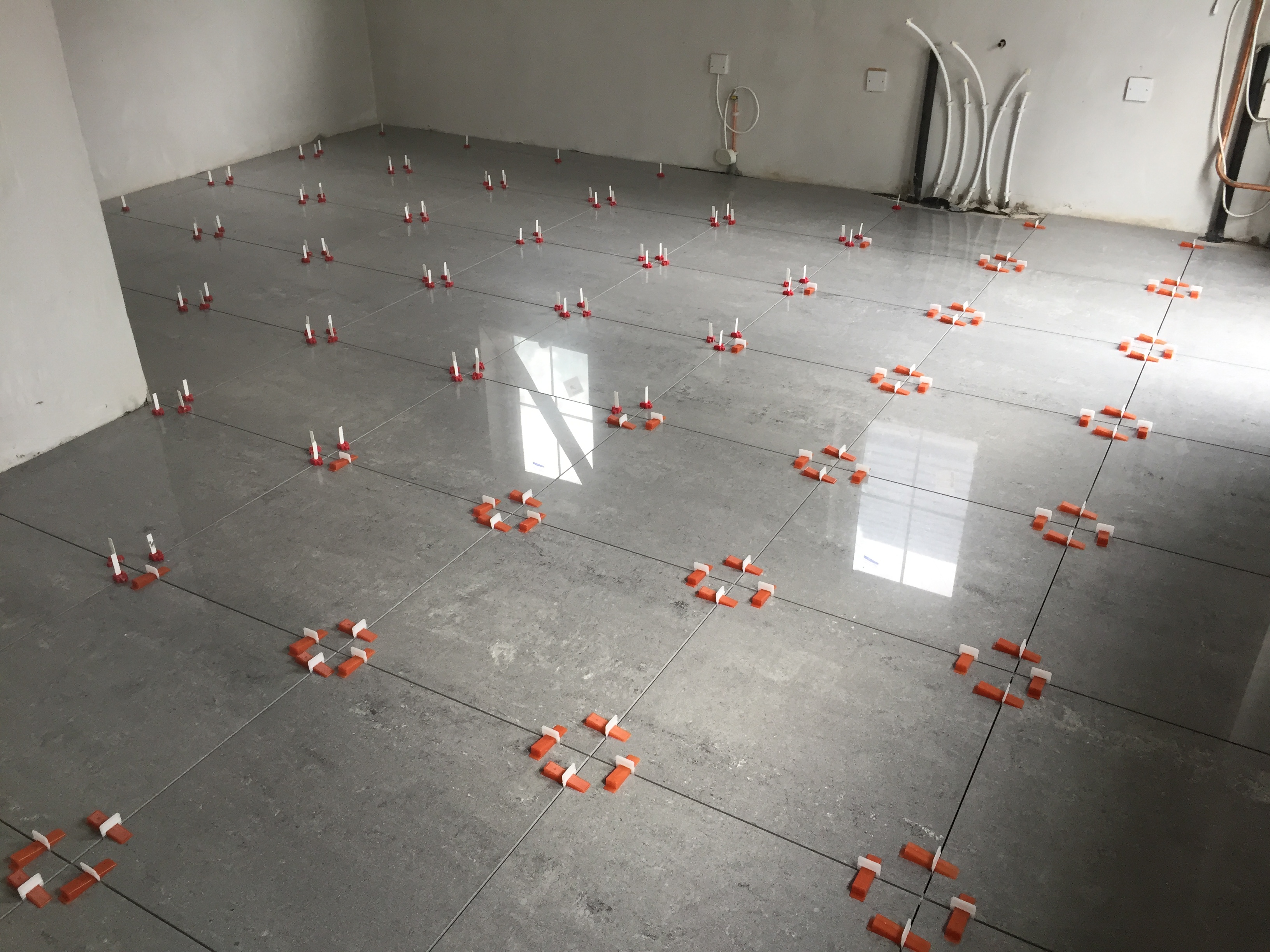

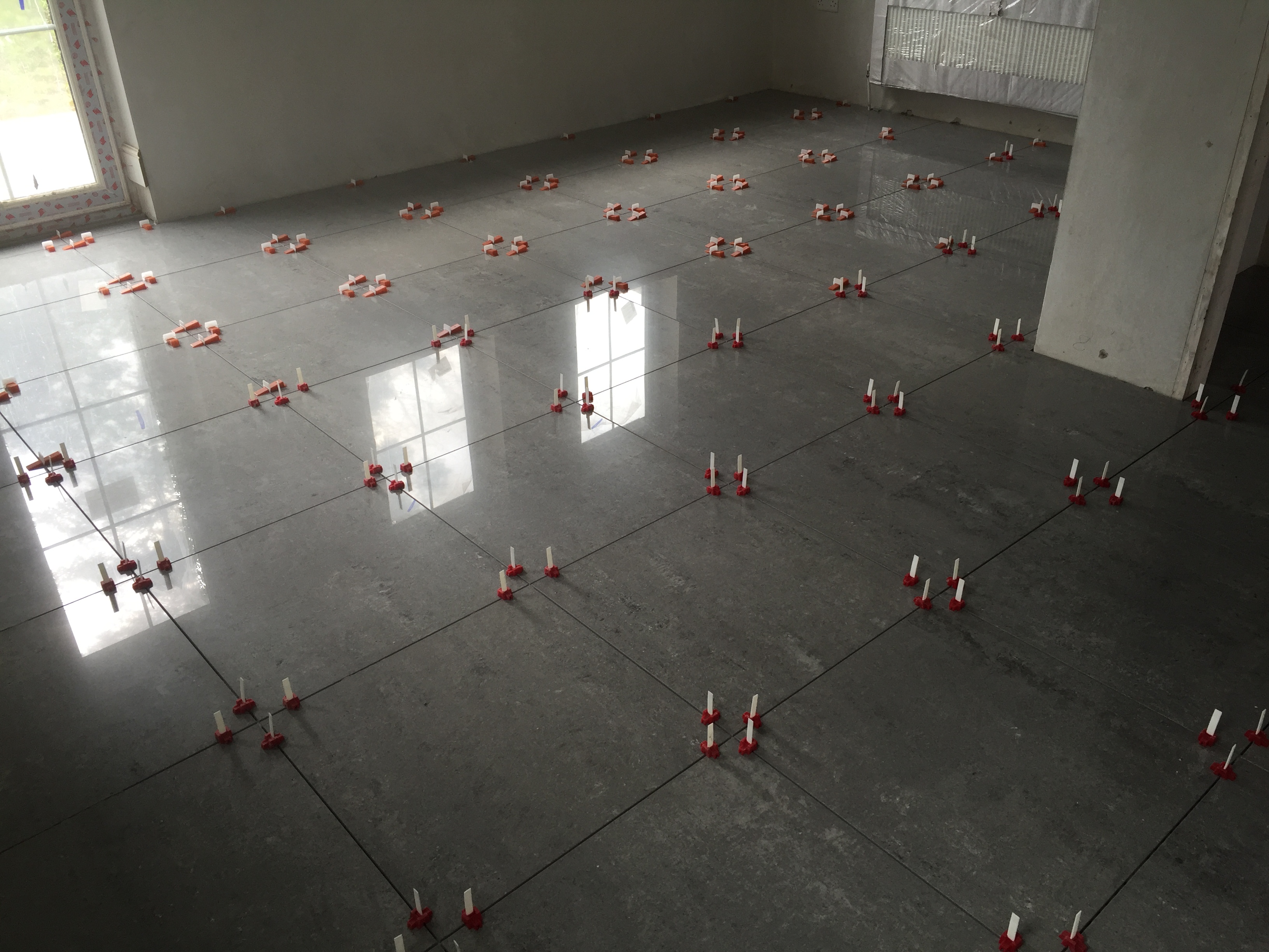

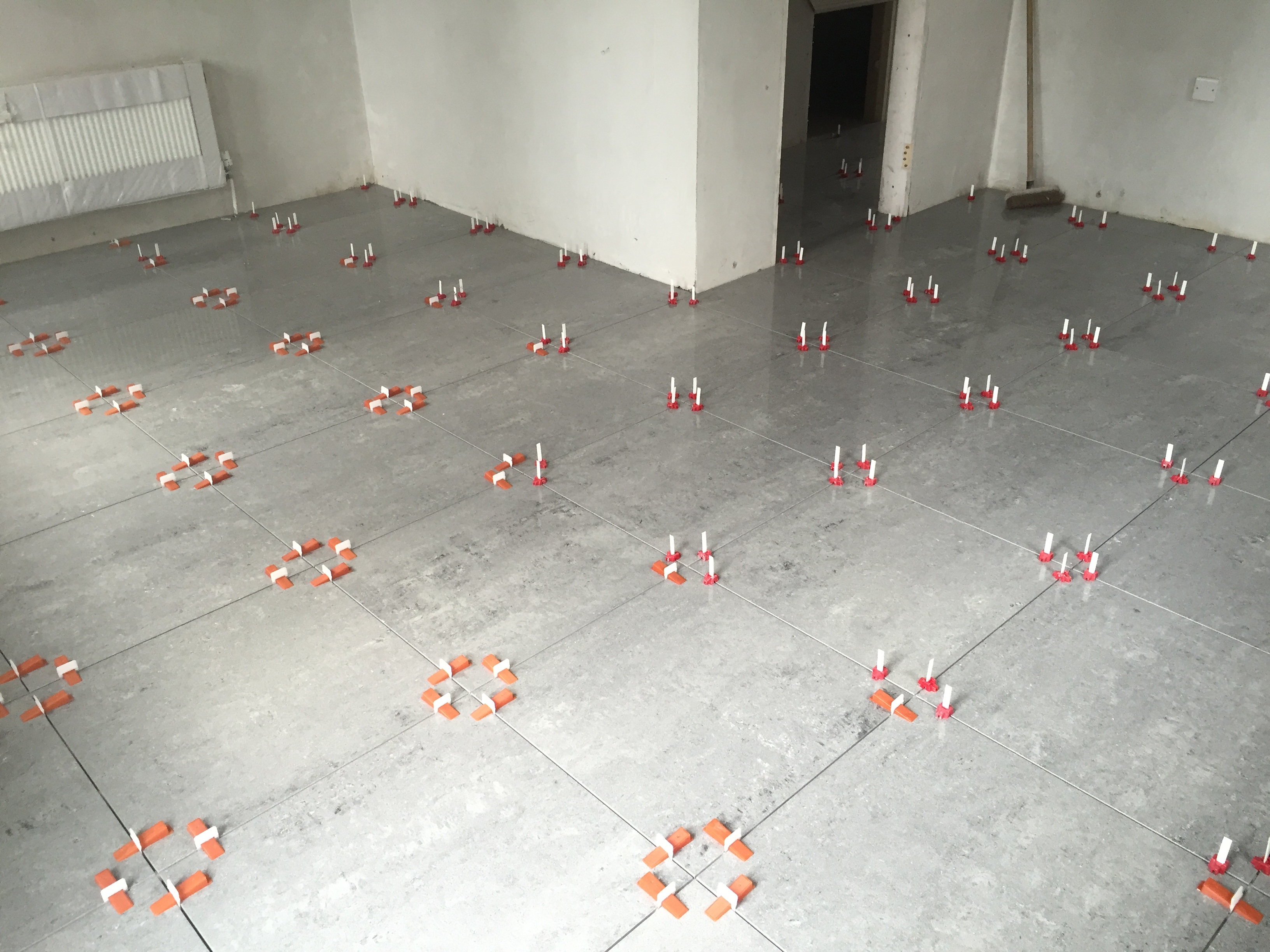

I'll post a pic of a floor I did using the RLS and the Genesis system together to see how the preformed in exactly the same conditions and tiles.
