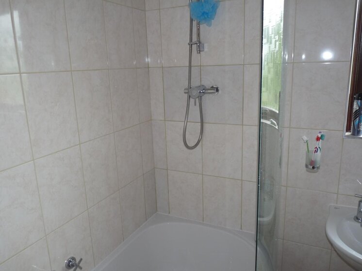

OK just a guess here, is it possible that these tiles are from a different batch? Were the codes checked? Do you remember the order of fixing them? did you place the tiles where the shower mixer is as you went? or left them till the end?
As I say this is just a guess, but is it not possible that the tiles have always been a different colour (if from different batches) and that it was not noticed at the time of installation, as when they were fixed to the wall the wet adhesive made the all the tiles appear uniform in colour but as they have dried they have returned to there original colours?
just a guess???
Also, the tiles in question are the ones most at risk from getting water behind them. shower tails cut through the two full tiles and the two at in the corner which is where water will pool, it also looks like it is traveling up the wall in the corner. But you say they are bone dry so confused :confused:

Hi mate, can't help, but have seen the same problem with cheap tiles, I helped a friend by tiling his bathroom a couple of years ago. He had bought some cheap tiles from Focus, I thought the same as you that it was water getting behind the tile somehow, but have not been able to check it out as he lives a good distance away. The problem he has extends beyond the normal wet areas, but as he lets the walls get and stay very wet from condensation by not using the extractor fan, I still assumed water. Last time I was there for a quick visit. it looked like a chess board. Like you describe, the problem developed over time, there was no sign of it when it was first tiled. Be interested to see if others have seen the problem.

I think tomorrow I will remove one of the tiles and check if there is any moisture behind
