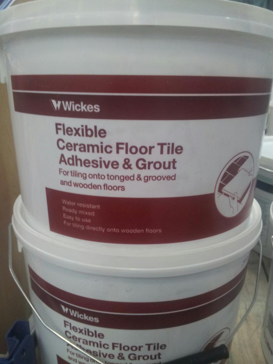

this is what we are up against

at the end of the day by tiling the floor you are accepting that the substrate is suitable for tiling, so if it goes wrong its down to you and you alone that's why i feel most tilers would walk away
hmmmm, i think i see your point......just....... you don't like wickes. a reputable company.
meanwhile, bal is the only product i've used and so far it's been faultless. bal fast flex and wide joint micro bio gout.....well worth the extra cost and time to mix.
on some wickes tile boxes there is a handy tip, it says why not tile over your existing tiles to save time :mad2:
bottom line is there is some very bad advice being given out by so called reputable company's these guys on here will give you the best advice available

And no Wick's adhesive is awful, there is no one here that would say it is reputable, it seems reputable means it sells a lot, or our staff can recognise the word 'wood' on it. Stick with Bal or Mapei.
Let me tell you about Wickes, B&Q adhesives, they are bought off the major producers but are down graded so they sell cheap.
Bal are an expensive adhesive and there many products that will do the job far cheaper but your've got to be in the trade to know where to buy.
