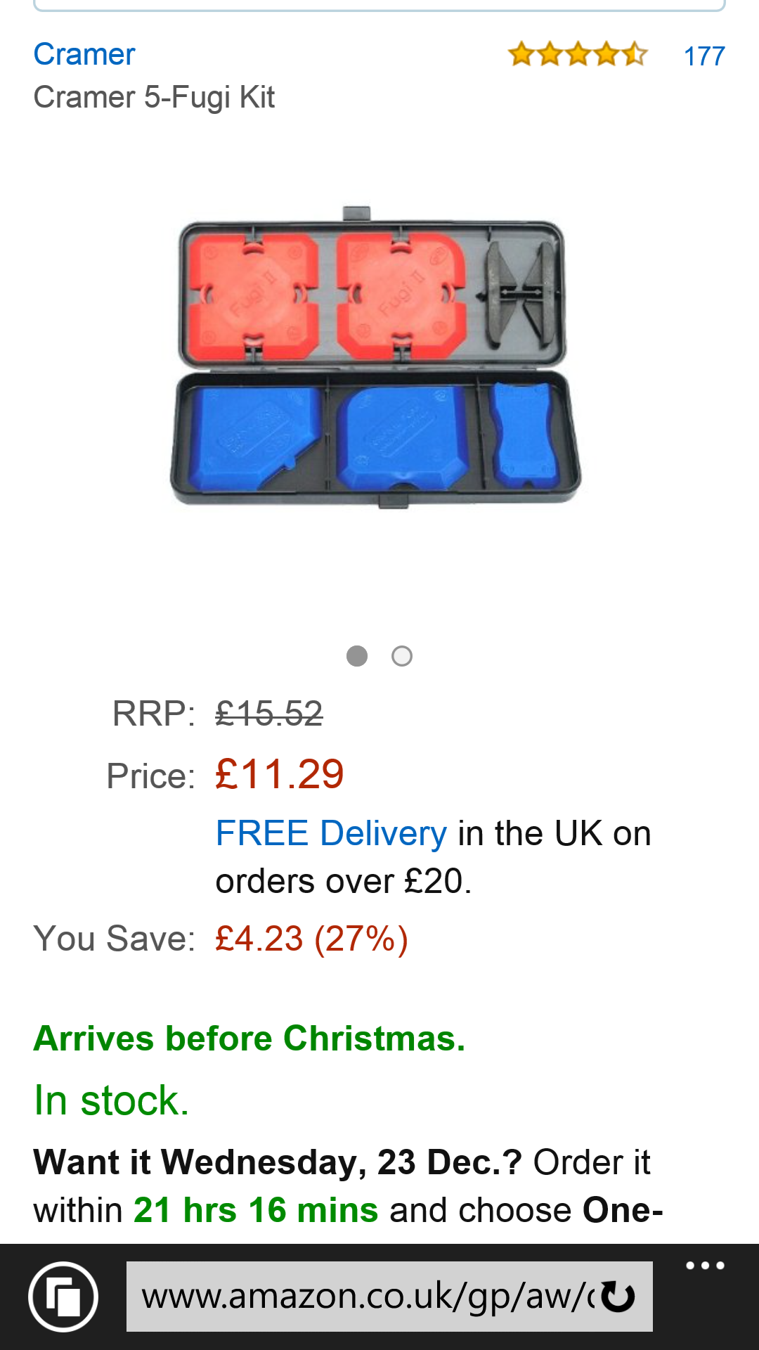

Leave it for the plumber to do round the bath.....So, those of you who use a profiling tool (I do too), what about behind bath/basin taps when you can barely even get the silicone nozzle down there?
