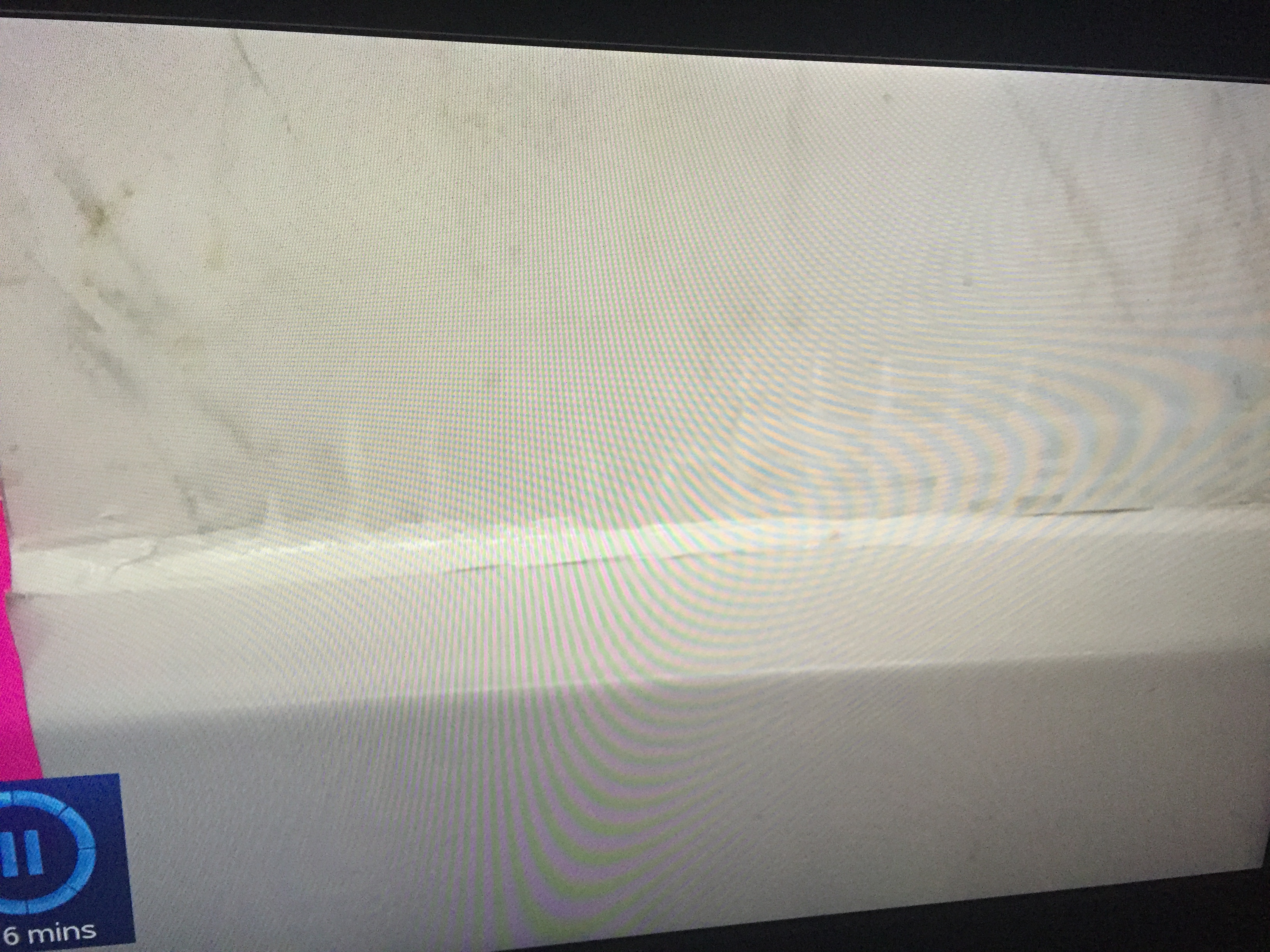

Whilst on this subject, this was the result of a plumber "teaching" someone how to apply and finish Silicon around a bath on cowboy builders...
