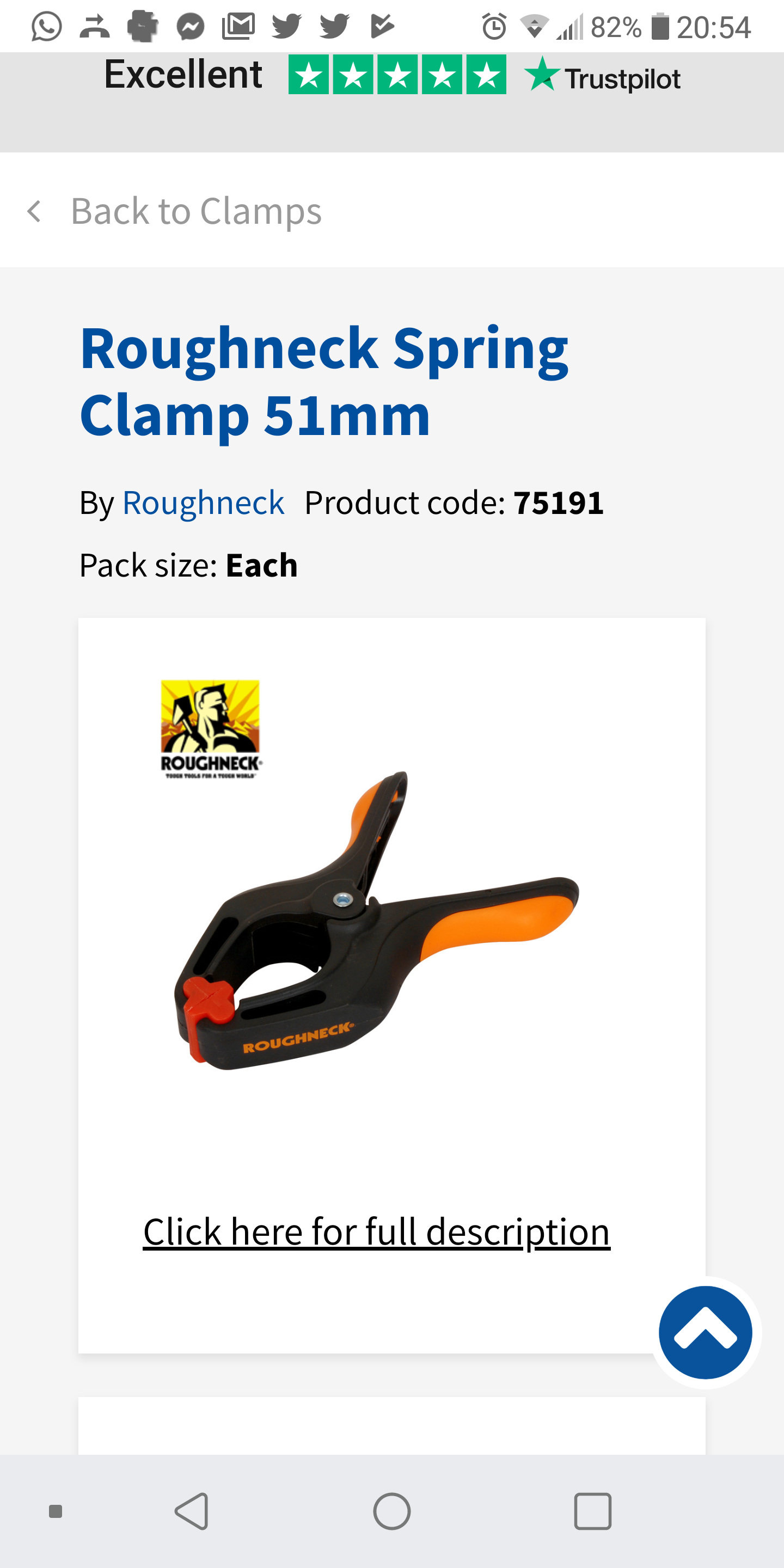

Thanks for all the replys. How are you clamping the tiles to the work bench, what clamps you using?
