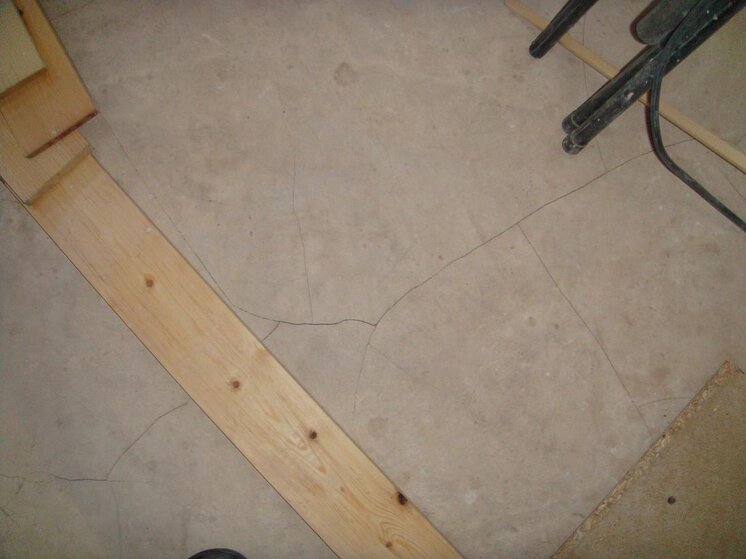

Update:
The builder who was here today has said the top layer - the levelling layer - is to be taken off as it wasn't applied properly. does this solve the problem? What should I watch out for? When should the tiler start?
Thank you for reading this and the supportive replies I have had.

Right..you can tell by the photo that it looks like leveller.....If he takes that badly cracked one up and re-levells with a suitable one for ufh then it should be fine...

ask the builder how thick the screed is, it should be 60mm thick on a wet system ufh if its thinner this may be where you are getting problems with cracking ,wire mesh should be put in with an un bonded screed however some times fibre screed is ok ,the amount of cracking you have is unusual as it is such a small area, when the top coat comes off try crumbling the base between your fingers if you are able to do this insist he removes all the base coat and starts again as the original screed may have been mixed too dry or may not have enough cement in it ,
hope this helps
gary
