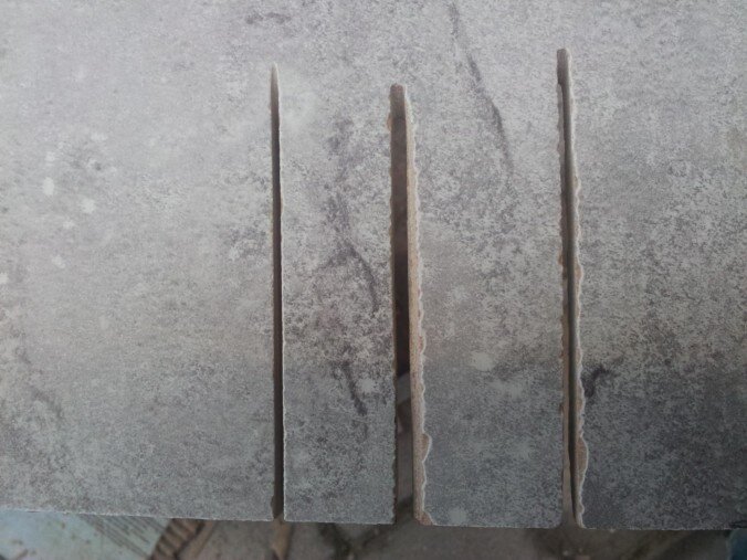

Angle grinder wheels
Spectrum SL Pro.
115mm at about £13 for one, less if you buy more.
Use for porcelain as it flies through it and good life.
Don't think they can be beaten imo.
Have a right lines blade on my small wet saw and it's brilliant. Ats diamond tools does premium blades for a tenner, night be worth looking him up. Supposedly they're just unbranded versions of good wheels.
After watching how good the ATS hole cutter performed on this test thread http://www.tilersforums.com/tiling-forum/61691-testing-thread-2.html#post632863 I will definitely not be put off by low cost options in the future - it out performed hole cutters costing way more.
Cutting discs, polishing pads items in ATS Diamond Tools store on eBay!
Hells teeth why would you cut a metal trim with a grinder :0
Screw fix do some decent blades, i always think the top end blades are a bit pricey
