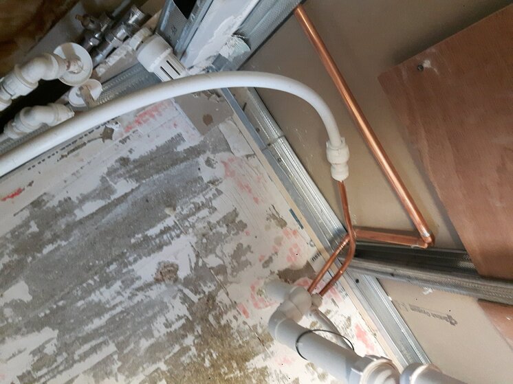

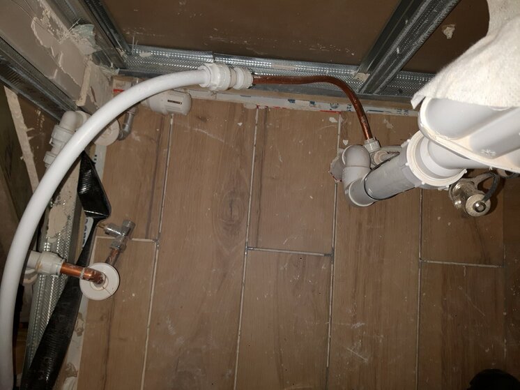

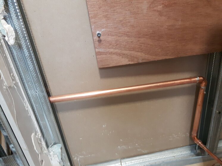

Thanks for the constructive feedback. I won't submit more photos to illustrate the cuts and grout lines unless there are requests! I think the main point now is something I ironically would not have picked up had the trader tried to negotiate or mediate and that is the addy and mat used. I have a quote for the materials for both floor and walls which takes me to the rocatex and BAL website for the specs if i copy and paste into google. Consequently, although not tiling related, the copper pipe that leads from basin was fitted by the tiler and is 10mm. Its feeding a mixer shower and from reading the specs on that, it needs to be a minimum of 15.

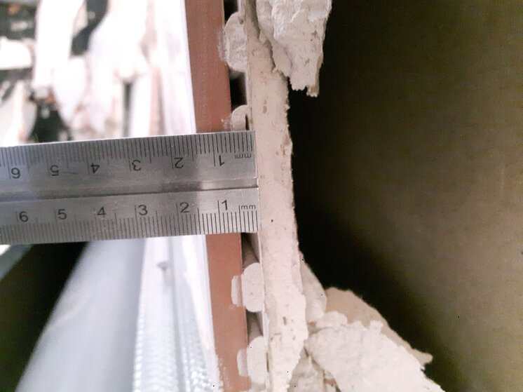

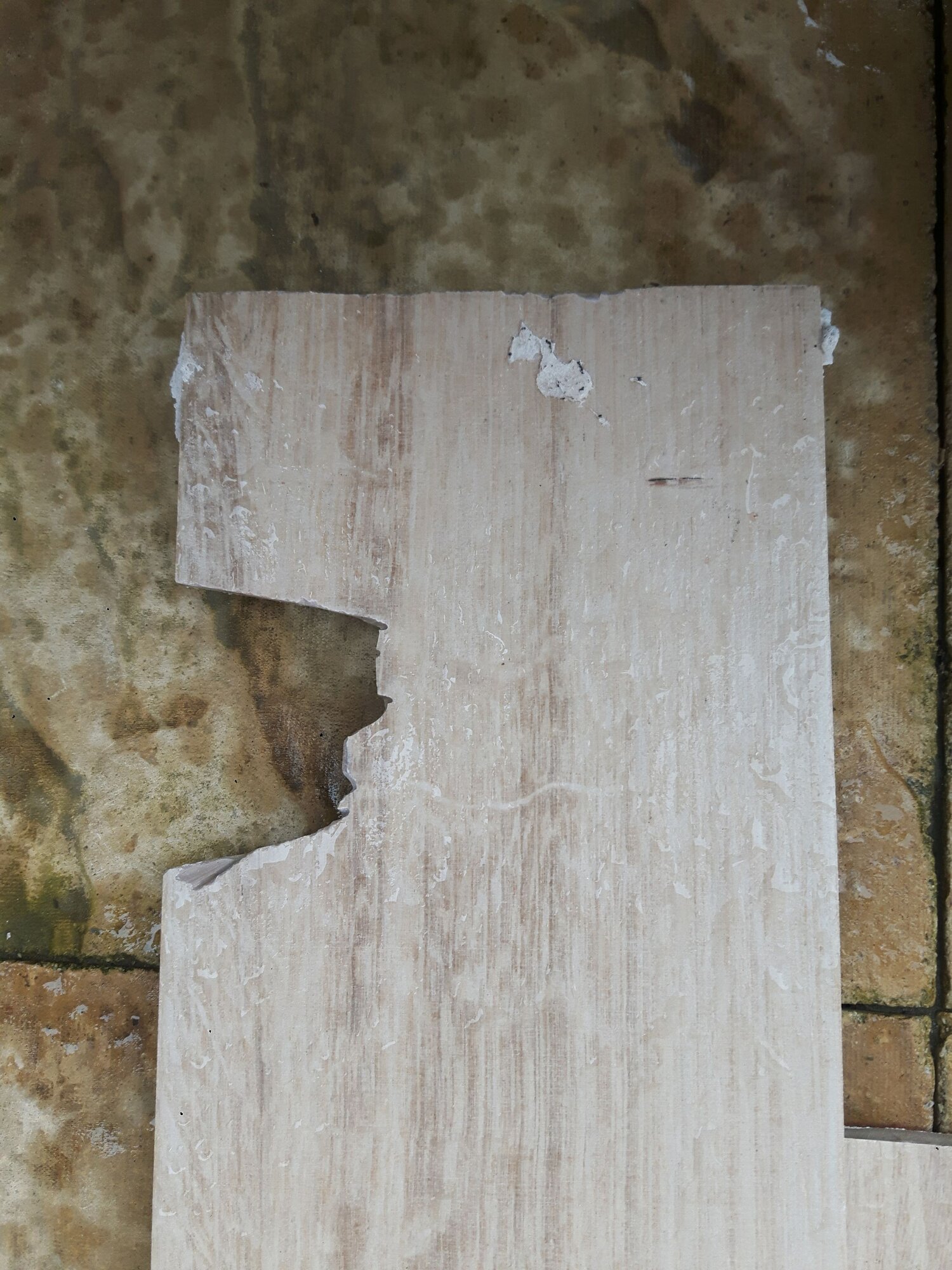

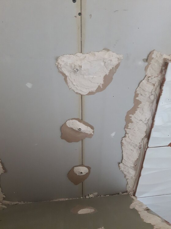

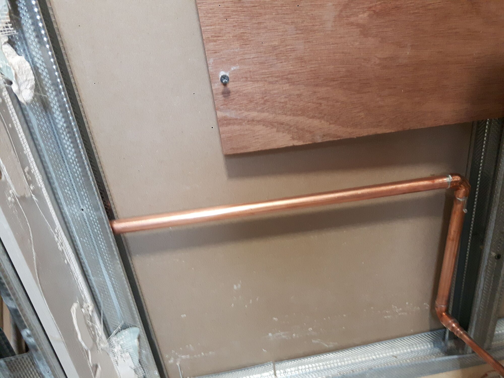

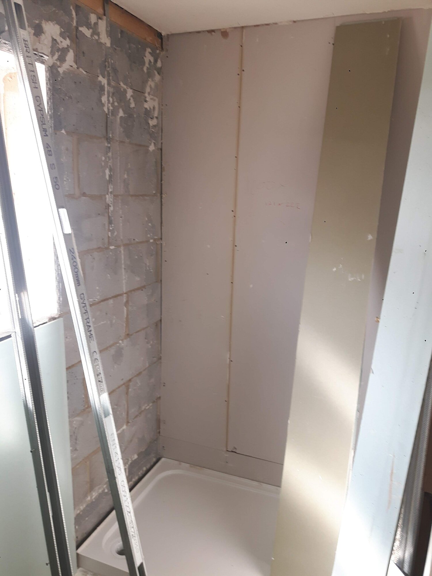

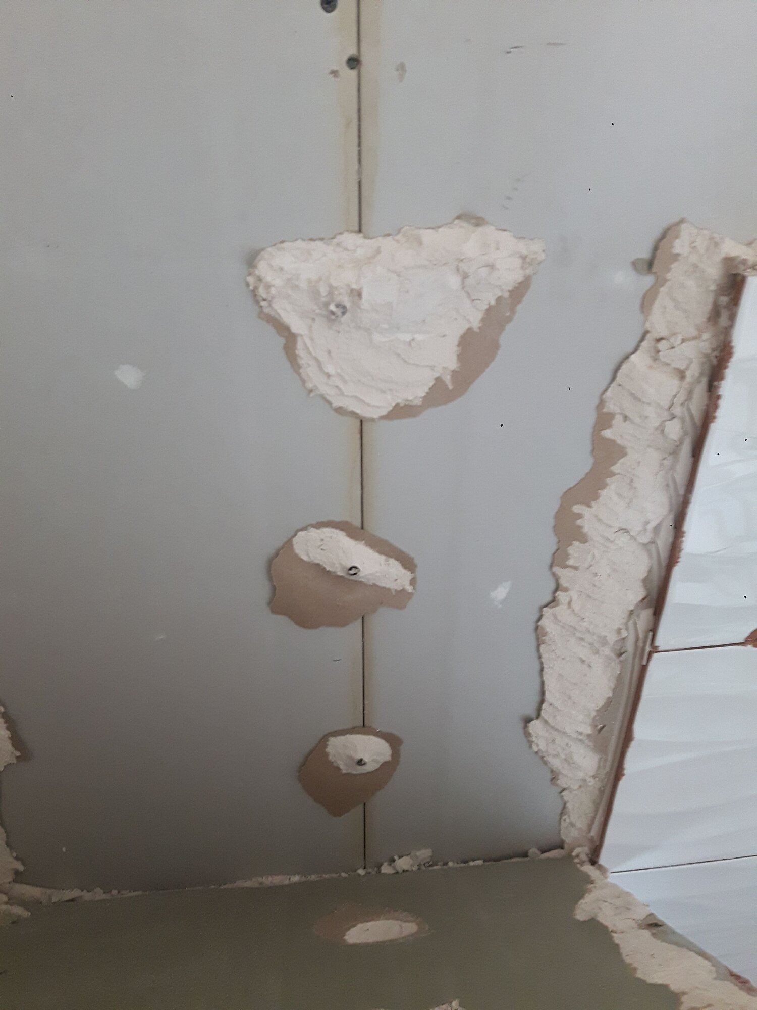

Just an update for anyone interested. I have taken the tiles off myself and the plumbing is now rectified (before and after pictures attached.) The external wall was dot and dab which was a chore to take off boards from. I did take a few pictures of areas of concern during removal of the tiles. Nothing too major, but my main concern was the tiles in shower compartment. The tiler had screwed gyroproc onto the plasterboard directly, which I understand is OK with regs. However, they screwed into the joint between the two boards, which is why I could just pull the tiles and board straight off the wall. Not good, when one of these tiles weighs about 4 kg. There are also areas where it looks like the adhesive was applied over the 3mm limit for premixed adhesive and hadn't appeared to set in places. I have plasterboard measured and ready to fit and will update after final decision with court and new tiles are on.
