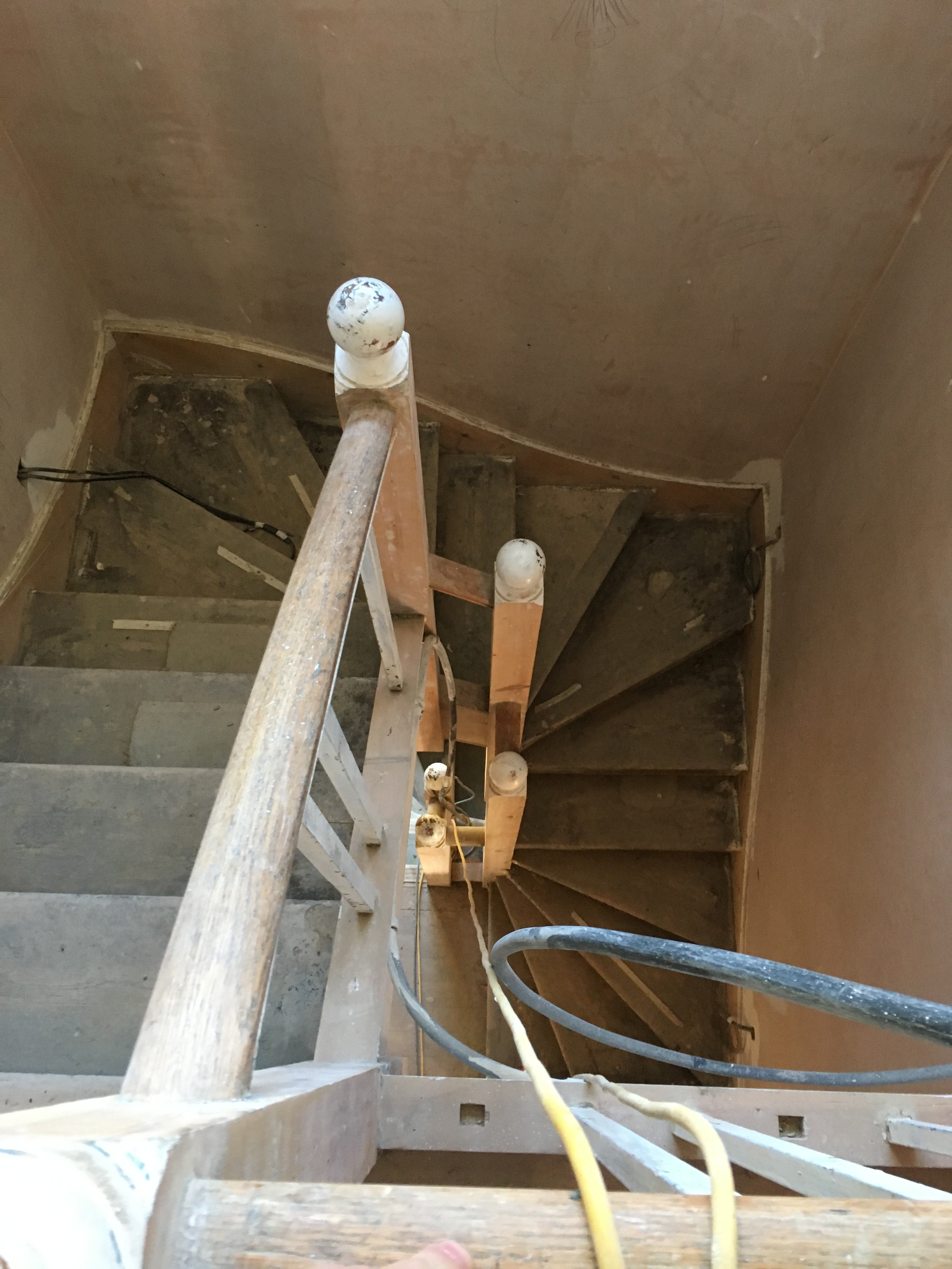

I've got some 3m x 1.5m next week.
All cut down to fit complete walls and floors in one piece.
Obviously cutting room is downstairs, then they've got to be transported up two floors to be fitted.
And this is a property in London. Not a big swanky purpose built house in a middle of a field with wide open spaces.
Staircase's are steep and narrow and so on.
Won't deny I'm a little apprehensive.
Wouldn't dream of moving stuff like that without frames and so on, it gives piece of mind.
But they've also got to be paid for, not bloody cheap.

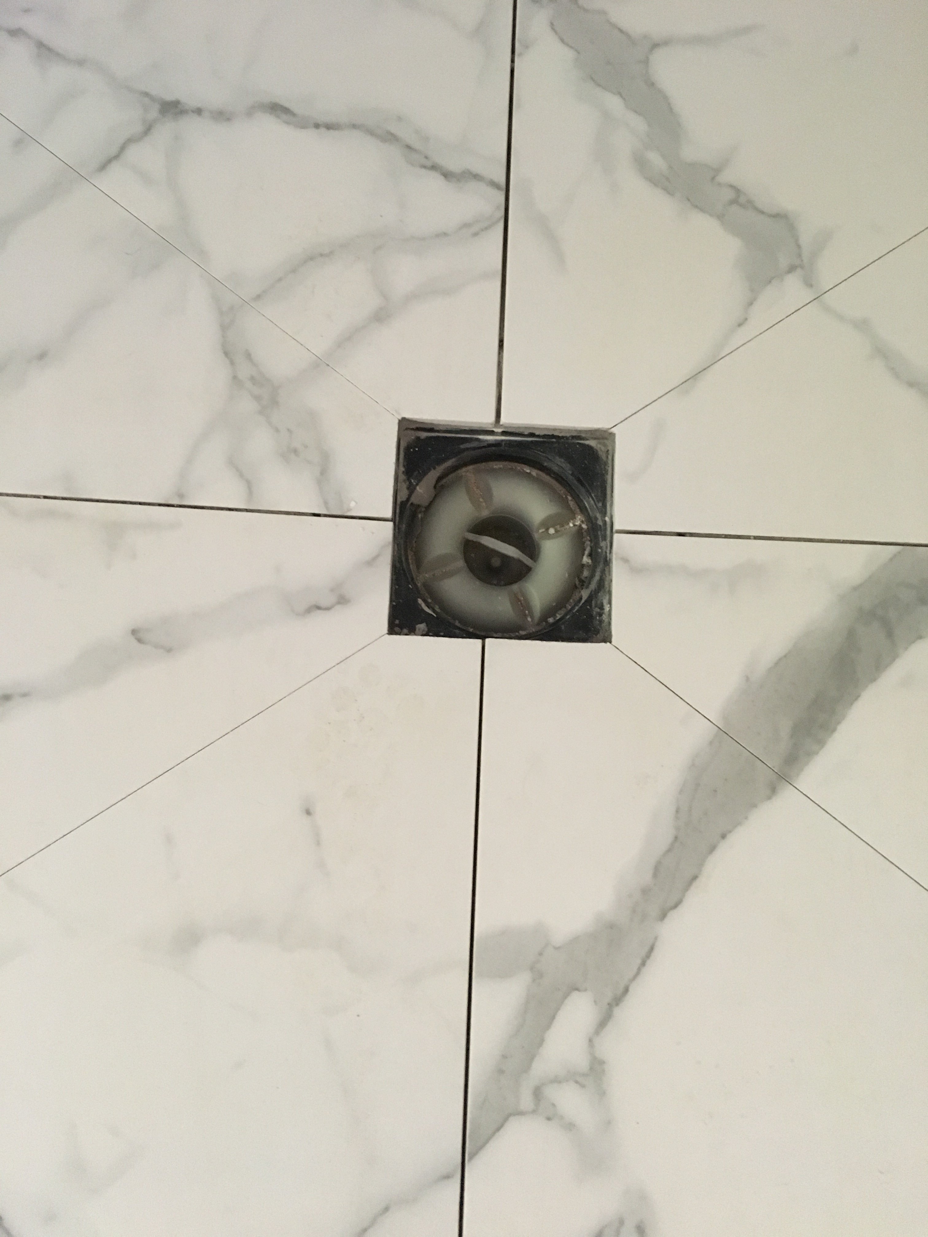

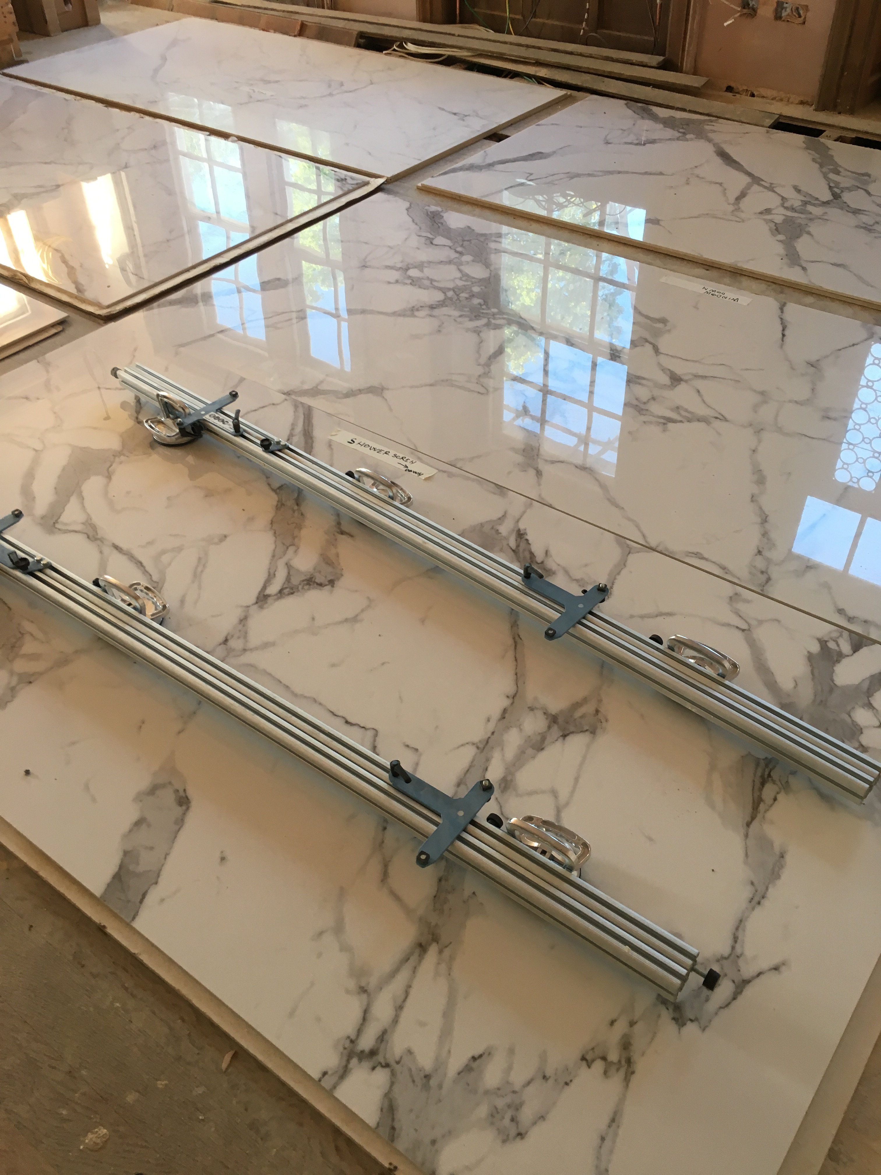

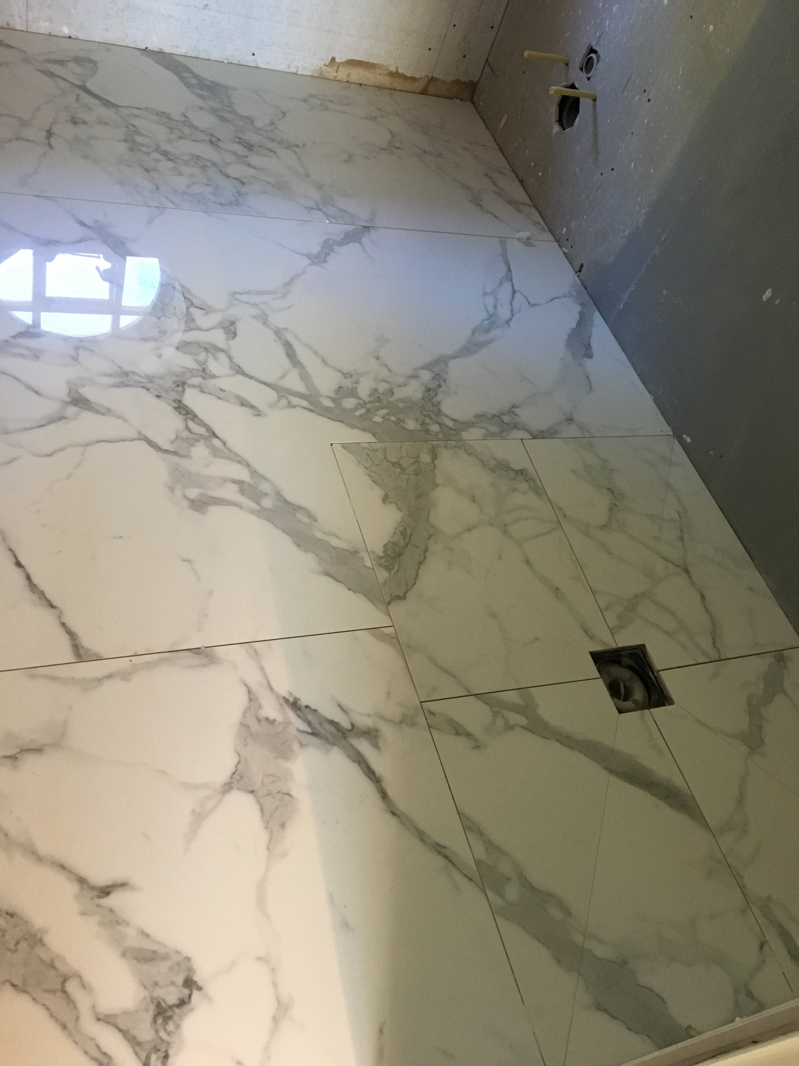

The Same nightmare, cutting down and up two floors.
2.4 x 1.5,10 mm thick is a really hard to cut, I try with all tools I have and back to the IMG_2798.JPG grinder for not a risk to break.IMG_2796.JPG IMG_2808.JPG IMG_2799.JPG IMG_2809.JPG
