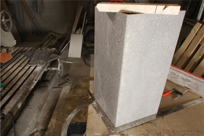

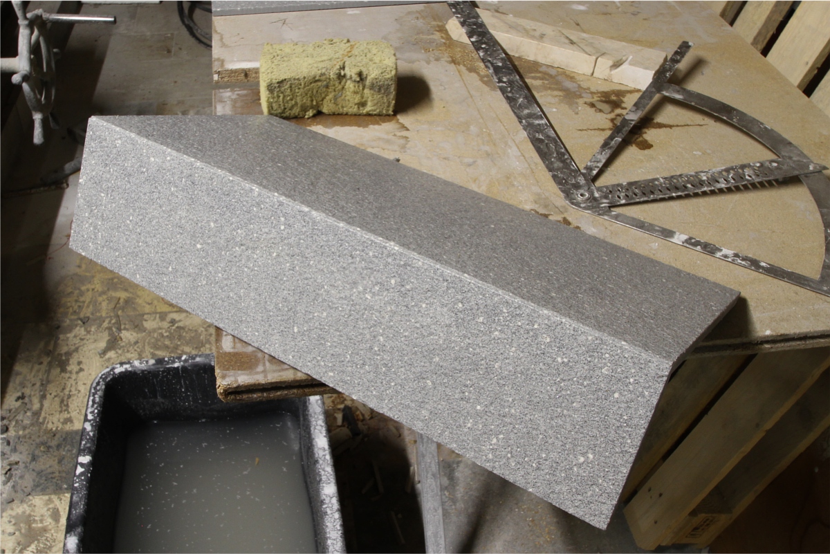

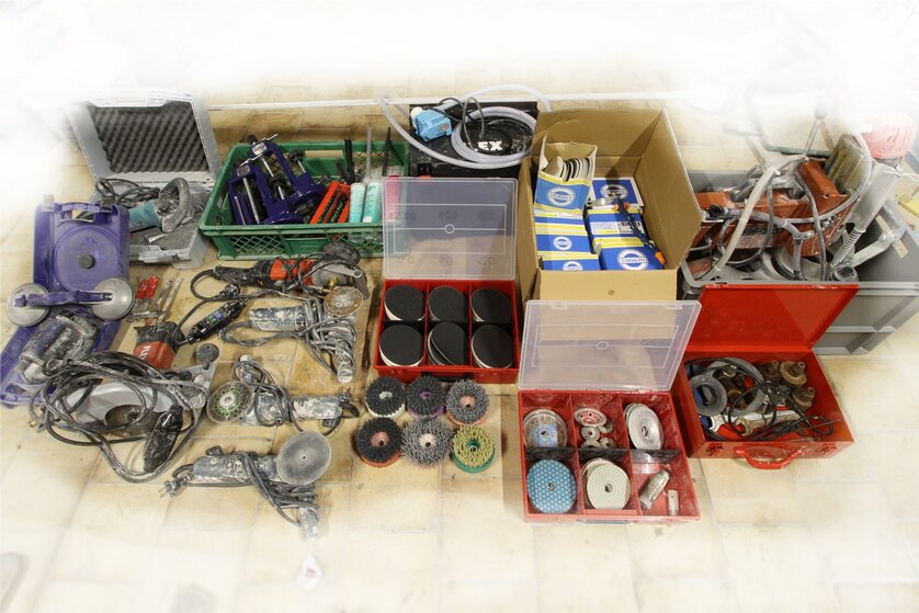

today i sanded the first glued mitres. here are a few fotos of the projekt i talked about. look at my machine park for this small toilet room!
the miters are not final sanded. i sanded with C600 but i think i try C800 so the edges get more darker. the glueline is not perfekt but in reality the glueline is relatively unflashy. the edges are nice to touch.

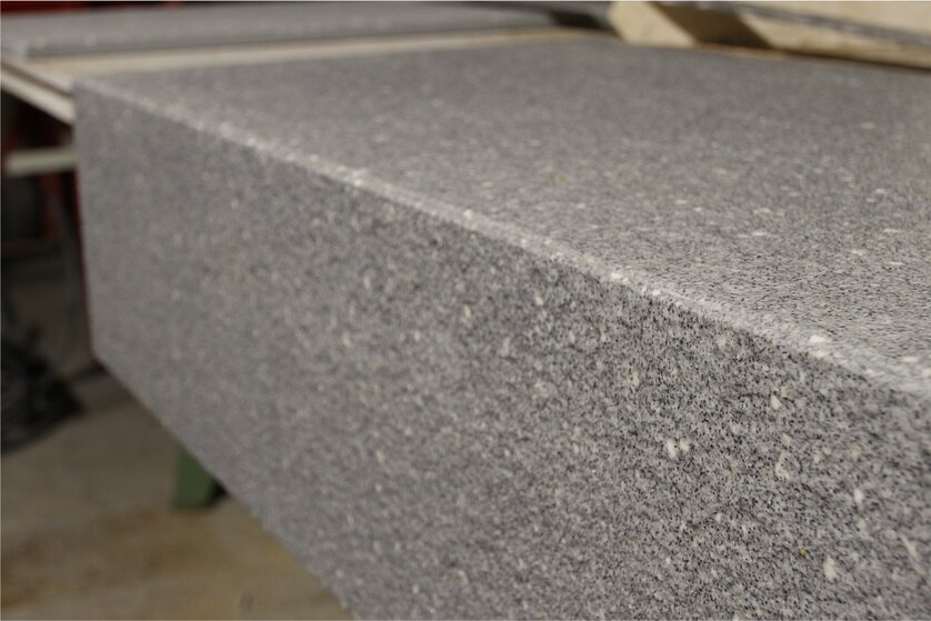

i have done the sanding of the edges today. and then tiled the floor.
i think it will look good after groating and cleaning the tiles.

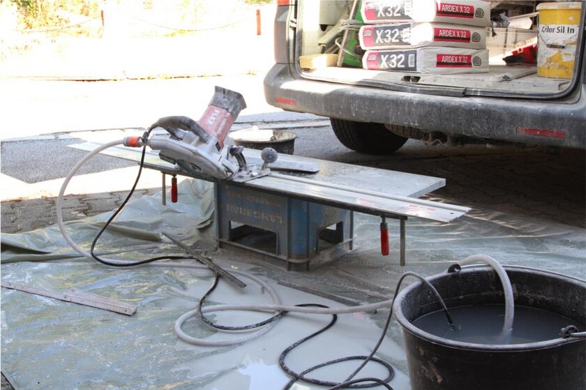

testet my new flex yesterday. the first tests the rail does not hold so i weld two special clamp i can slide into the original grooves on the backside. so now it fix perfekt.
for site i have a waterpump and tube.
i miter with the flex and the first try´s are difficult but then it gets better and better. i think i customize this saw as much as i can. its nice and mobile.

the rail has two grooves. in the front groove you can use the clamps when you cut straight, in the second grooves you can use it when you use the miter cut. i make a video. my clamps are very good.
i use the turbo blade from flex. flex has 3 driffrent blades. i think i try a rainforced 150mm blade and i have to customize the waterflow. i need much more water on the blade.
flex has only have to rebuilt the festool saw and make it ready for water and stone use. the flex saw is ok but lot of things can be improved. the platform is not very solid.
