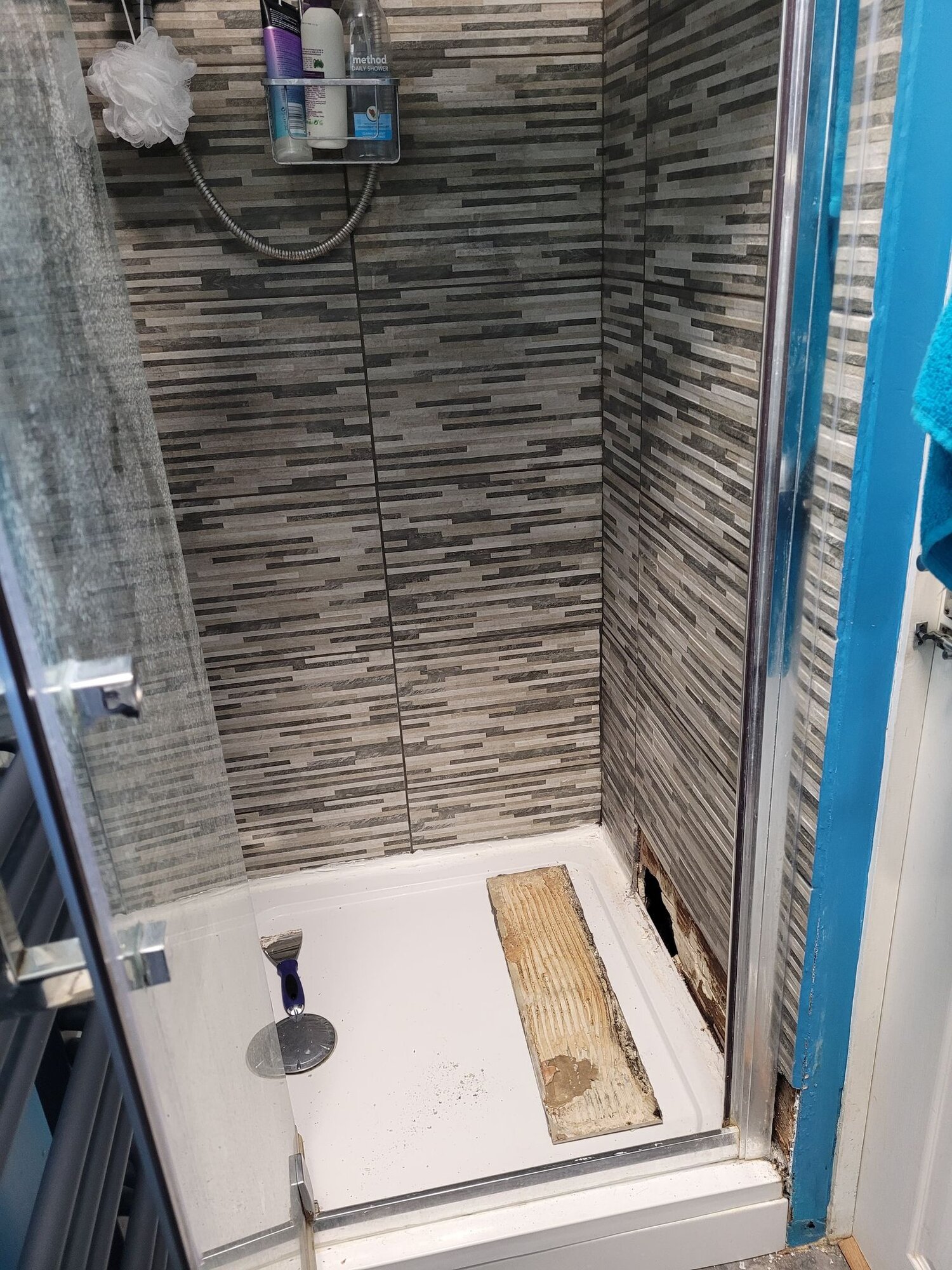

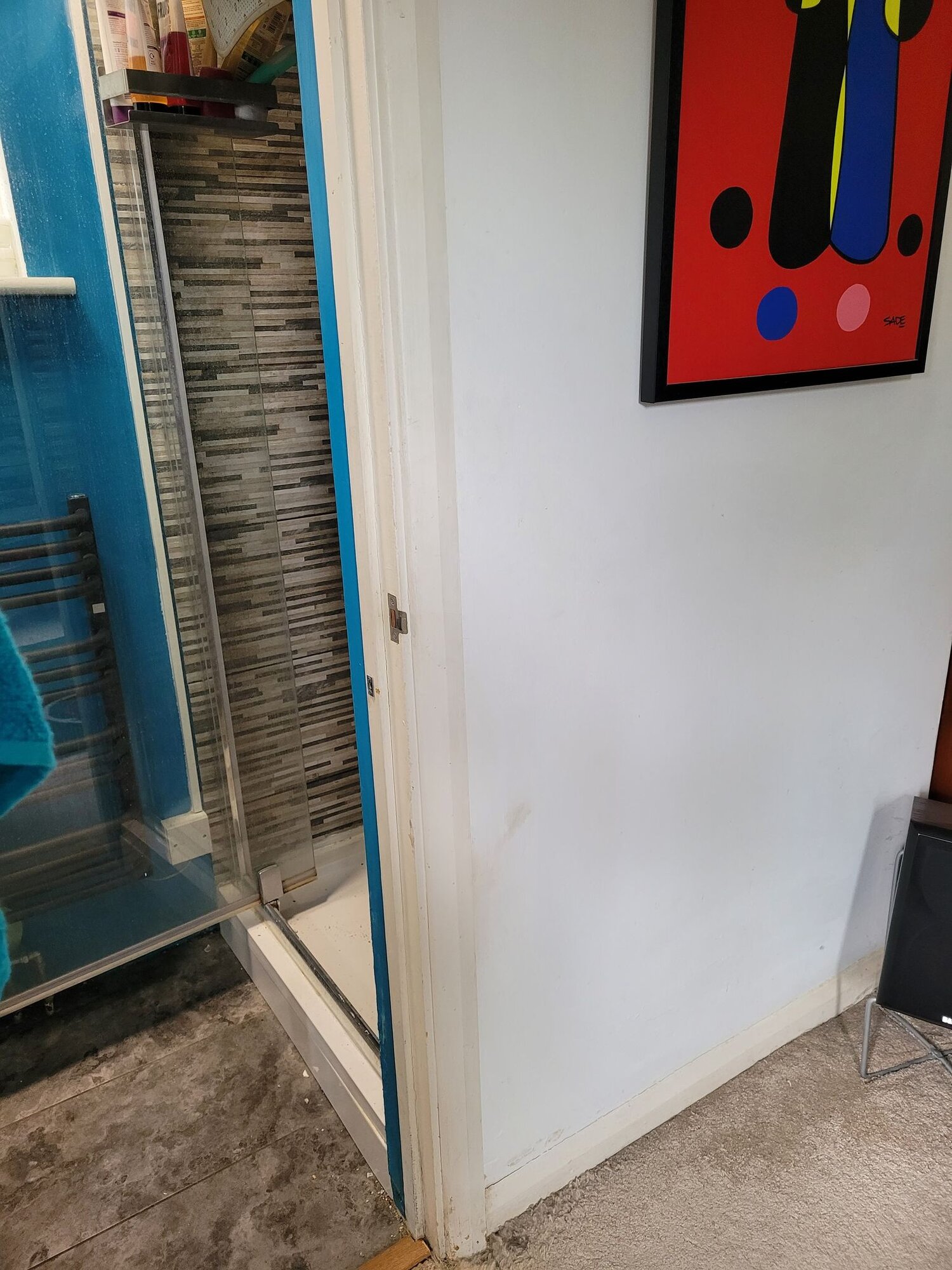

Needless to say, it's been just over two years. The tiles have started falling off, the false plasterboard wall he tiled directly onto is now completely rotten and crumbles away in your hand and damp is seeping through to the adjoining room.

Thanks. Unfortunately, he absolutely wasn’t the cheapest quotation we had. He was the most expensive. We employed a plumber to do the job, but when he arrived he said he’d subcontracted the plastering and tiling to a colleague of his who would be better at it. Then when the plasterer arrived, he told us he’d also subcontracted the tiling to a colleague of his who would be better at it..So right now, they’re all blaming the other one. They’re all on the main websites and have good reviews. I don’t know what went wrong this time. Miscommunication between them and no one taking full responsibility, I think.
