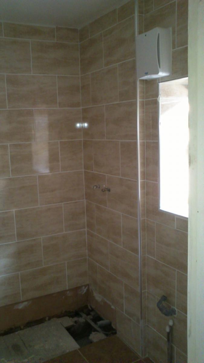

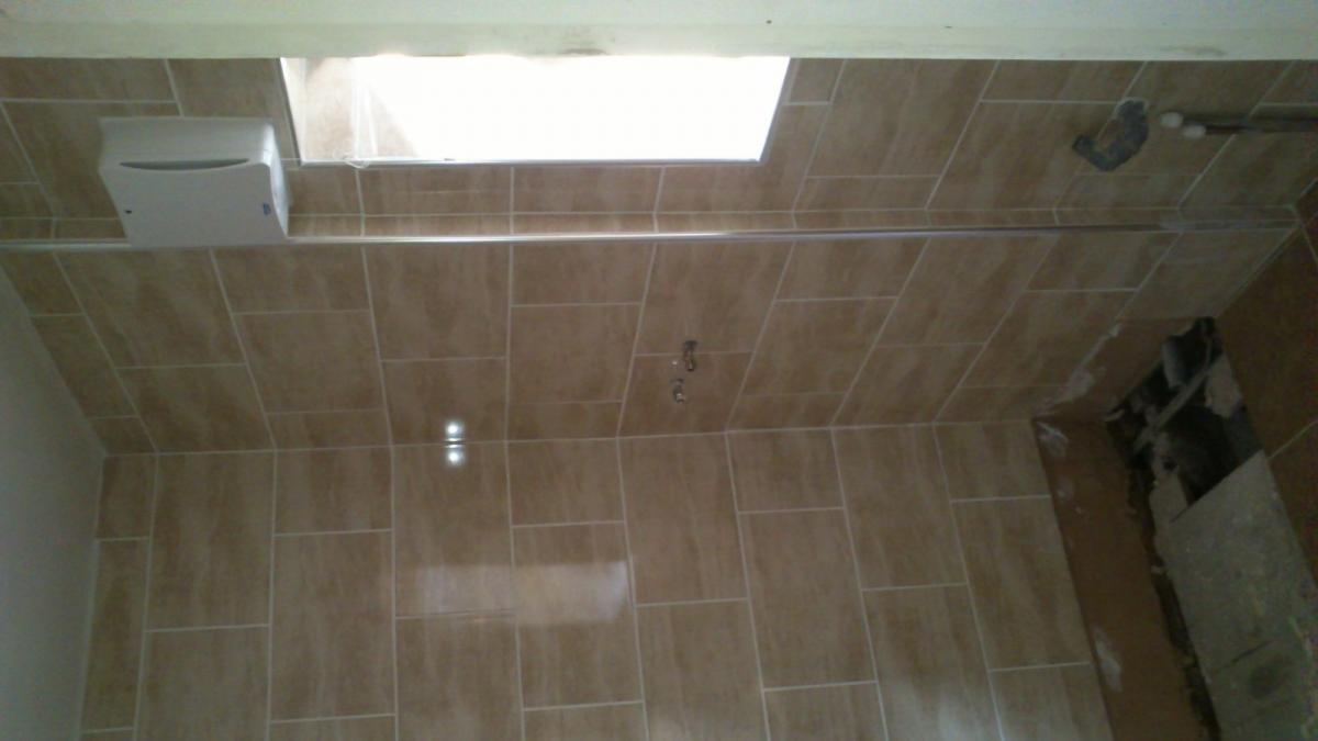

Cheers for the feedback mate.is your husband pleased with it ? not bad for a diy, the window needs a lot of work to improve it but i guess when you hang your curtains up they will cover up the bad setting out and no need for coat hooks just hang your bathrobes on the edges of the tiles that are sticking out
An l shape cut is not hard you can do one with just you're nibblers after scoring on your dry cutter with a wet cutter they are a piece of cake

Mr T Bag, is this one of the 'small' jobs you intend to take on? To be honest it really isn't an acceptable standard to be charging for is the simple answer. Regardless of the cut you couldn't do with the tools you had, there is a lot more wrong with the install.
Now this chap you did the work for may be happy with the job as i'm guessing his standards aren't very high if he didn't feel the need to alter the abortion that is the towel rail tails before it got tiled. So you may be happy with it and this customer might be happy it with it, but it is well below acceptable standards for most and another customer may well insist you rip out and start again at your cost. As for not having enough tiles, a good tiler could have spent an hour jigging the setting out which meant more cuts could have been used in other areas and I can see at least a whole row of tiles that don't need to be there once the bath is installed... which btw is always better to be installed before tiling.

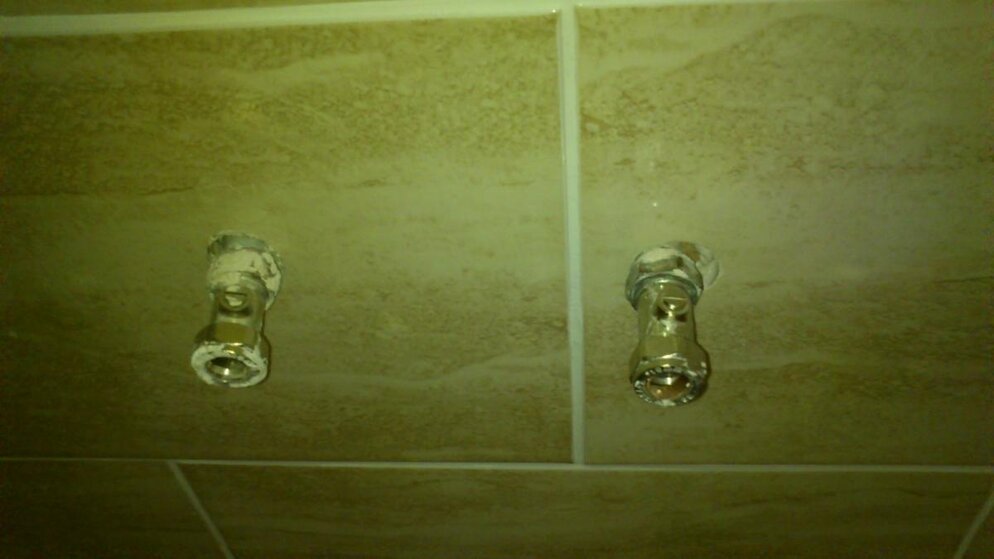

Back on to the plumbing... who put those isolating valves on the shower tails? The plumber is going to have fun with that one when it comes to putting the shower valve on. No need for those to have been cut so close to the walls. Options are now limited.

thank you... below average to average d.i.y is a bit harsh tho mate. you say its not acceptable to charge for this work which i understand mate. unchargeable it is then... but i can already see im being slated on this thread for it being me. comments wasn't so harsh when i firs posted and i should of left telling people who i am maybe comments would of been a little harsh... not at you plan tecMy goodness! I didn't even realise they were the shower feeds, I assumed they were the basin feeds for a vanity type unit. Oh dear.
In my honest opinion Mr Tea Bag, this is about what I would expect from a below average to average DIY attempt.
I appreciate there is a mixed opinion of your abilities and ethics on here, and whilst I cannot knock your enthusiasm, I can say that your work is not of a chargeable standard. I know a lot of people have had a lot to say in various threads, and I for one have sat on the fence until I saw your work. Now I have seen it and had my say.
