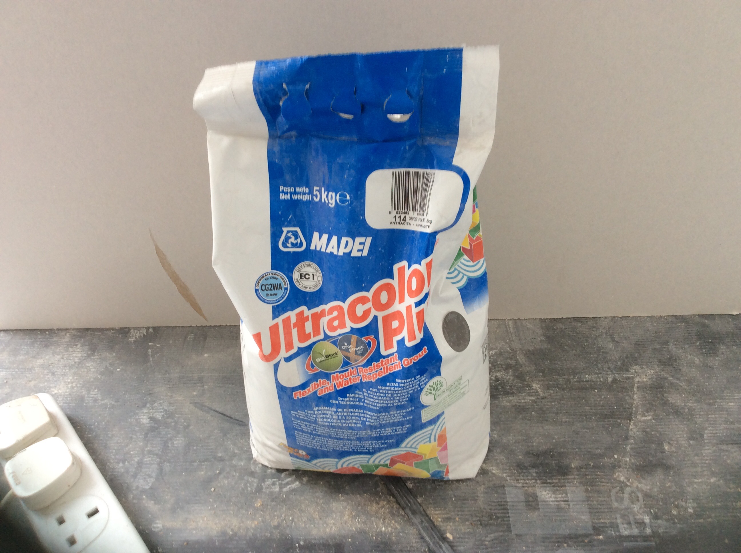

In meantime apologise if this is a stupid question, but what are the risks if we don’t seal the tiles at all? Builder is going to use Mapei UltraColour Plus dark grey grout. Would this stain the tiles if we didn’t seal them first?

You might get away with it , but if you want to try to what you have been sensible enough to do so far ,test , mix some grout , spread it on a spare tile , and spread some on a tile you have sealed . Leave for a few minutes , clean off allow to dry and see what you think ,.
As a general rule of thumb the darker a limestone the more dense and less susceptible it is to staining (there are always exceptions through).
They are still porous though, so sealing is a must.
I'd do as @jcrtiling suggests and test it on an off cut, but I'd also leave some grout on the edge of the slab to dry overnight and see if the stone draws any dye from the grout.
