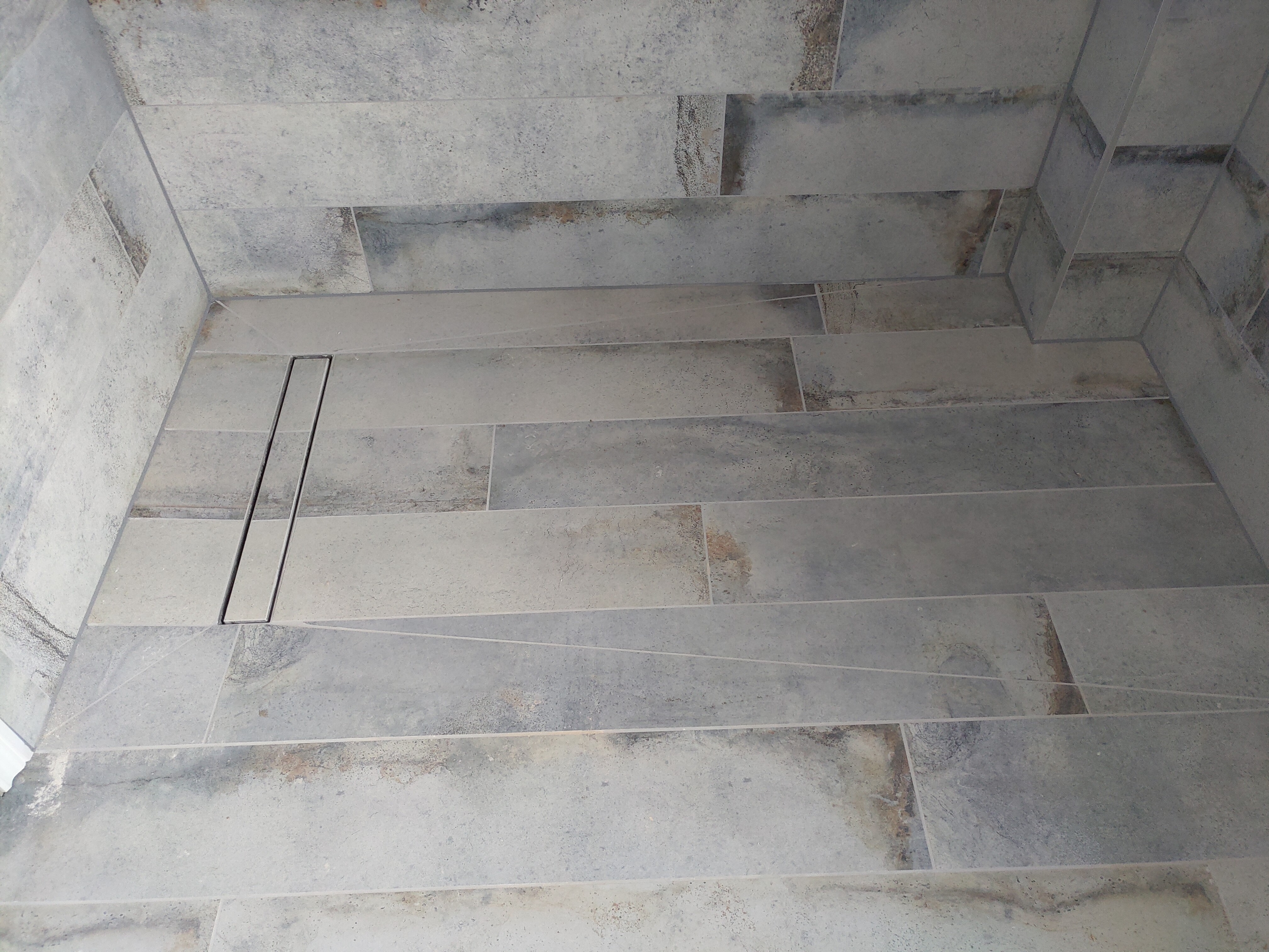

I maybe getting ahead of myself but as far as the pattern, if I use the same size they want in their stall, 12x24, vertical, is there a standard setting pattern? Starting with a full tile in the center bottom of the back wall leaves about 1/3rd a tile at top. Should i use a 2/3rds piece on both sides of the center full tile?
Depends in the effect you want to see.
Most plank effect areas start with a full piece, or nearly if it leaves horrid cut at end of the run.
The second run starts with the off cut from the first. It becomes a totally random bond giving the most life like timber finish.
If there’s a timber floor you can view you’ll get the concept.
Symmetry doesn’t work well.
You can still mark out from centre, but for example, take the far left corner and measure up where your cut will end and take the offcut and place it in position of the next course and work out the next top cut, then put that off cut centre or your shower. 😁
Employ same technique to your wall as in the end of this floor in the window area
You’ll have to enlarge image probably.
Yeah still need a grout joint there the same size as the rest.
Personally I’d say yes, try a shorter plank left corner.
Or just adjust left corner up and down till you reach a desired effect.
Starting the next row with off cut isn’t mandatory, you can also shorten that if it helps give a more random appearance.
Obviously the beauty of being able to leave them in one piece is that it’s less work for you.
