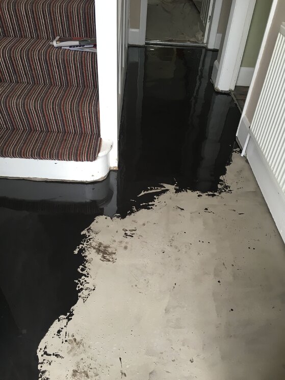

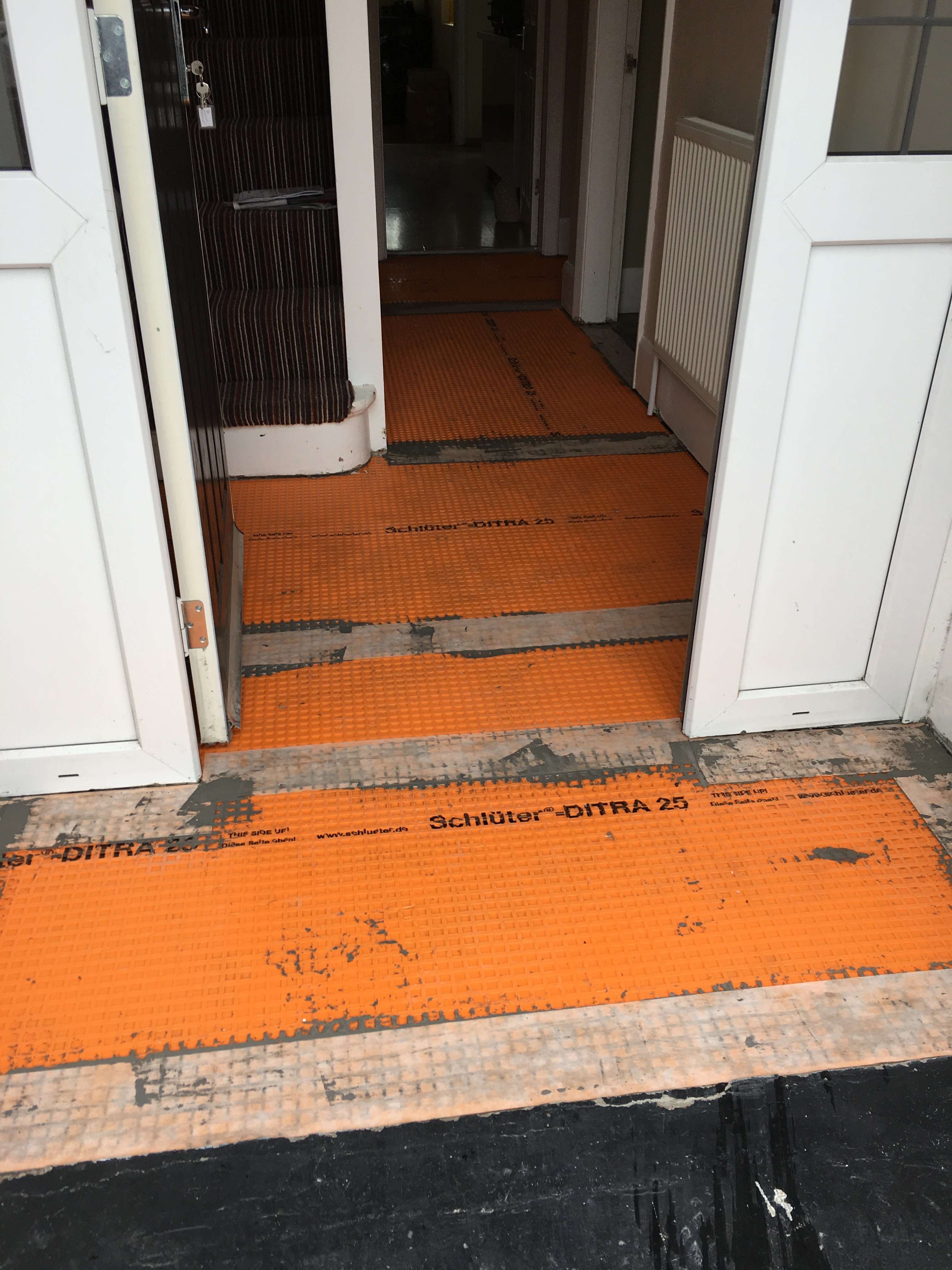

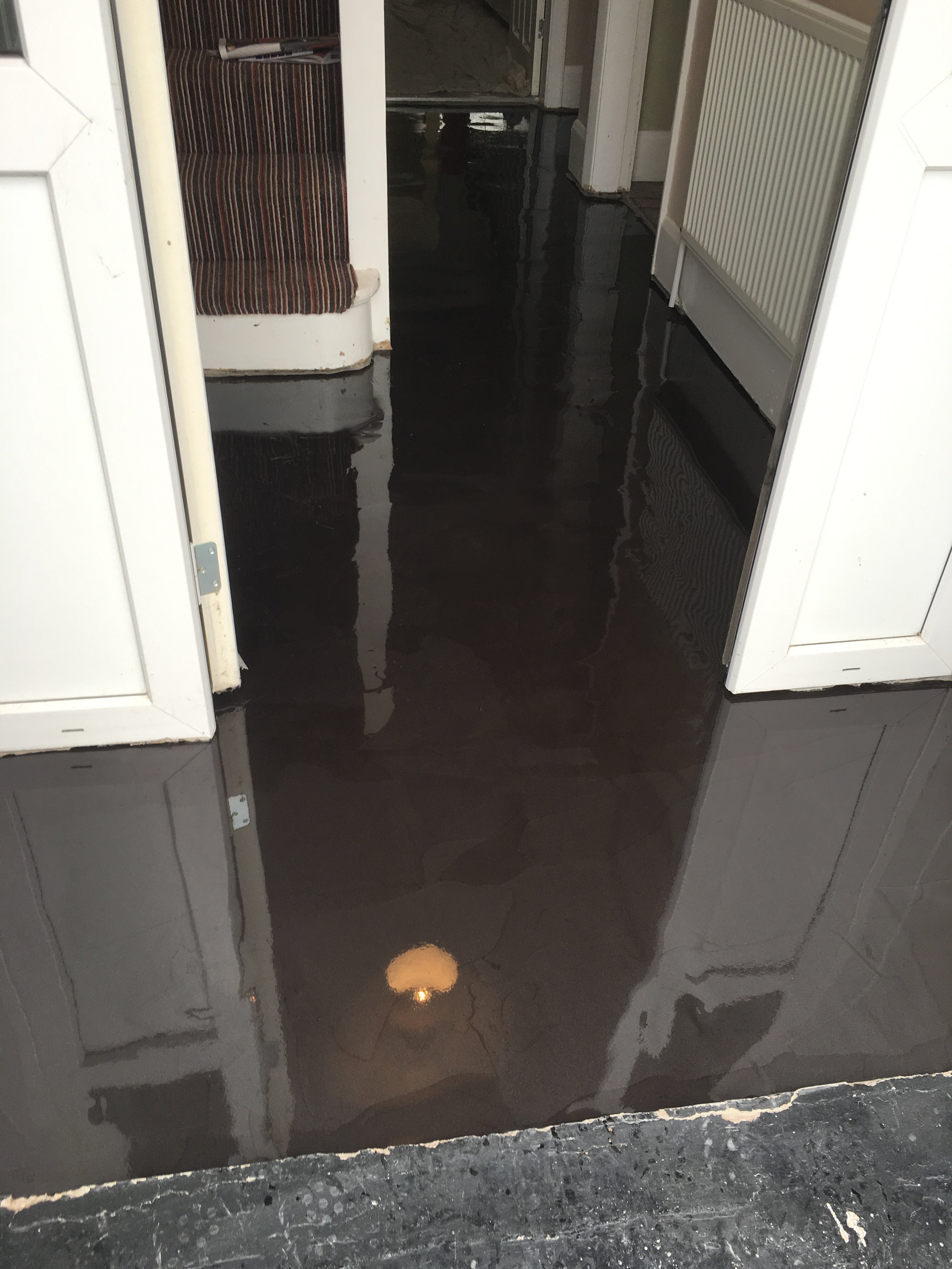

So this was the prep completed before tiling again.........I latexed over the old latex with arditex na then used ardex dpm 1cr ( expensive stuff!......then ardex P4 then Schluter ditra 25 with kerdicoll......pictures attached......think it will be a miracle if any moisture comes through the grout joints now!!!!
