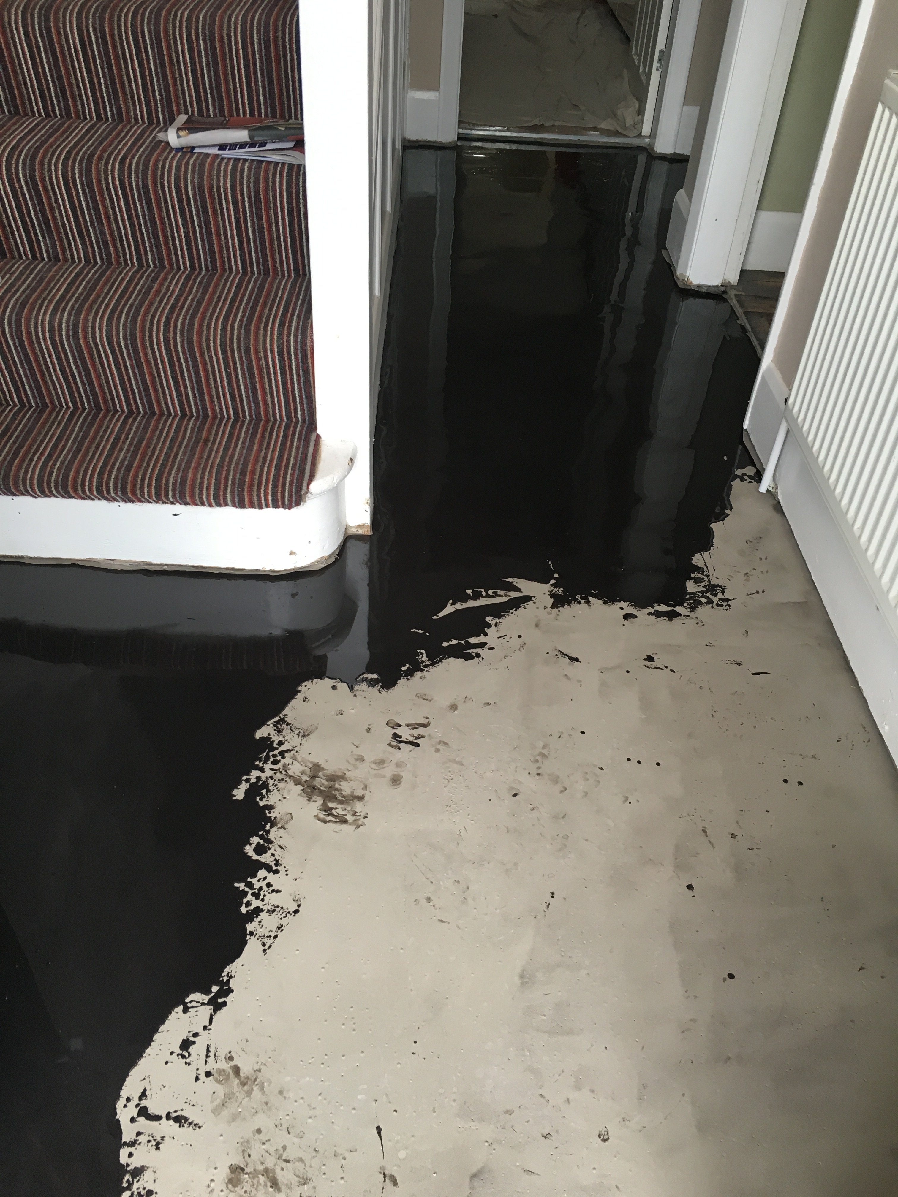

All the rooms off the hallway are old wood flooring & no work done before me, also had a plumber out to check the house for any leaks and no sign of that......I've started taking some of the floor up this morning and the surface was damp in places.......so back to the latex now and looks dry......pictures before, when tiles removed and then after adhesive removed as follows......
View attachment 81094 View attachment 81095 View attachment 81096
wood flooring onto timber joists or on the same screed?
