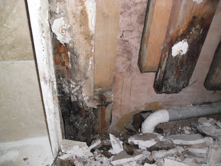

Does it feel a waste?

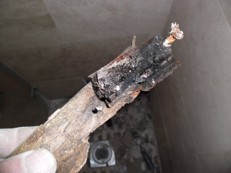

You mean like this Dean with no tanking.

i am sorry having to disagree here having inspected many failed shower and bathrooms .75% bad pluming ie joints behind shower leaking when under pressure bath not silconed to the wall shower tray under plaster board and so on .10% no silcone any were apartanly plummer ment to come back and do it .
15% realy bad tiling very lippy poor grouting allowing water to make very easy in roads.so what do i make of all this .well all you need for a great job is a plummer who knows how to seal his work .and a tiler who double checks .then seals again .tanking is for when you dont trust anyone .not even your self
Swimming pools are rarely tanked. They also rarely fail. The failures you see in showers tend to be a result of what the tiles are stuck to not the fact that the grout allows the passage of moisture. Plywood, plasterboard, mdf etc etc... I also still maintain that whilst grout is not resistant to the passage of moisture more failures occur as a result of poor corners.
Like I said before, most if not all failures are Down to bad workmanship , my ensuite is not tanked, ten years it's been in, only leak it has had is the stupid crappy bathroom.com shower screen I got ,leaking under the 'skirt' andthrough the floor boards 🙁
