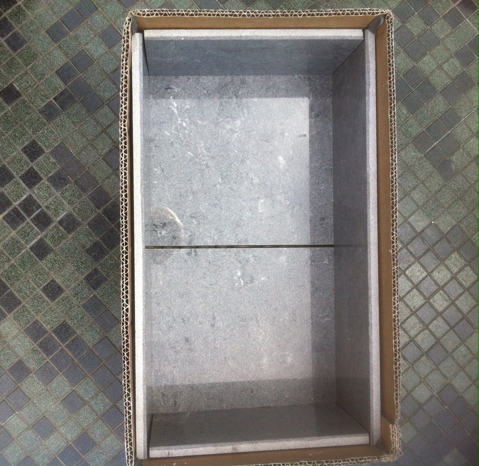

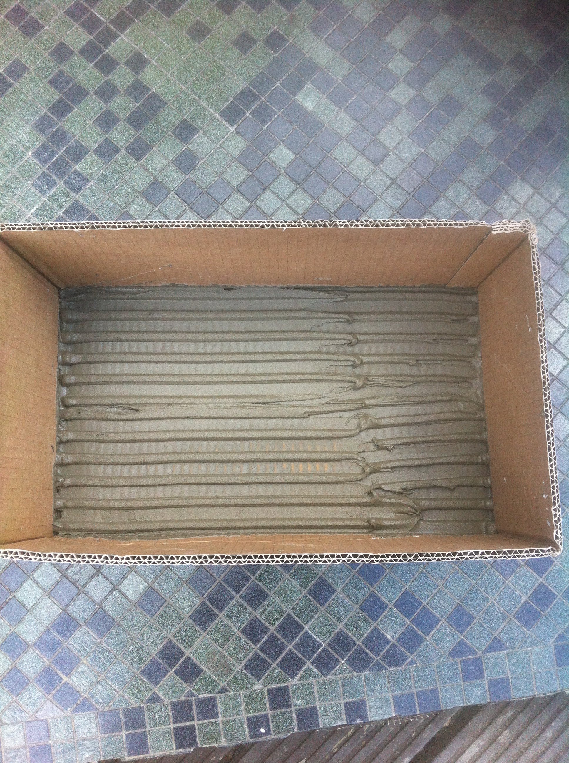

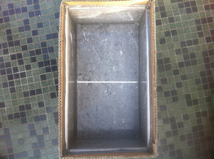

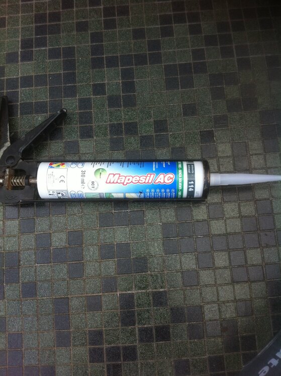

box is tiled and grouted corners are siliconed and it’s all ready to go i will fill it with water next saturday and the fun can begin

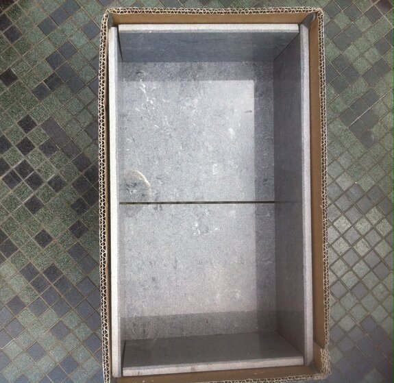

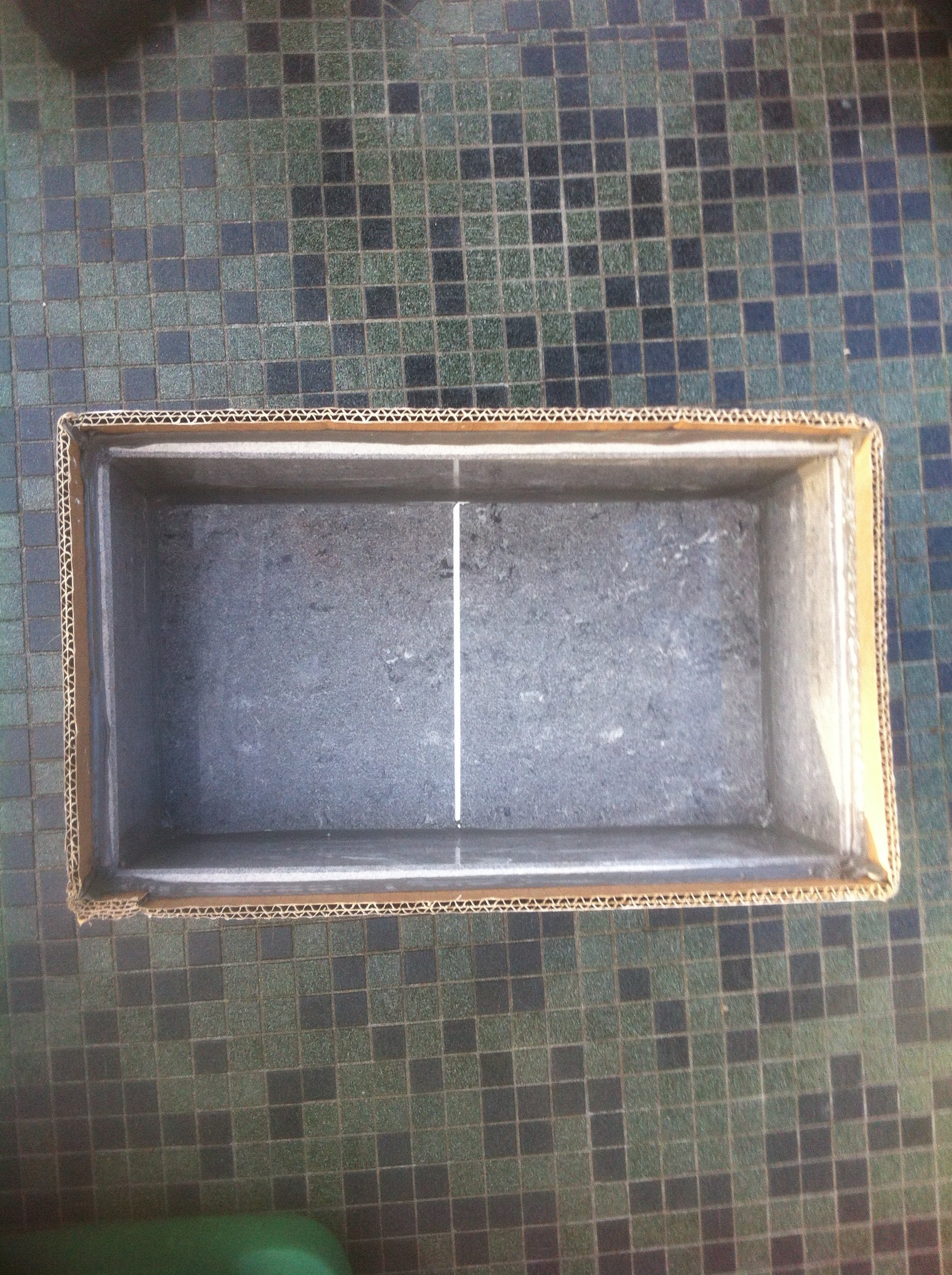

Must be honest, I was expecting more grout. Just one grout line? Sure the water that will get through is going to dissipate and probably never even get chance to touch the cardboard?
I was hoping 6x6 or mosaics or something?
the water will not have a chance to dissipate there is only one way for the water to go and that will be the path of least resistance the rest of the box is impervious.
What grout?
Absolutely no idea but I'd bet my left testicle that it was either some he ( my landlord) had laying around or the cheapest he could find.
Yeah I just can see how one grout line is going to allow enough water through to penetrate the cardboard.
It'll end up evaporating out before its managed to soak through the grout. And what does soak through the grout will disperse amongst the adhesive and not really effect the cardboard.
