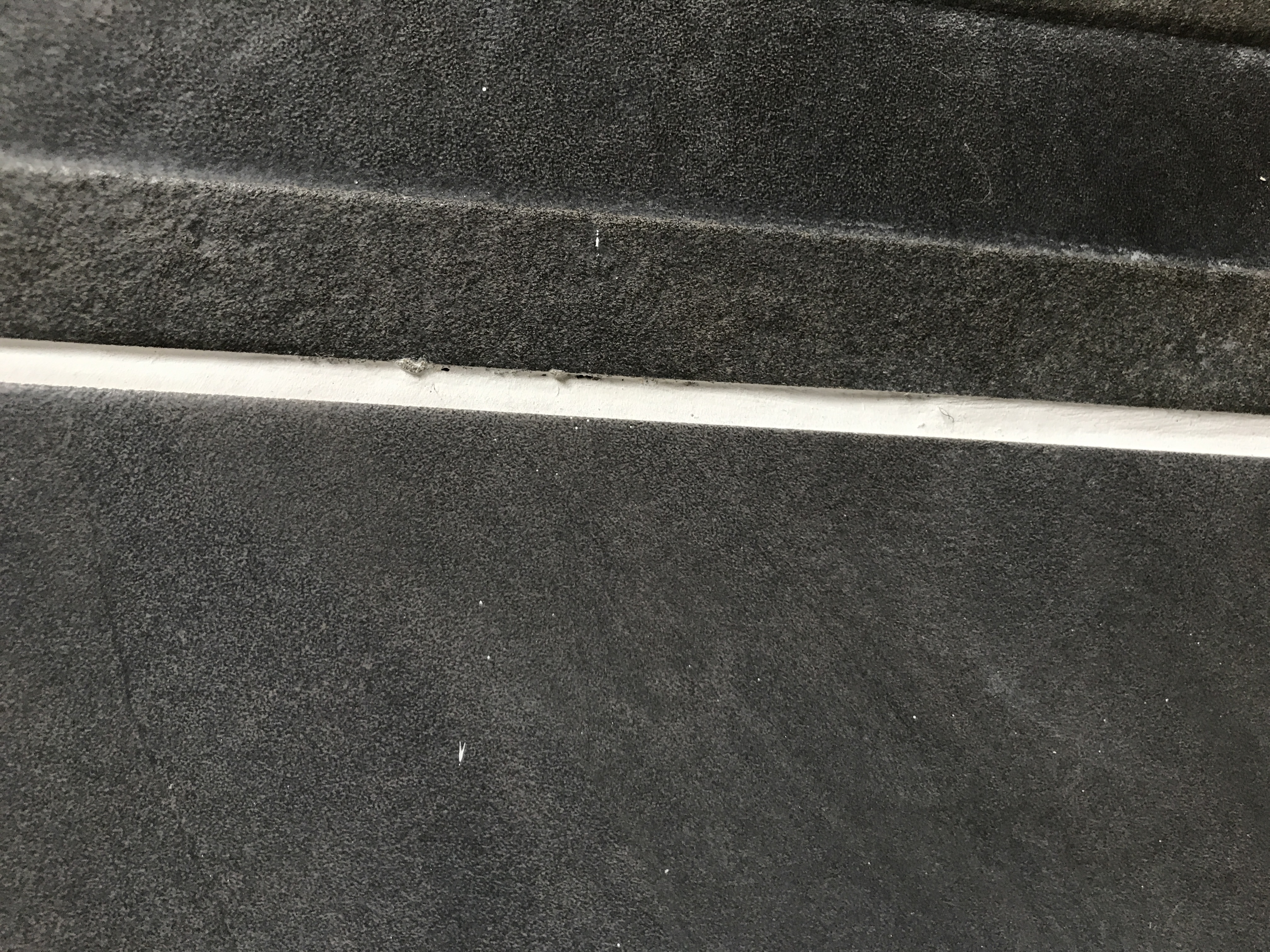

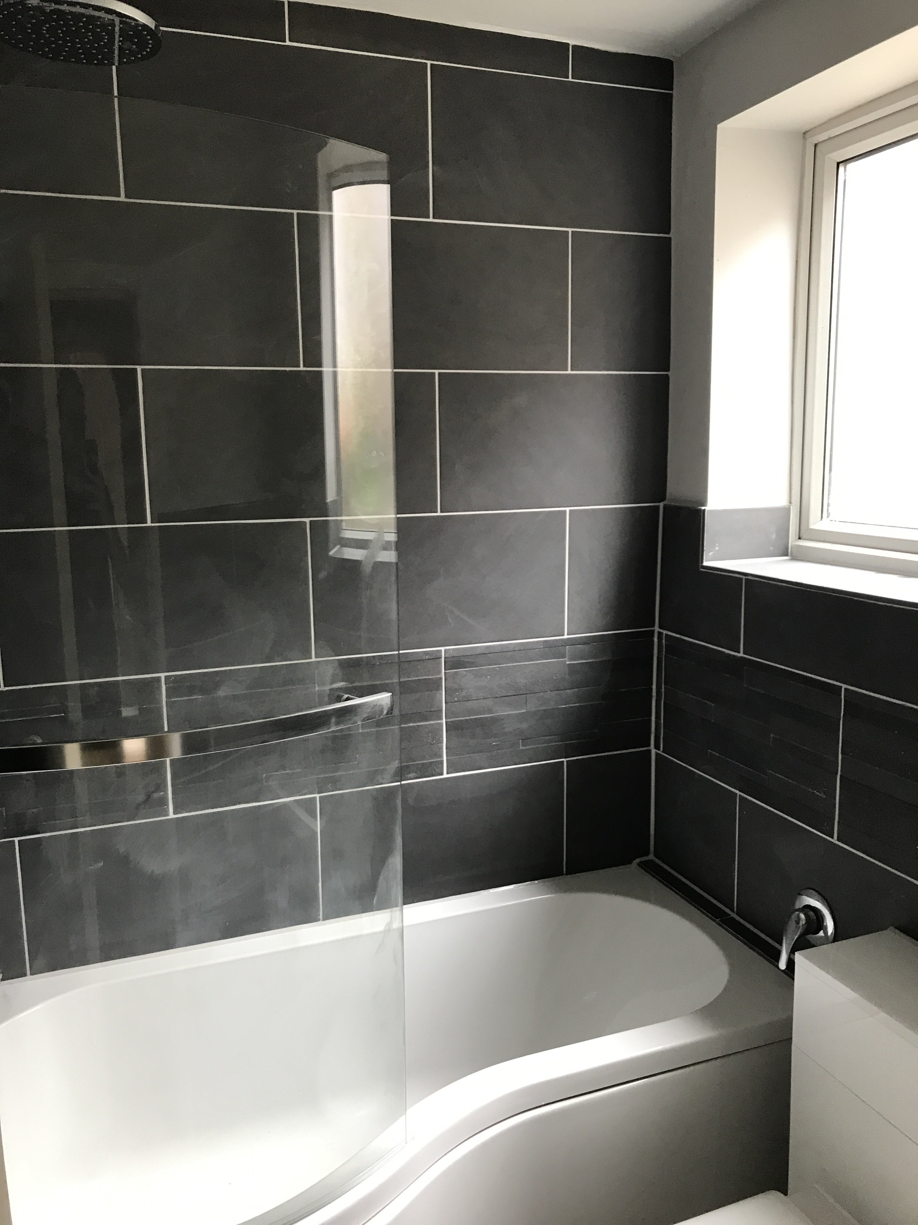

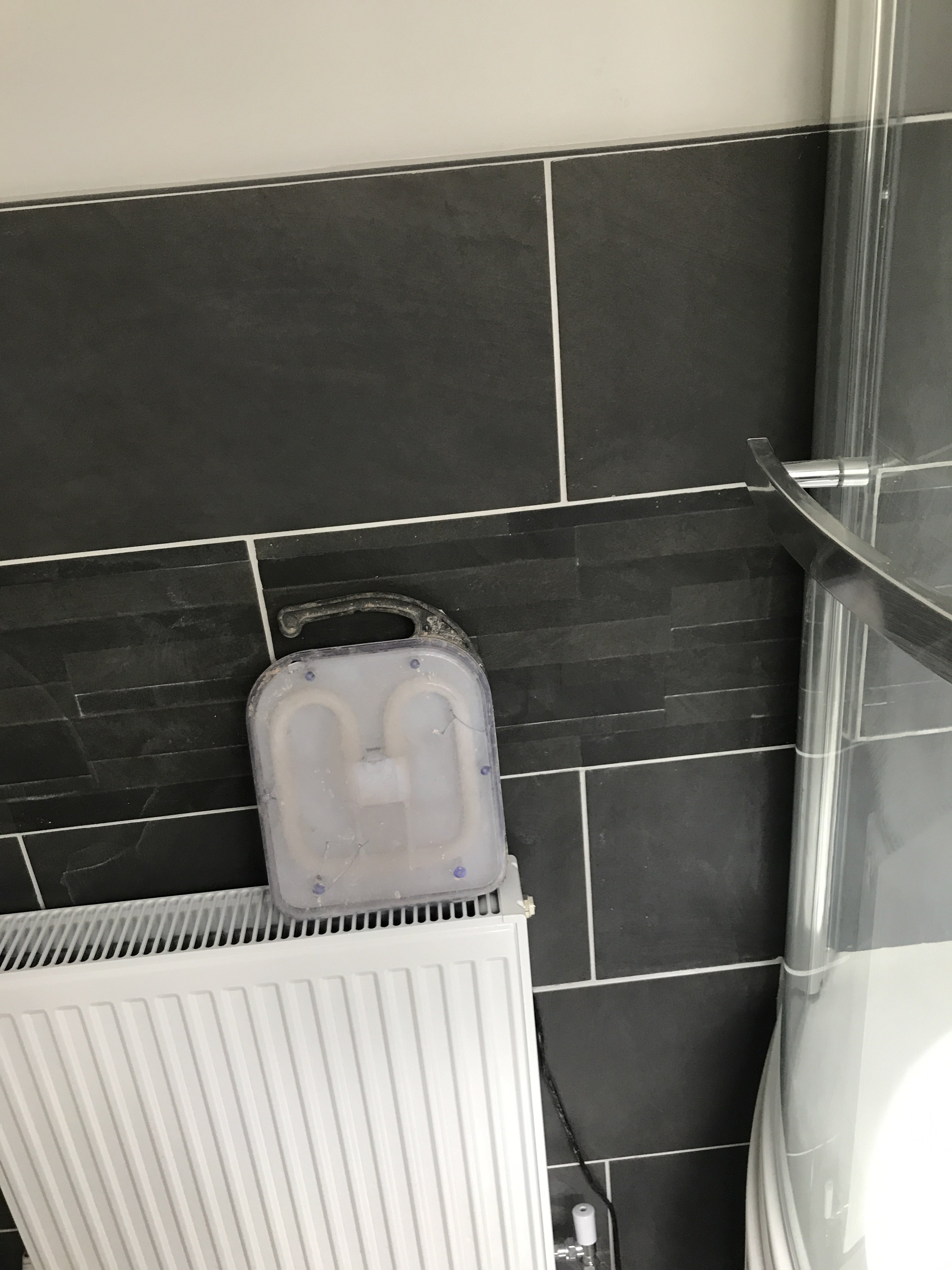

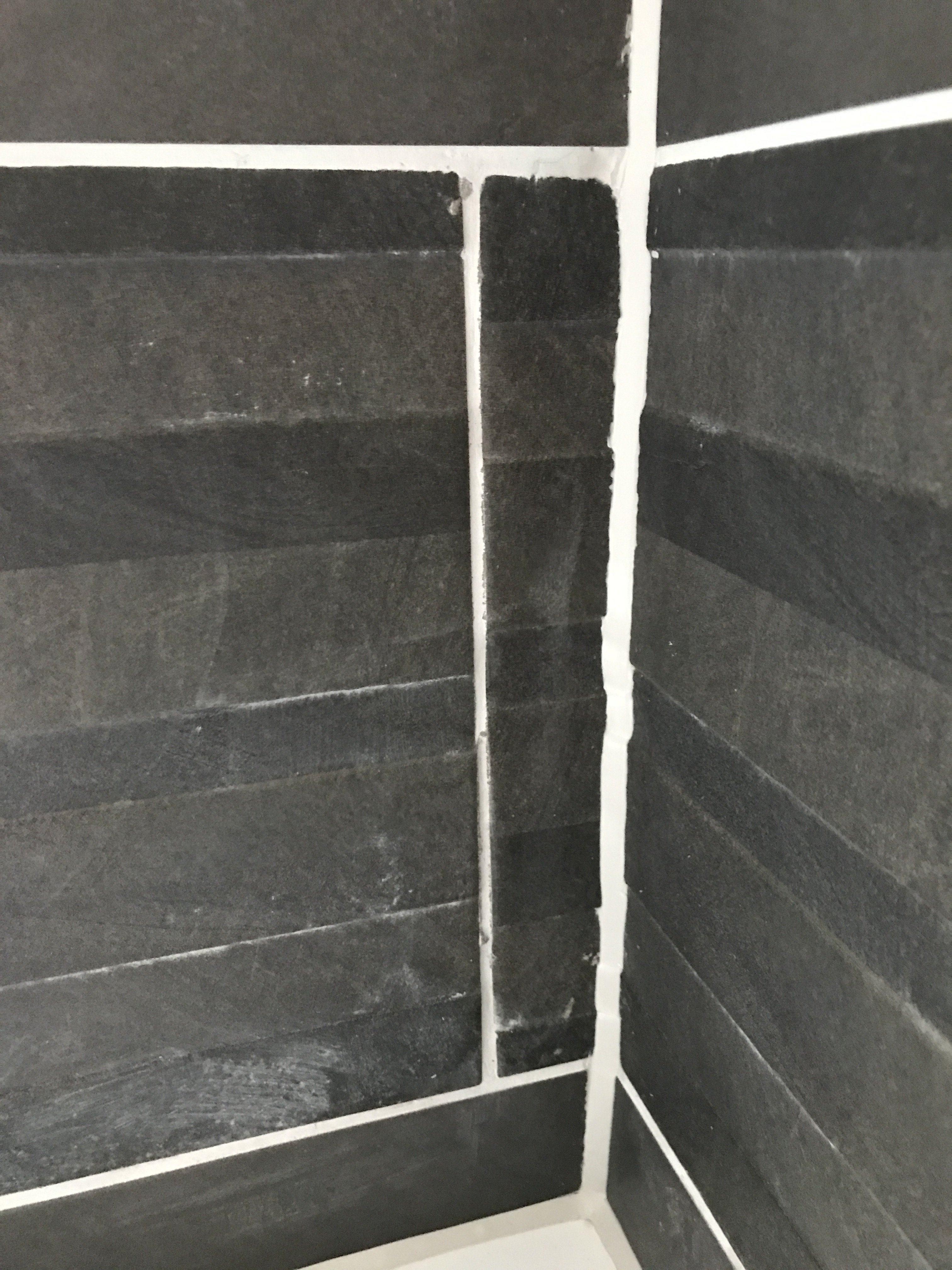

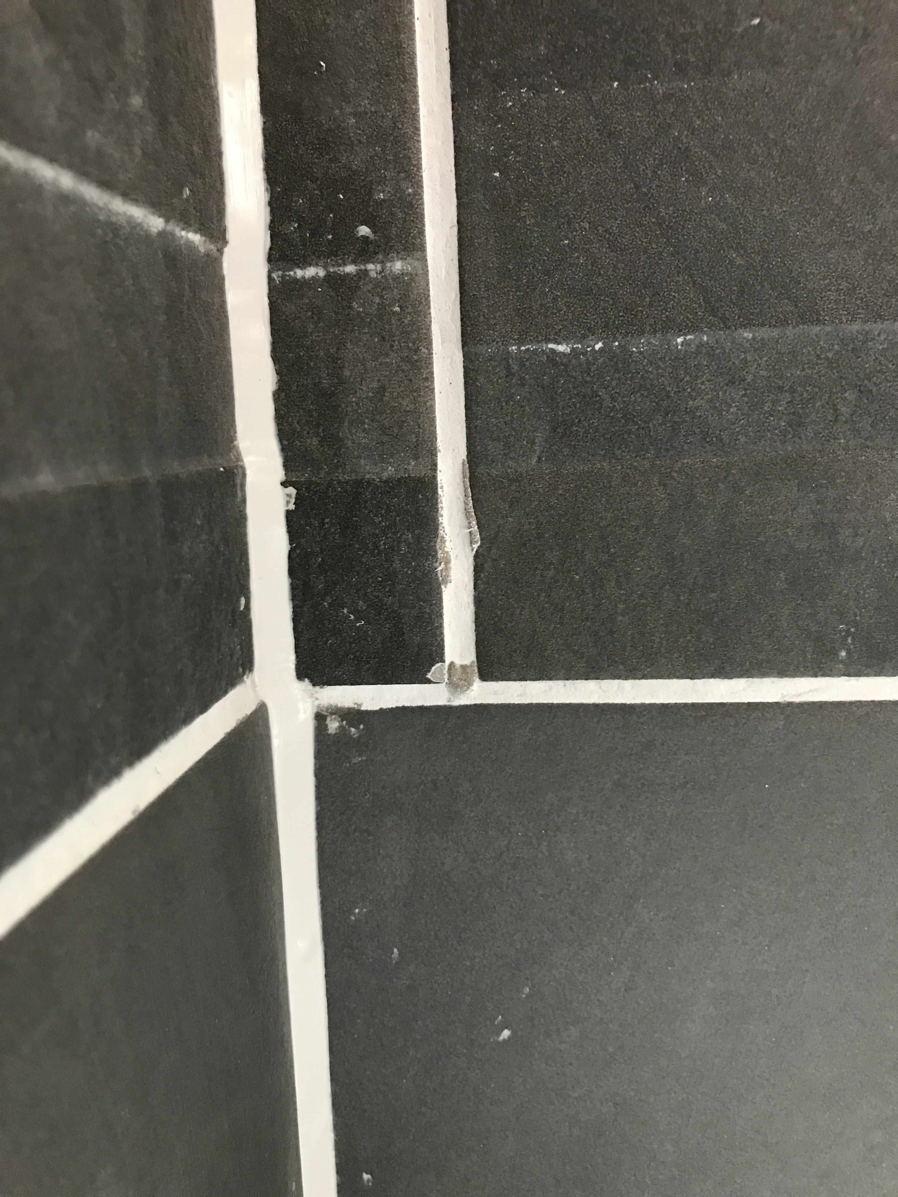

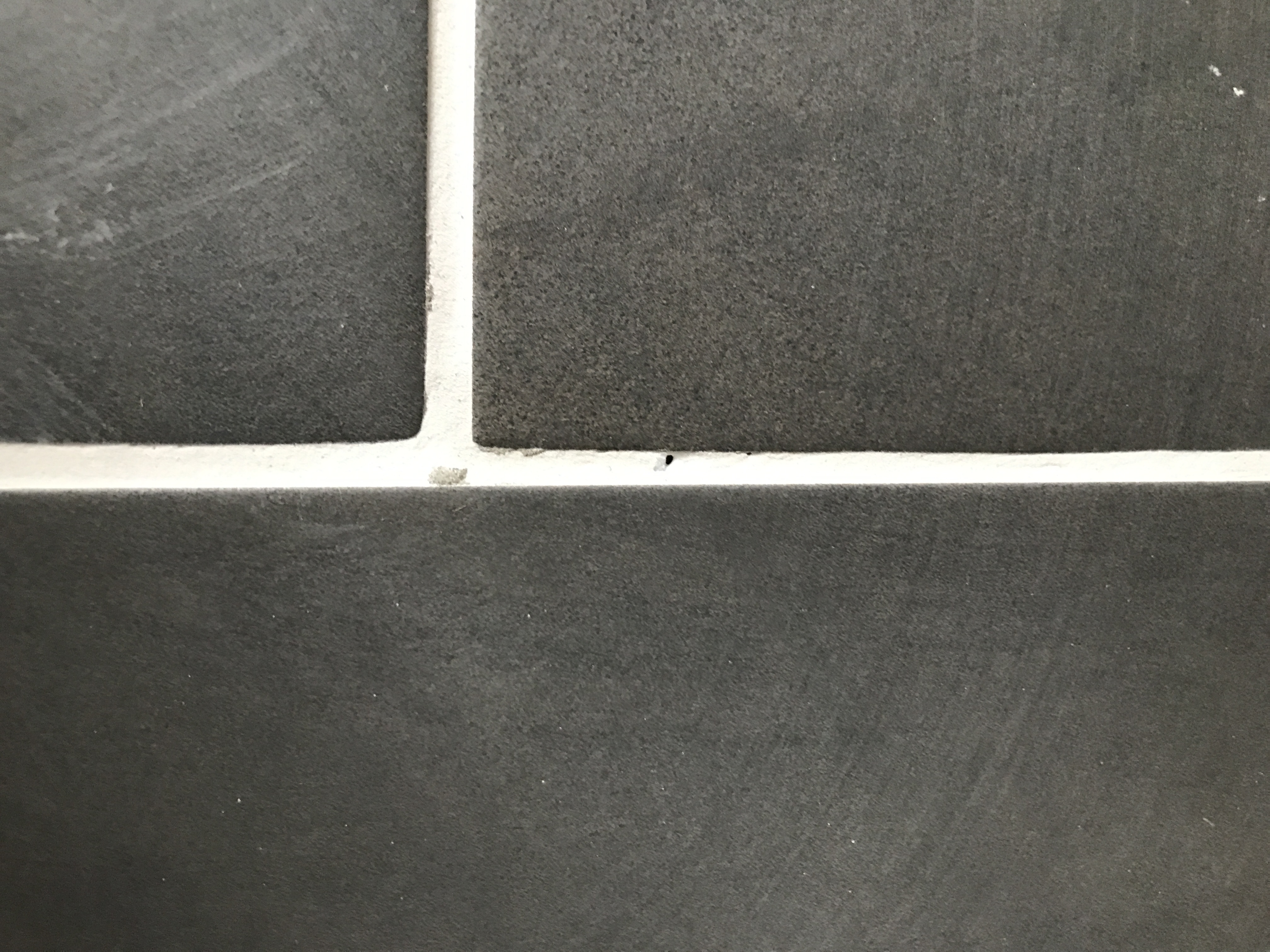

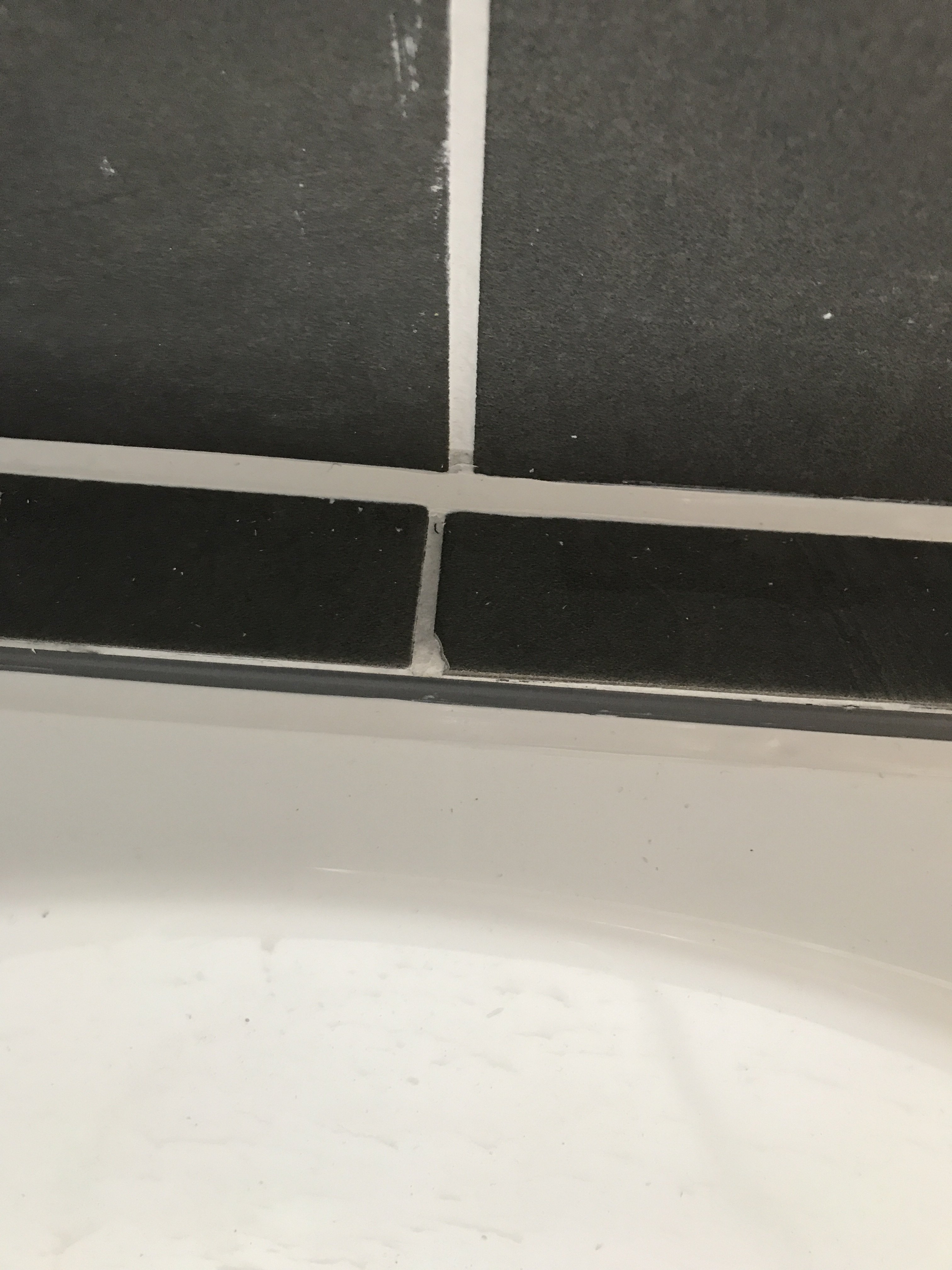

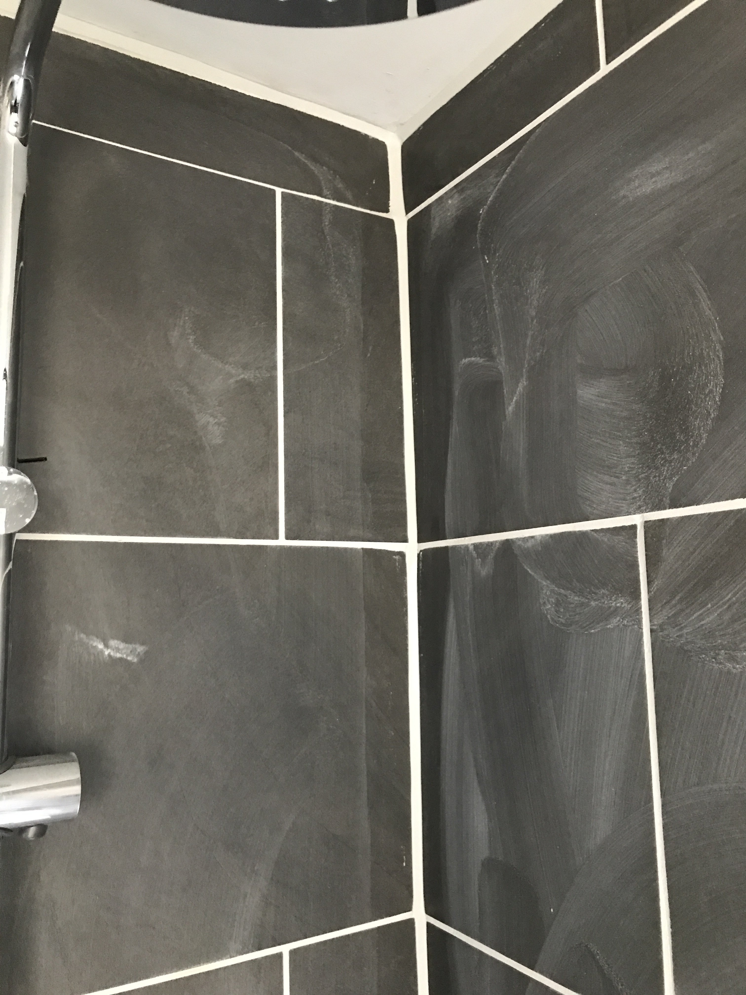

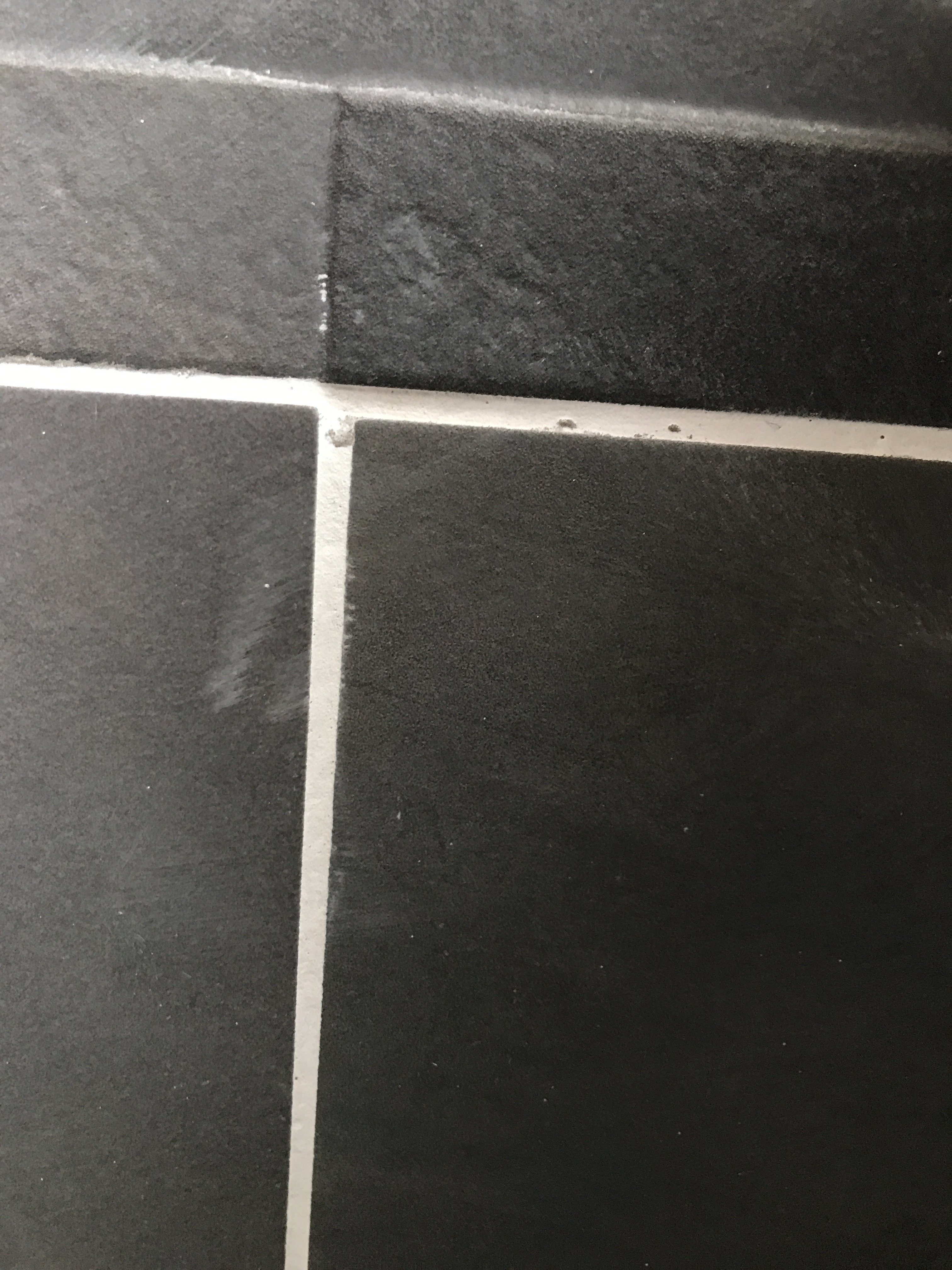

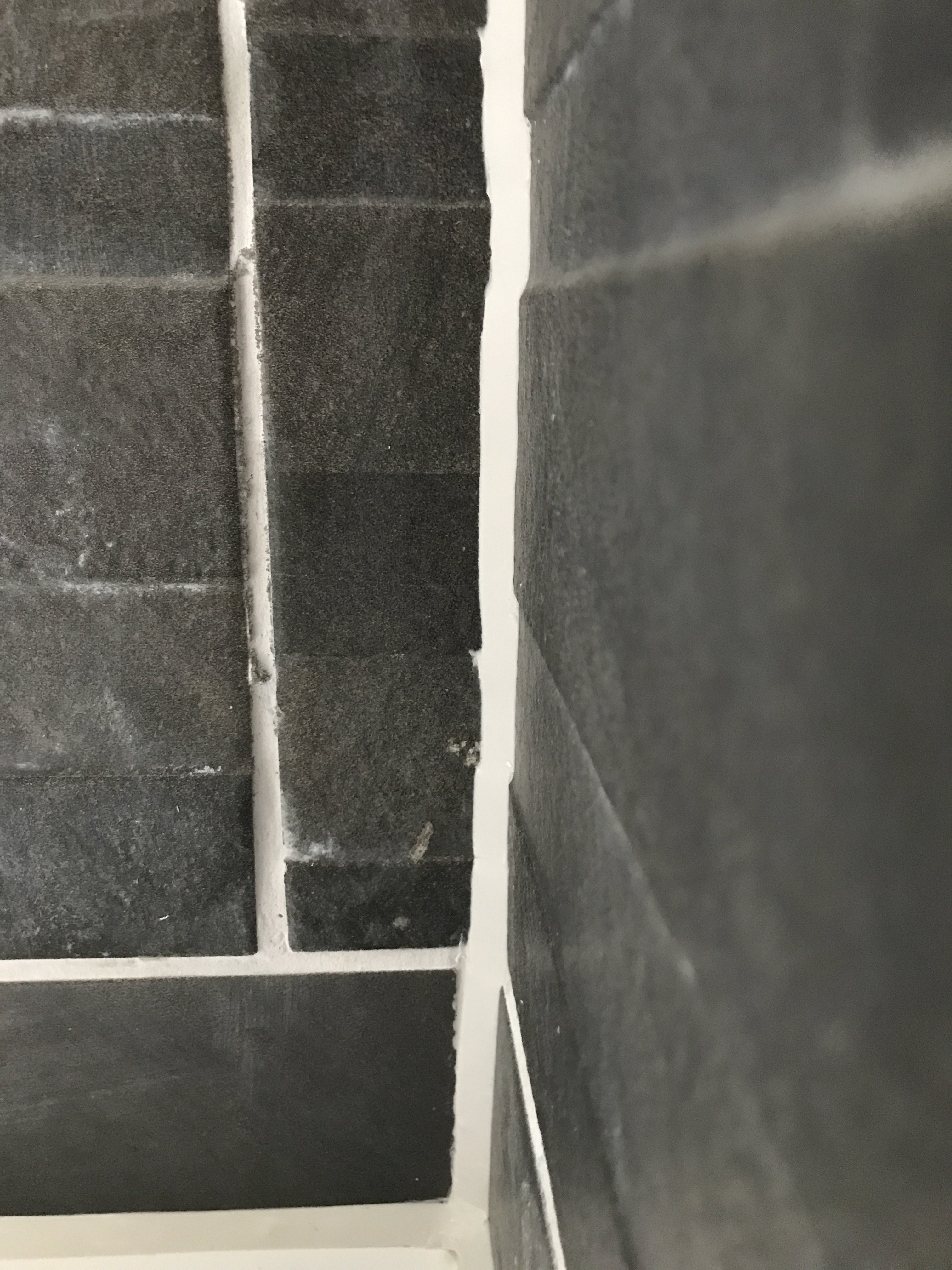

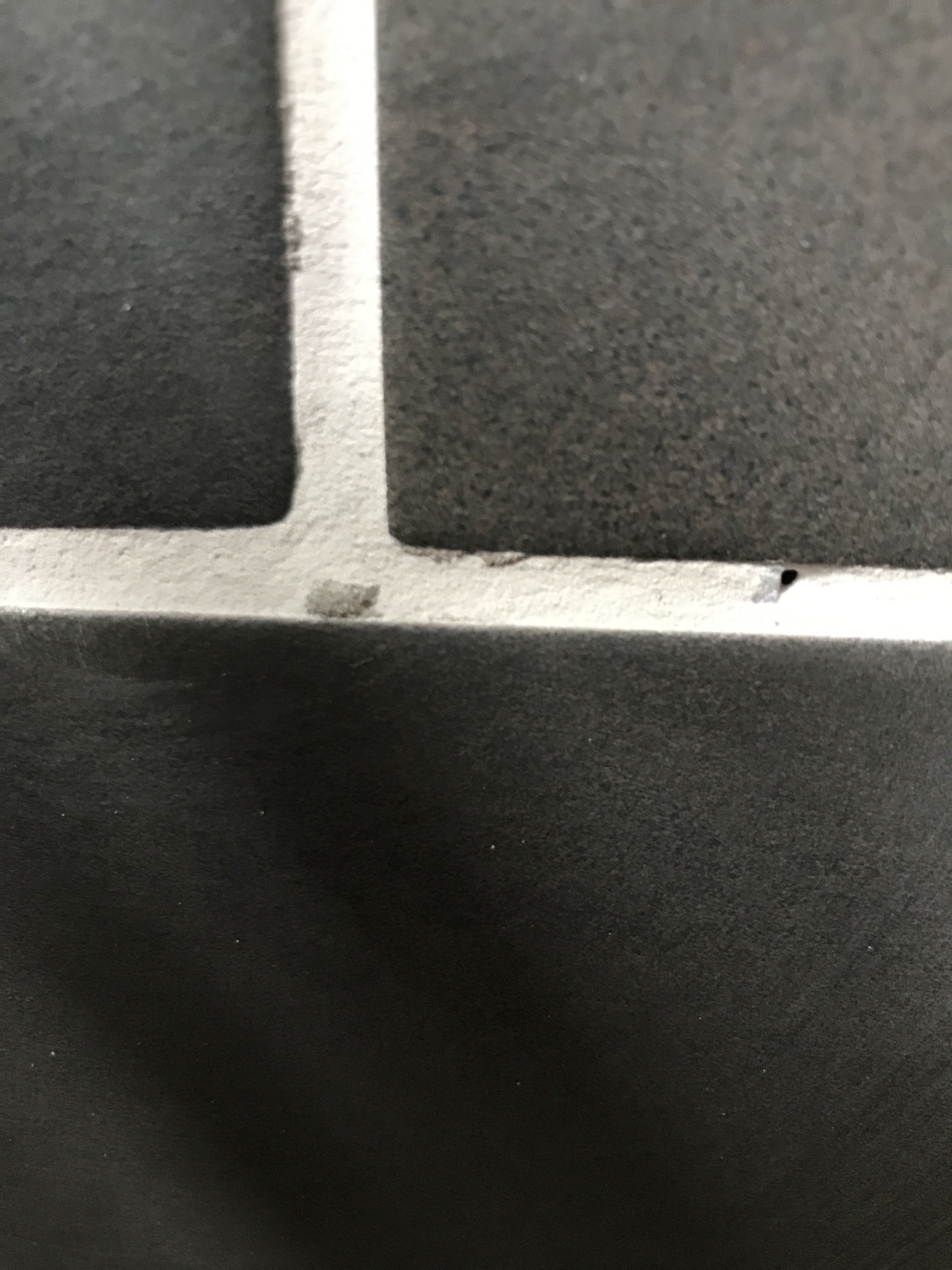

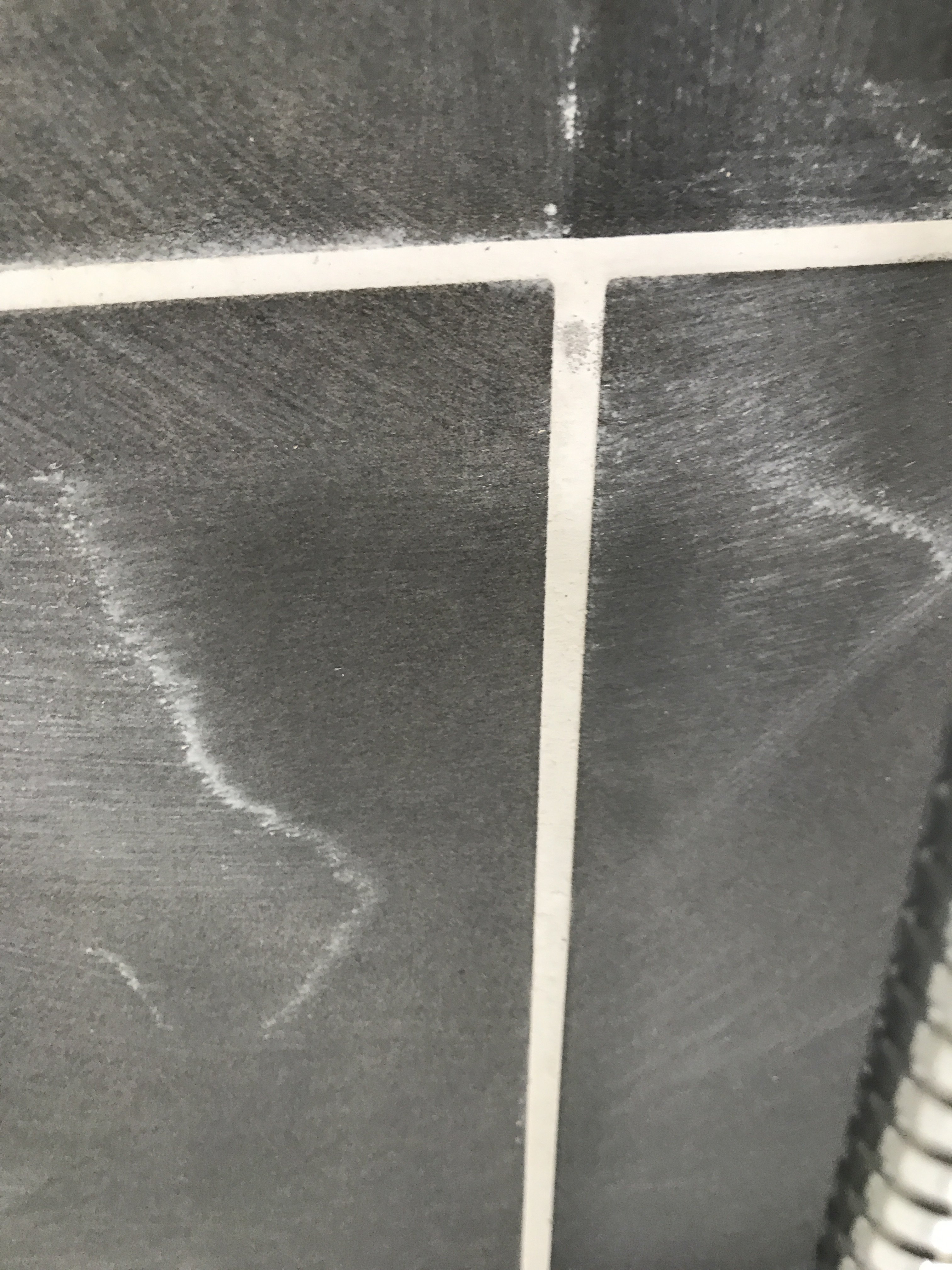

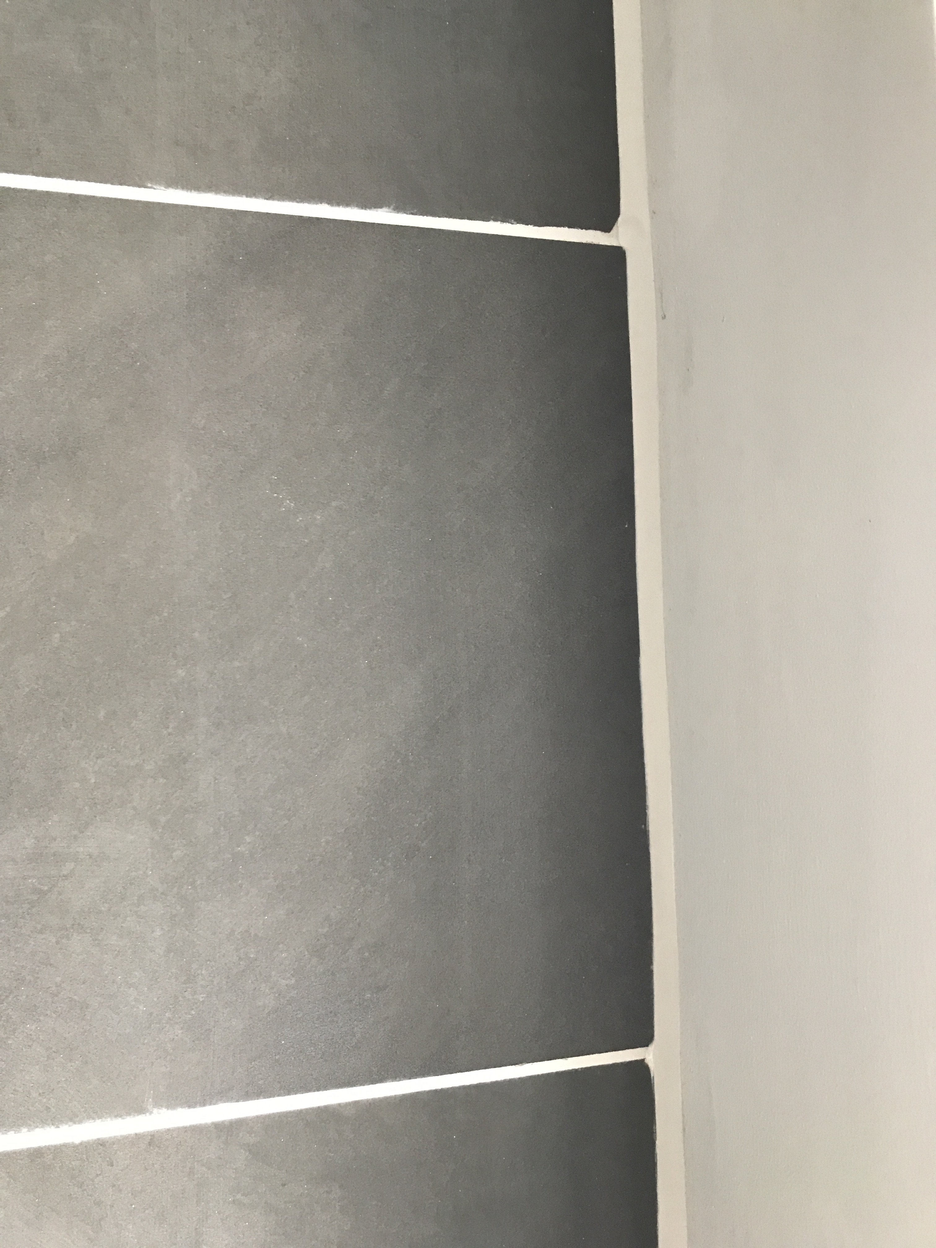

Here's the result. There's still some work to be done and he'll be back next week to rectify.
Couple of questions:
- Plenty of places where the adhesive wasn't cleaned properly and it's sticking out through the grout. How acceptable is this? Is there any tolerance for this that the trade allows?
- Two chips that I could see. Is there an acceptable number of chips per square meter that the industry allows?
- You can't clearly see it in pictures but some of the tiles are not level. This is why I was asking about lippage.
- You can see the shower line where tiles don't merge straight. With grout it looks better compared with the initial photos I posted.
What's reasonable for me to request without being a nitpicker?

Safe to say that myself and probably every other tiler on this forum wouldn't leave a grouted finish like that with remnants of adhesive left all over the place. I clean my grout joints as I go before the adhesive sets. Anything missed is removed before grout is applied. Not acceptable in my frame of reference.
The Silicon work is questionable and the fact that some of the crosshairs on the grout lines are several millimetres out is again not acceptable.
If you're handing over cash for a job you should only be doing so when you are 100% satisfied. Imo it's not nitpicking at all. You wouldn't pay full price for a car that had a big scratch down the side of it.
Id give him the opportunity to rectify everything that's needing fixed if he refuses then I wouldn't be paying full price. Have a tiler quote for remedial works and deduct from final bill. Furnish him with invoice from tiler and deducted payment. Fair terms in my book.
@georgechi - Tiling is a finishing trade and as such the tolerances are strict.
As previously advised and to answer your Thread title - Acceptable tiling? - NO!
A decent Clerk of Works would condem most of your highlighted concerns so don't worry about trying to find standards of acceptance.
If it's chipped, it should be out.
If it's not level, it should be out.
If adhesive shows through grout, it should be removed.
If there are holes in grout, they should be filled.
Etc.
There are too many Jacks who think they can tile, but we are only looking at the surface! What preparation was done? What tanking around shower? What adhesive? Did he tile straight onto the plaster and how long had it been dry?
Can you look at that every day?
