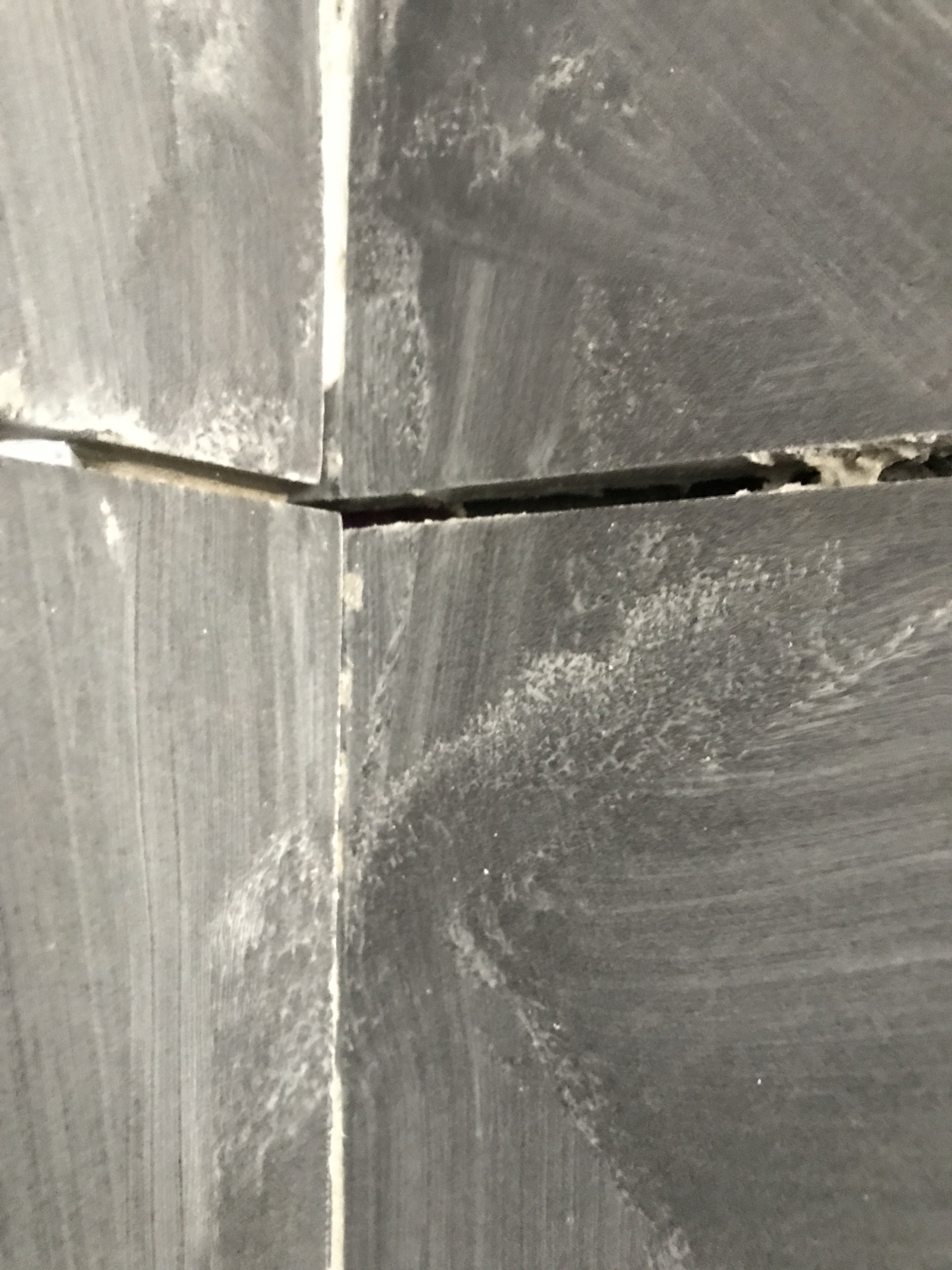

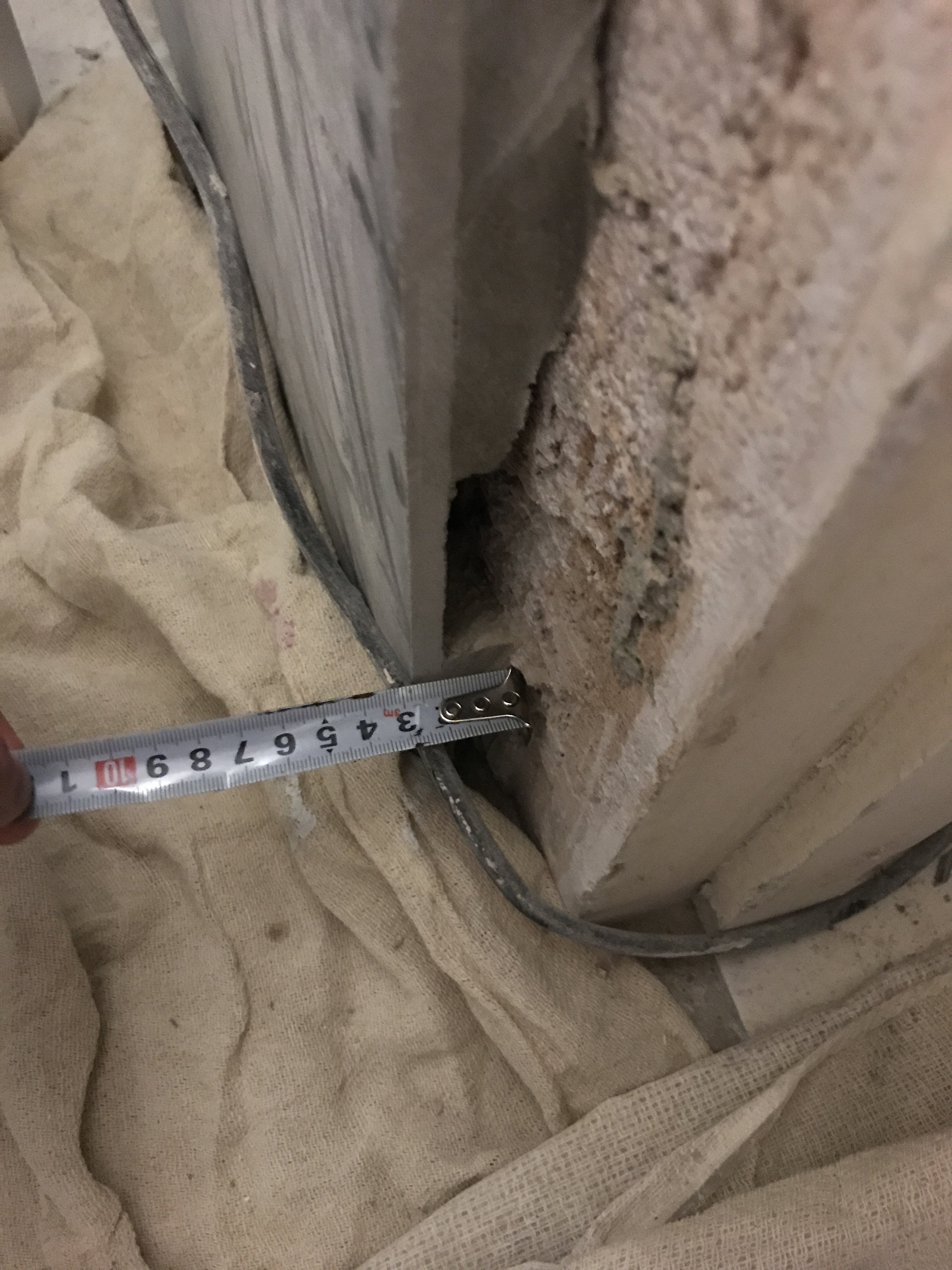

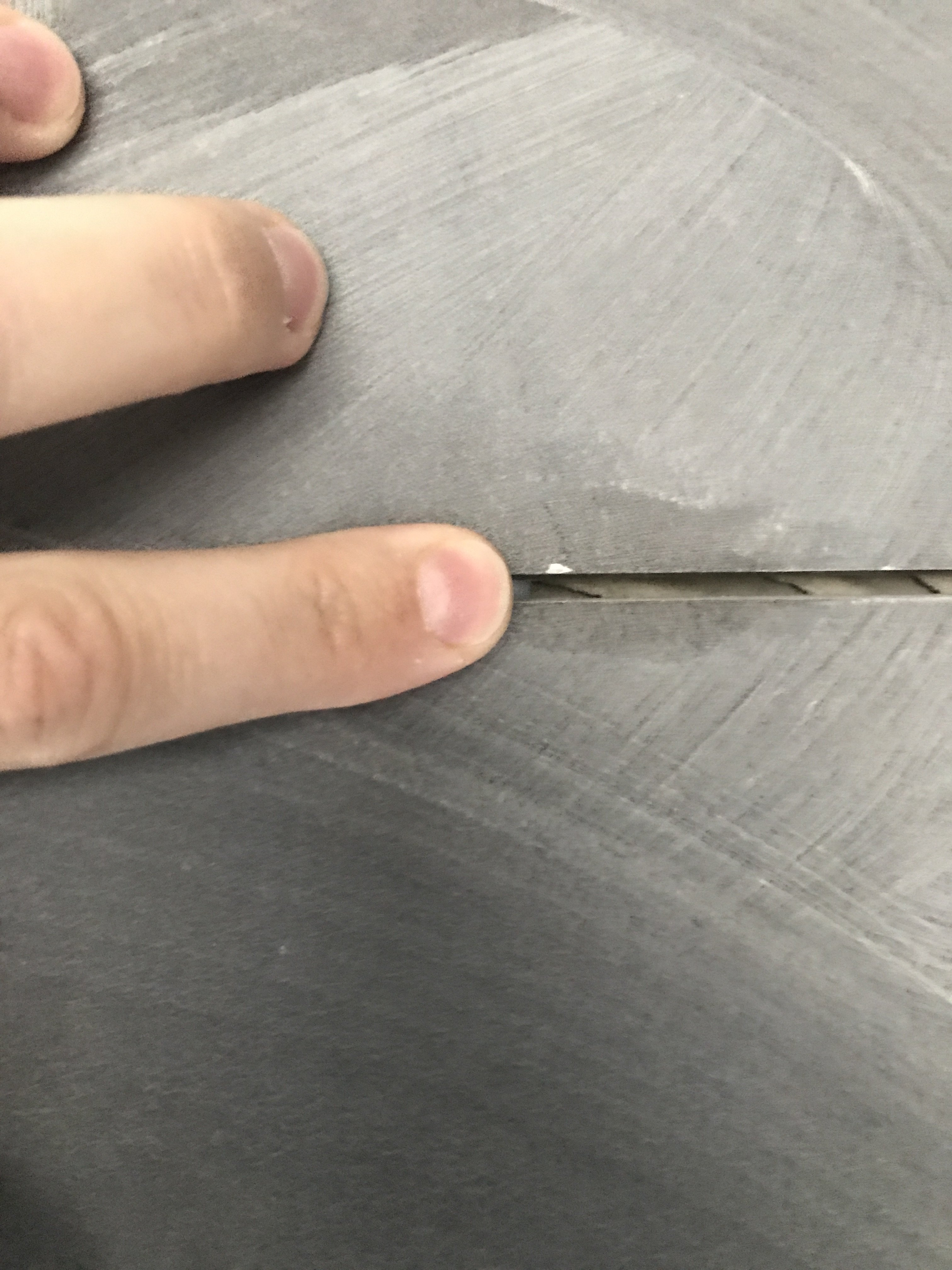

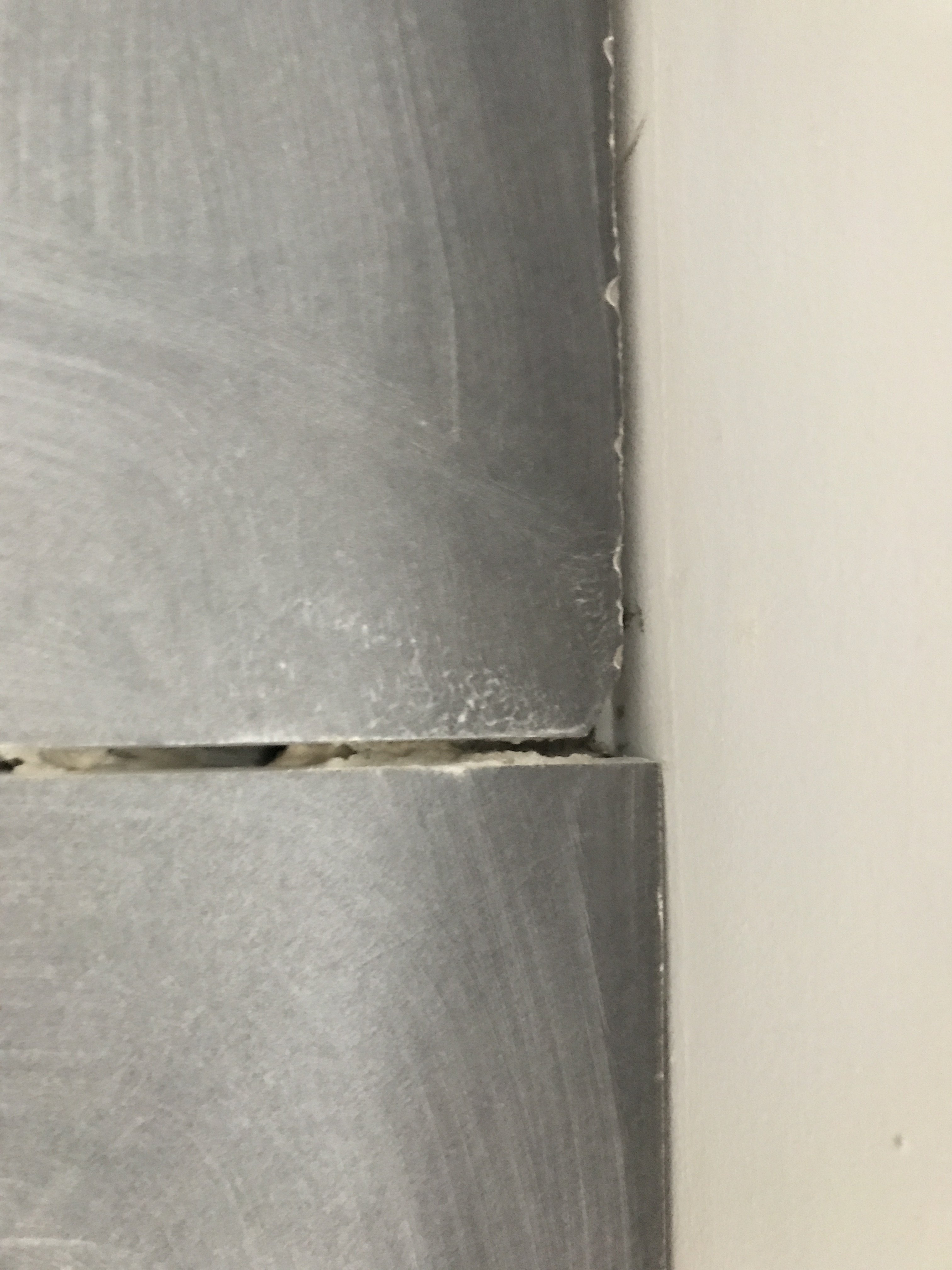

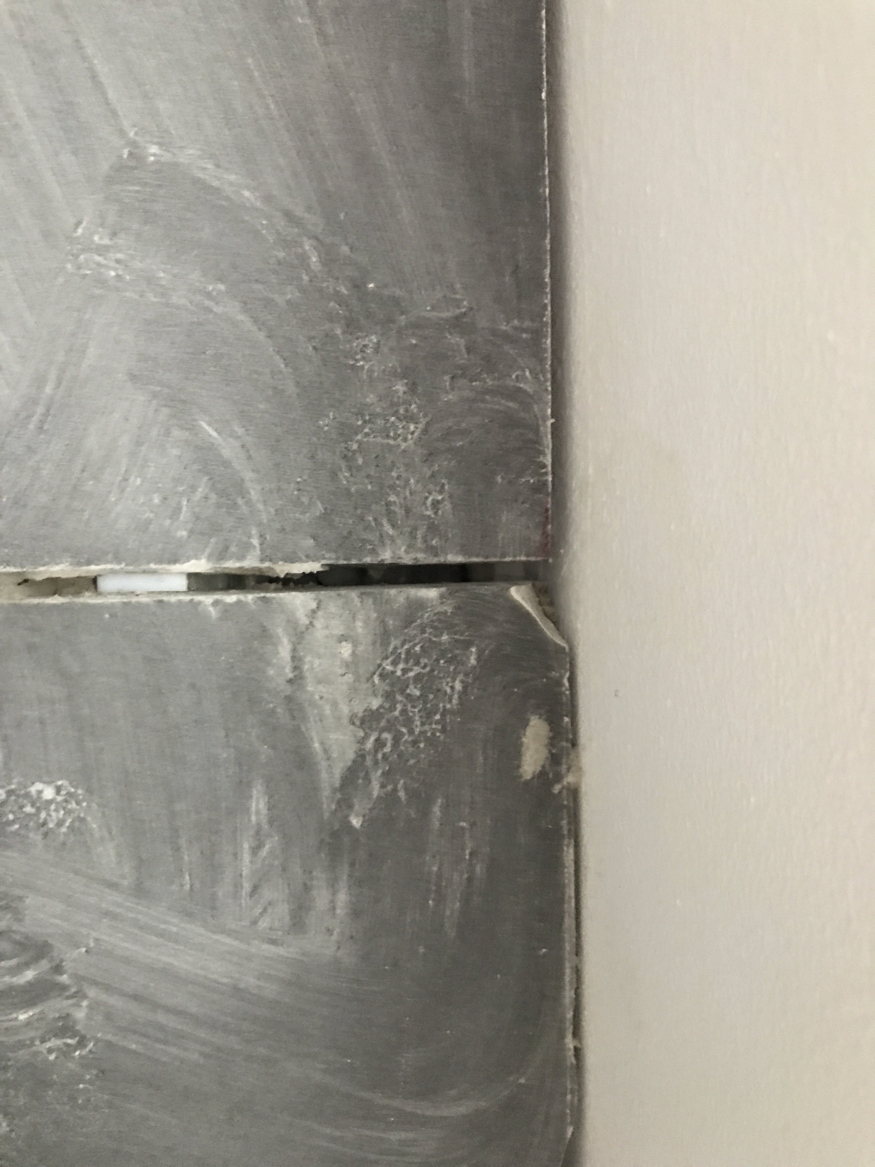

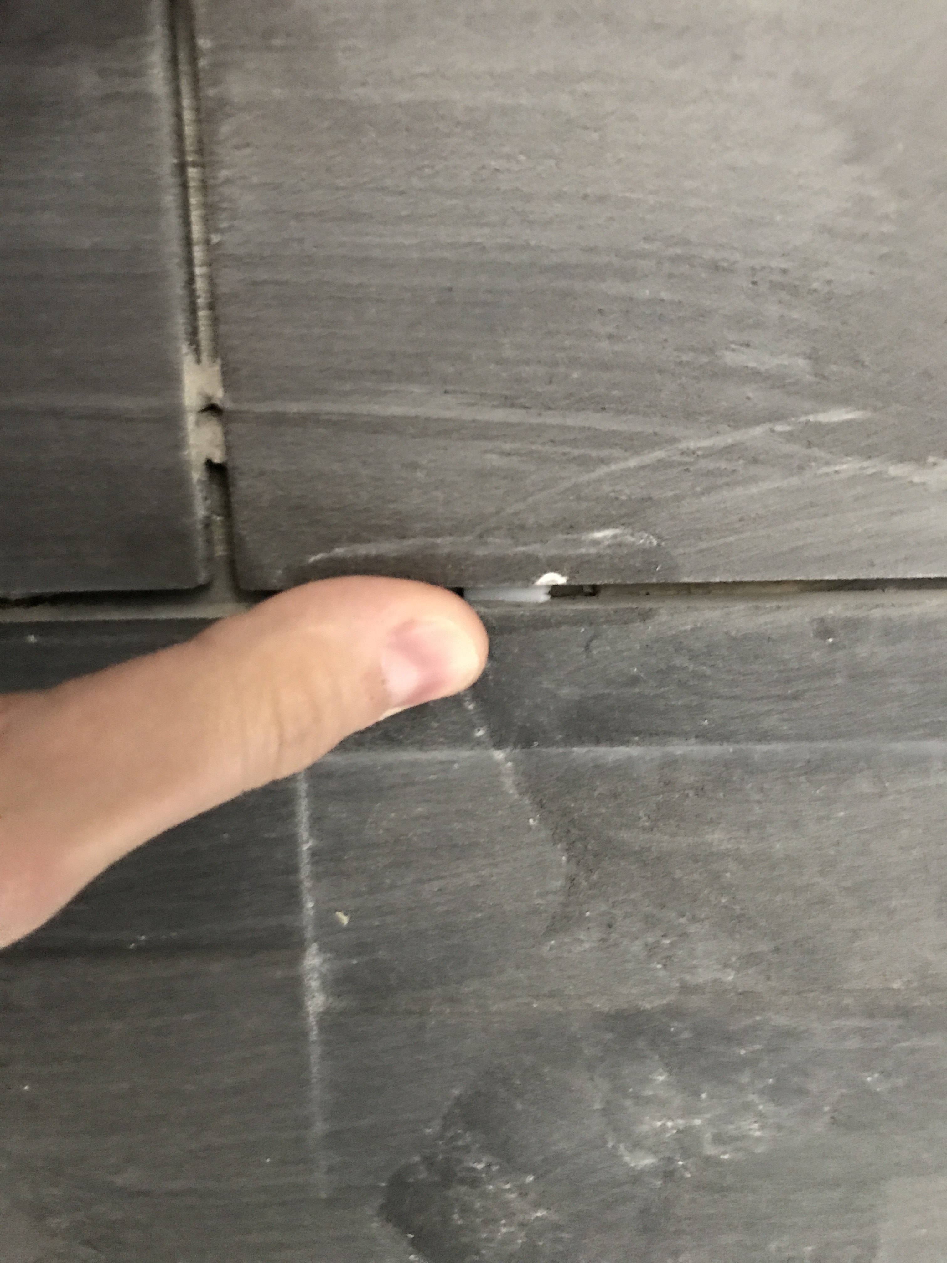

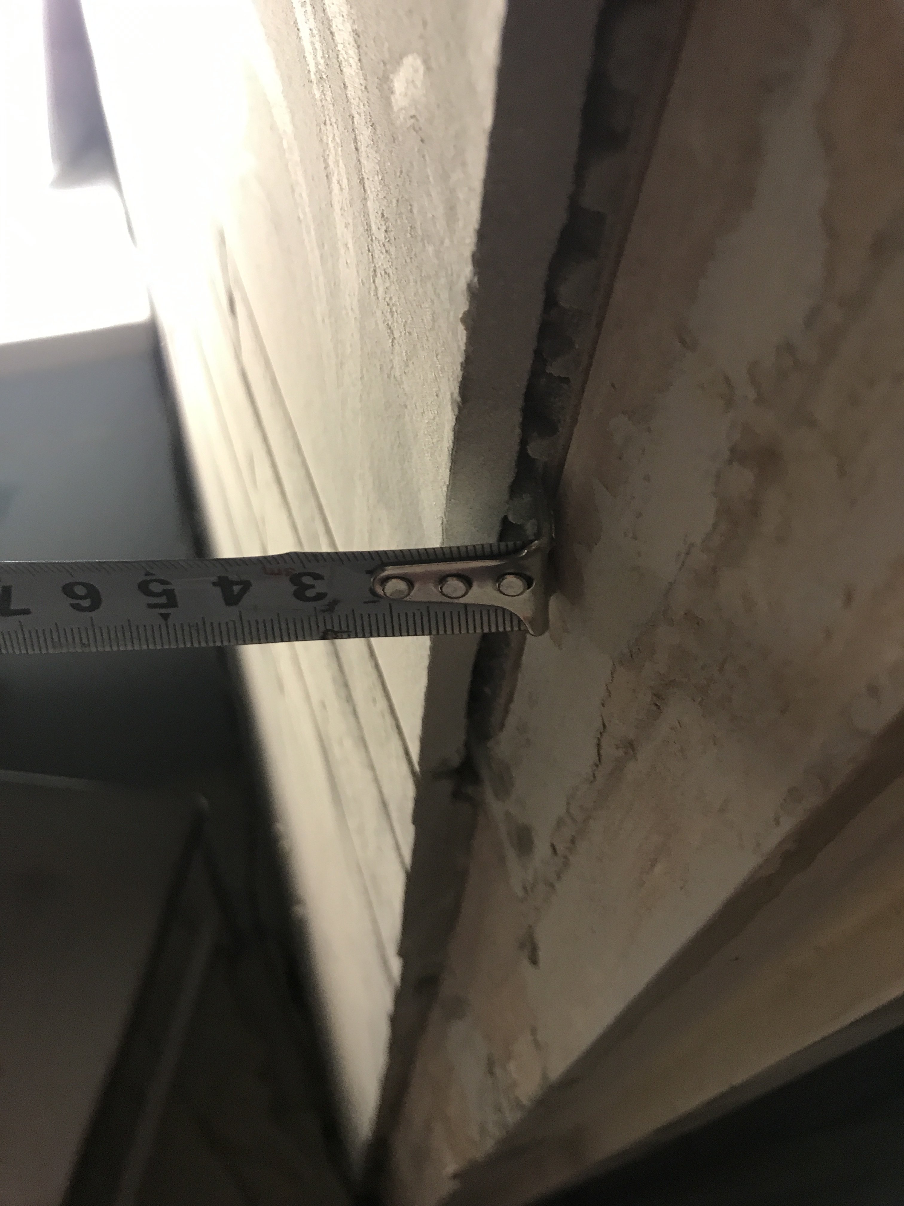

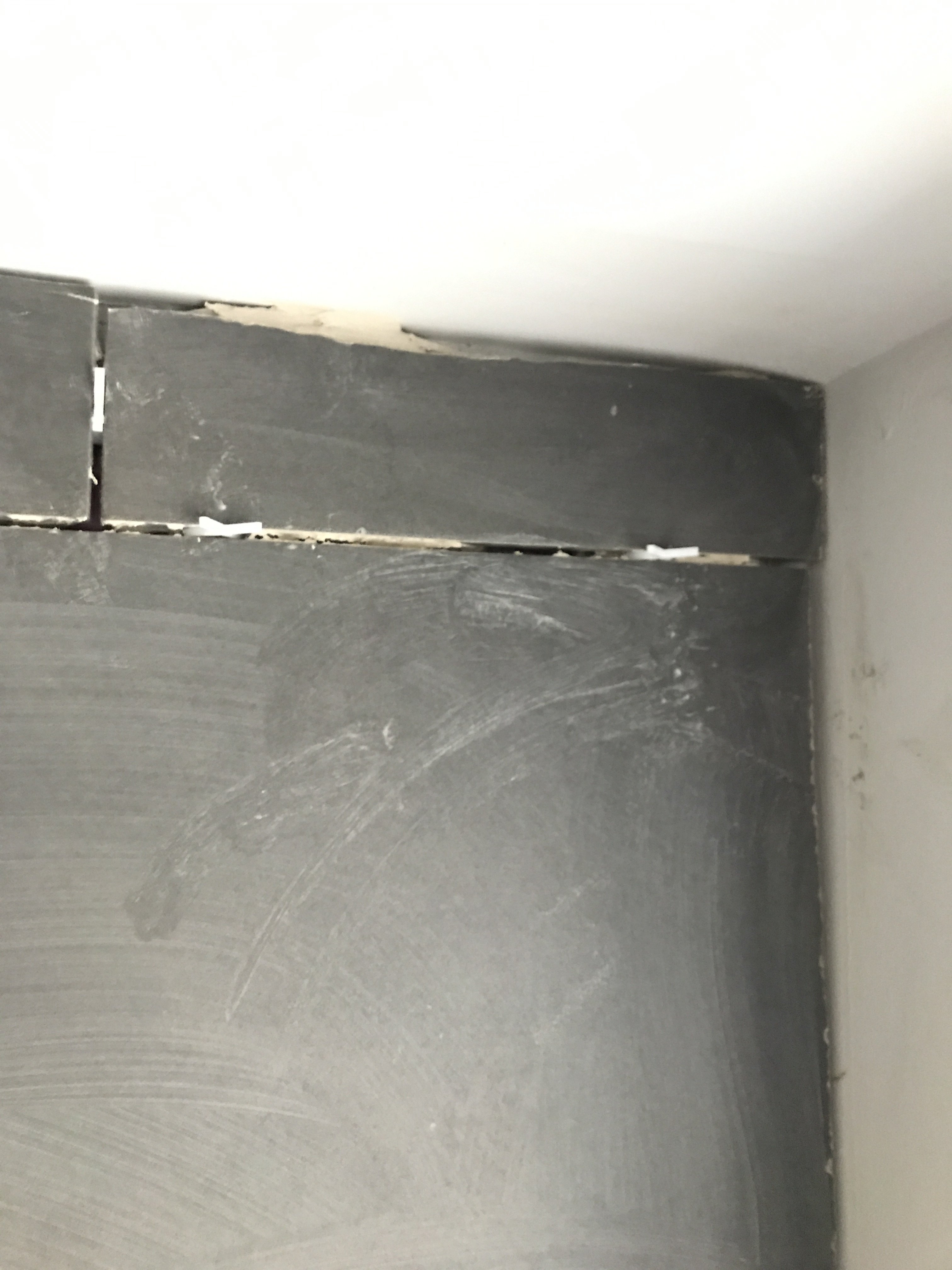

I've got someone doing my bathroom and yesterday they finished tiling. I've been going through the result and I'm not impressed with the quality.
Can you have a look and tell me if I'm too picky?
My issues:
- Some of the tiles are chipped (average sized finger for scale)
- In the far areas (far corner and top edge) they're not cut off straight.
- You can see one that's glued with a lot of adhesive and that changed the line on the wall.
- In a corner they don't match the height.
I've seen a lot of comments around how the grout will fix things. Would that apply to me? Would these issues be less visible through grouting? We are looking at a light grout (silver/ light grey).

Don't feel bad. If thats the best he could do then he should have held his hands up and said he was no good at tiling before wasting all the materials. That would have been you're opportunity to get a professional.
But still, give him a chance to see if he can fix it. If he says no, he needs to be paying you back to cover the remedial costs. Whether it be removing a few tiles or stripping them all of.
I may be misunderstanding your statement, but the work contracted was to redo the whole bathroom, including walls, plastering etc. If the walls were not in a proper state for tiling, that's something he should have corrected.
Point I was making. He has failed to take adequate steps to ensure a high quality job. Earlier images showing where has packed out tiles with adhesive demonstrates that.
I certainly wouldn't be recommending him for his tiling "expertise". It is a shame that you've been let down like this. That's the inherent difference between a tiler and a "tiler" a tiler knows how much tolerance he has in terms of flatness of substrates a "tiler" will wing it.
Certainly not bad for raising any issues with any tradesman who you're paying to carry out works. I'm sure if you were underperforming at work there would be some kind of procedure to address this. It's no different. You have hired him and put trust in him to carry out a job which he has assured you he is qualified to do. Clearly there's been some misinformation here. Standard procedure in terms of you hiring someone else and deducting from his bill if he's not able to rectify himself. At the end of the day it's whatever you are willing to accept.
Not sure if thats an external corner shot (and if so its location in the room) but I've seen those with extremely sharp edges, and rarely uniformly neat - would those experts on here suggest a trim or 90 degree joint ?

uncalibrated slate tiles not the best to buy i personally wouldn,t have taken the job on
