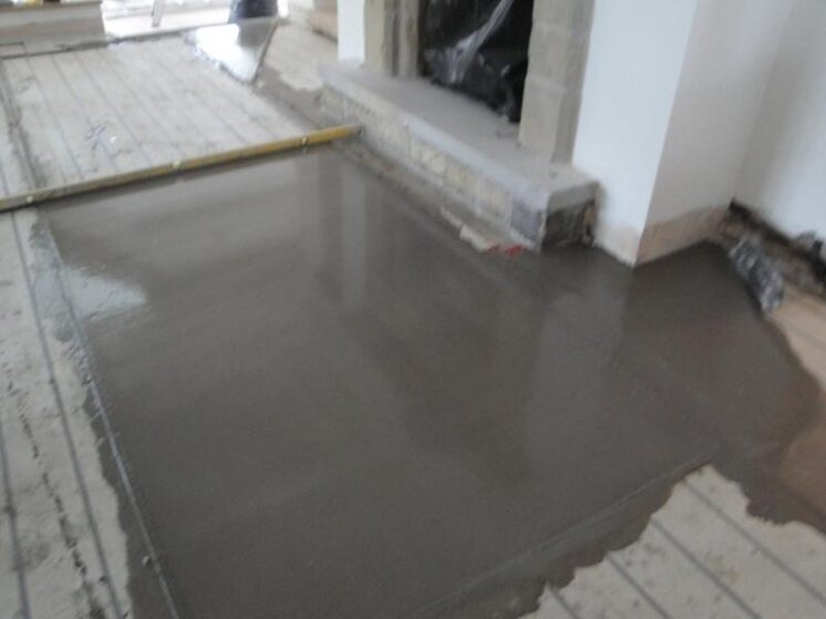

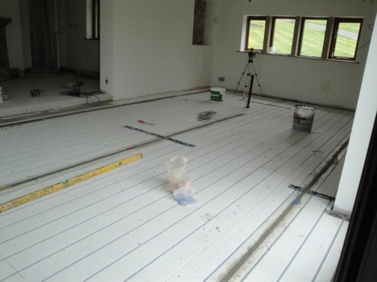

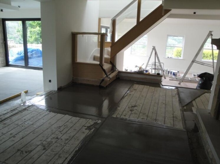

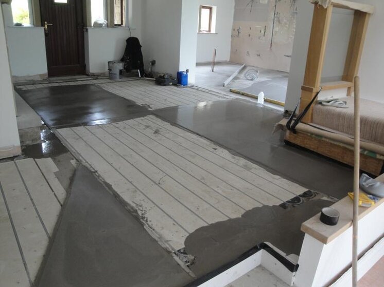

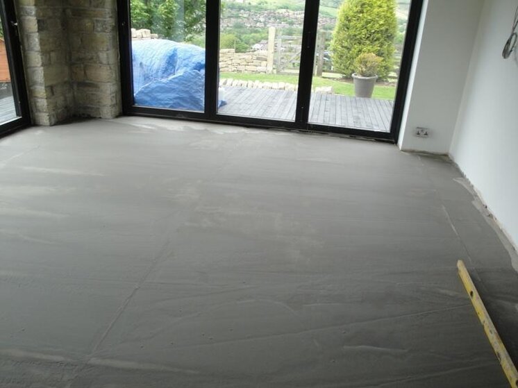

nice one Phil! ( i don't want to hijack this thread) but, i understand your methods using sand cement fixing but with current methods, on an uneven substrate, how could you ensure that each tiler in each bay is following the same plane or height? A slightly different angle on trowling could have a mil or 2 difference in bed thickness! ... Fascinating Post Phil!!

Sorry Jonny,I missed your post, just found it, but these sand and cement jobs were not that long ago, but as I said to Mark if the floor is prepared for adhesive fixing, then the legging out method still works.
