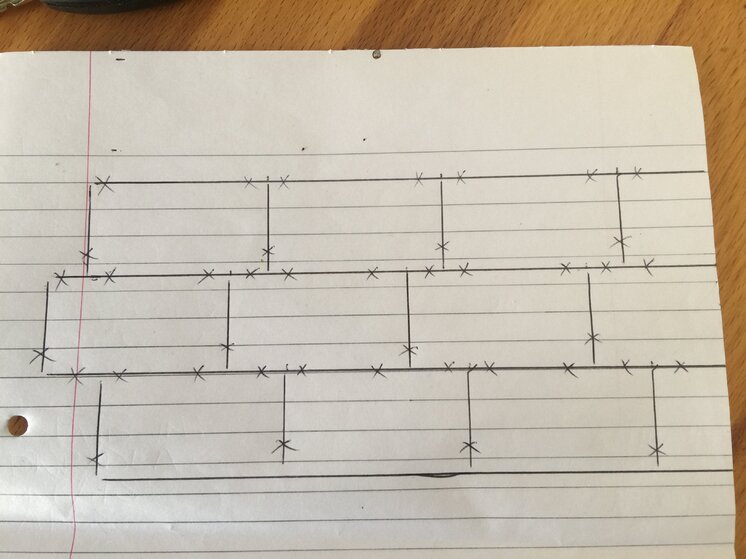

Question. Using Genesis and Lash as an example, I'm trying to figure out how many clips would be used per tile. I know if they are laid straight bond, its 4 per tile. 2 at the top and 2 at the side (4 per cross joint). But what about say a 900x450 laid with a staggered bond? Am I right in thinking its 6 per tile? 4 on the long edge and 2 on the short? 3 around each T joint? or is there a way of using less?
Confuzzled!
Yep. 🙂
It will depend on tiles but u can still get away with 4,
U don't always need two on short edge, quite often the one will do, 3 on long edge.
And if someone dared to do proper brickbond, 4 on the top edge and 1 down the side? Also, I guess for a thinner wood effect (150 or 200), the end one wouldn't be needed?
Tbh Paul it's a judgement call at the time, no real hard and fast rule.
