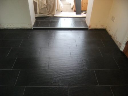

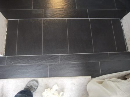

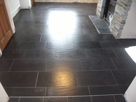

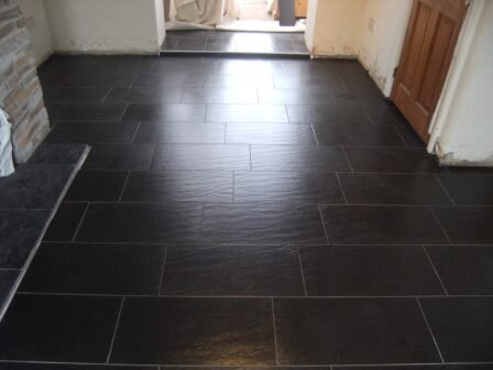

The customer wanted the joints staggered and not to be repetitive so i have gone with a joint break from 100-200mm and changing it in direction so it gives the tiles a wavey look, will take some pics finnished tomos and will post them so you can see it finished :thumbsup:
Some pics of it complete would be nice as well please..:thumbsup:
Here you go im finished chippy going in tomos to do skirting fire sorround etc.

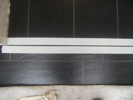

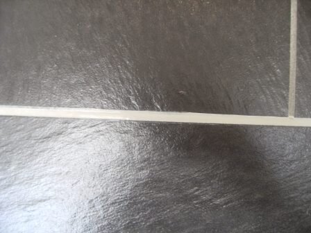

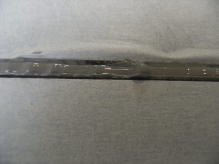

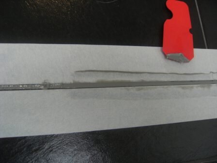

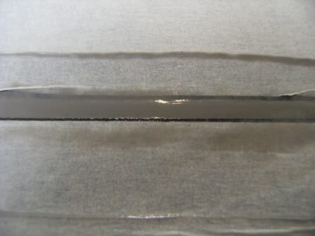

And some pics included on how i made my own expansion joint too:hurray:

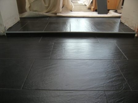

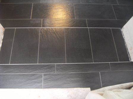

As there is a small step up into the conservatory of only 35mm i turned the tiles the opposite way so as to make the step more prominent to the eye, couldnt take pics of the conservatory floor as it is covered in the furniture from the lounge.
Hope you like it :drool5:

Wow epic prep job, shame people just walk on it. Not realising the amount of effort gone in to the prep. Looks good:thumbsup: Nice when customer pays to have job preped, instead of getting saddlebag ceramics to do on the cheap. (false economy IMO):hurray:
