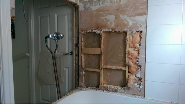

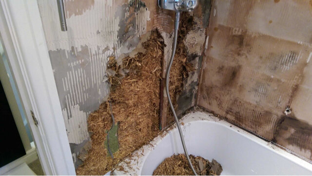

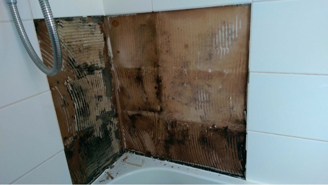

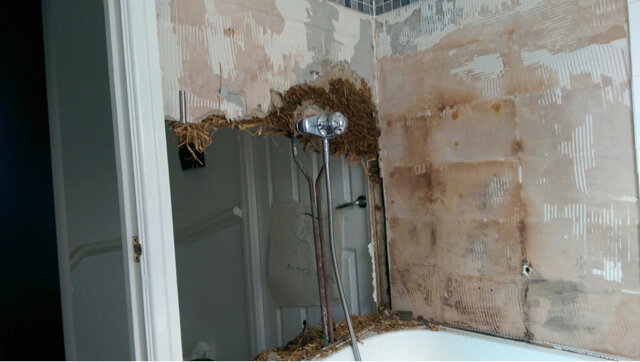

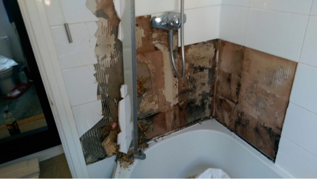

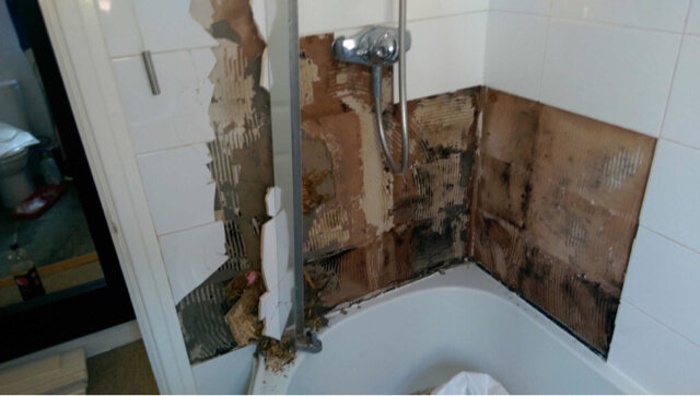

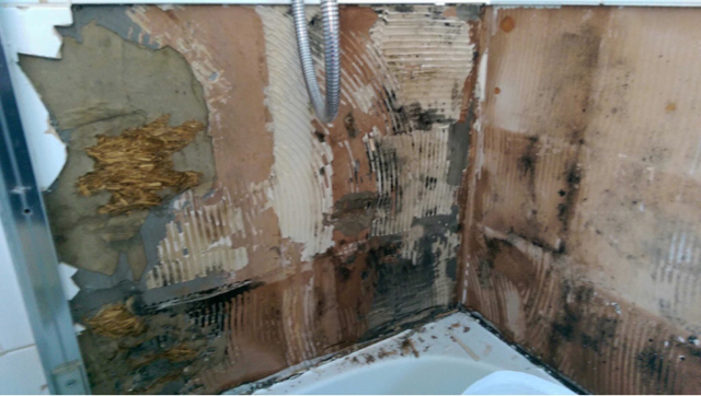

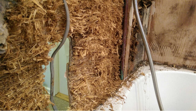

As no grout and adhesive is waterproof (is water resistant - stays as it is and doesn't disintegrate) it will eventually let water in and cause the damage (like in my case: tiles on the plasterboard not tanked) leaking through the floor and into living room below. The walls in my bathroom were originally compressed straw solid 50mm thick panels. One of them got soaked and repairs got done by previous owners - they put plasterboard and tiles on top of that. That also lasted only couple of years and now most of the bathroom needs a full rebuild (I'd like to post some photos but the data limit is ridiculous 10kB...)
The question I've got is when I rebuild the walls around the bath with some sort of cement board and then tank it, where that excess water will go, as the grout will let the water in eventually but not causing any damage. Water will be dripping down the wall and on the floor then what next. Would it stay there and evaporate? Would you tank it only to the level of the bath?
