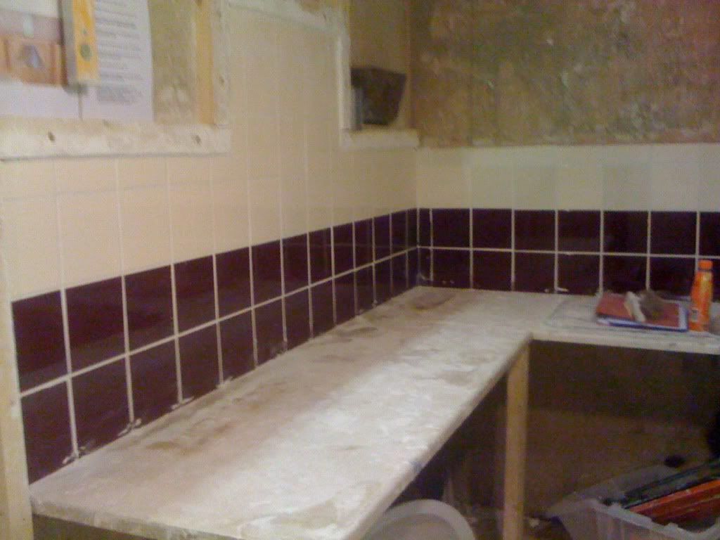

Finished the tiling in our kitchens. Then were taught how to growt Mixing it up etc. Struggled abit to start off wth as i was taking abit too much time over it. Until i was shown a technique by one off the lads that runs it off gettng a "pasty" shaped dolop then pushing it in the gap and sliding it acroos then away. I finished 3 quarters off the ktchen in a quicker time then it had taken me to do the first quarter.
Shocked at how much grout makes a difference In the overall finish. Took a step back and was proud at what i had done.

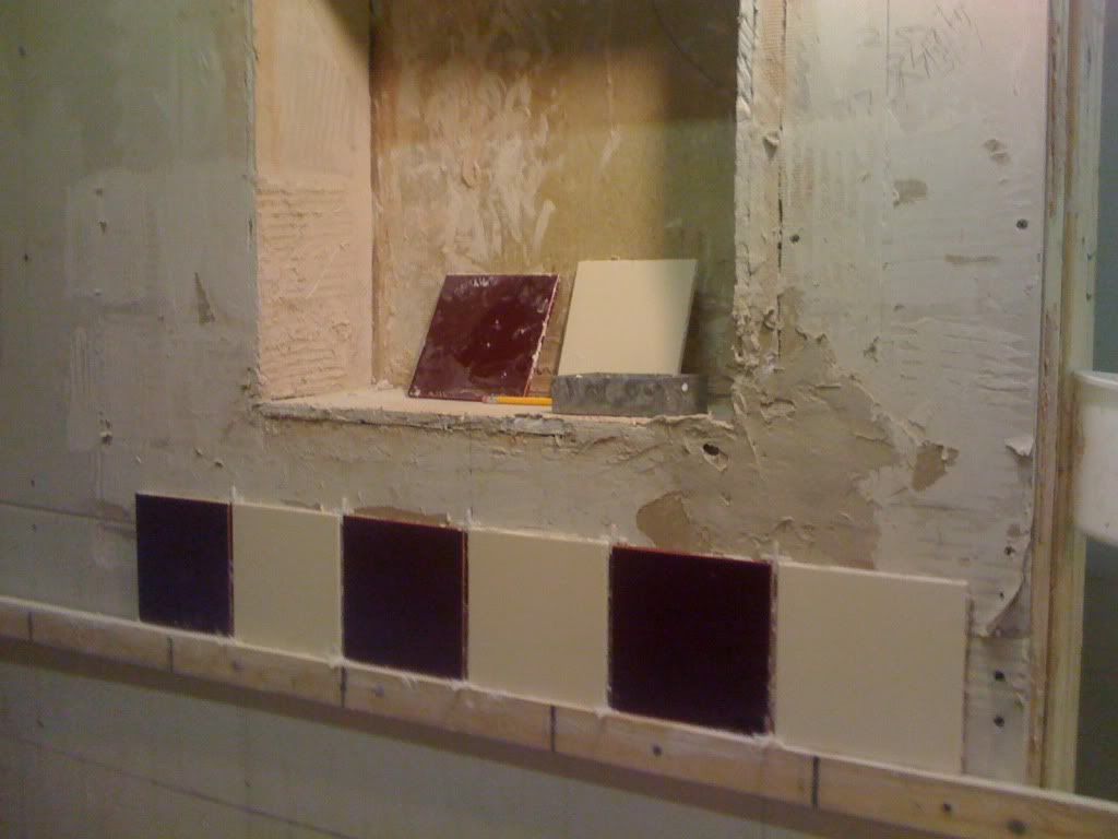

Next we had to tile round a window. The lad teachng us warned me that my window was nackered and had lumps and bumps and had seen better days. This didnt really bother me until i had cut all the tiles and started putting them uo and they wouldnt line up ot would but sat at an angle. Again the instructor lad came over and one off the lads that ran it. and explained i could chisel it out ot reboard it and showed be how to "double butter" it using a bigger trowl. Worked a treat and i was even prouder lol.
I could have had a perfect wall but im just counting it as expierence as how many houses will work in that will actually have perfect flat walls. Didnt get to grout it but still happy.

Pics are my kitchen finshed except for cleaning bottom tiles
My window before ( know it would have been better to re board it f it was a customers house)
Durng
And after (not cleaned or grouted)

didnt they show you how tile a reveal thats out and make it square

they will probably get onto that its more for when your tiling the reveal to the top but i still do it when tiling part way up
so if a right hand reveal is out of plumb strike a line down from the the part of the reveal thats over to the left and mark on the cill, cut your key cut as you have done but cut it to the mark. tile up the face so that the left hand edge is plumb. you can then make good to the reveal so that you have an even adhesive bed
its the opposite hand on the left hand reveal, when the jobs finished the window is framed nice and square, theres nothing worse than tiles folowing a reveal that is out of plumb and it really shows on the finished job
they will probably show you this but if they dont ....ask!
