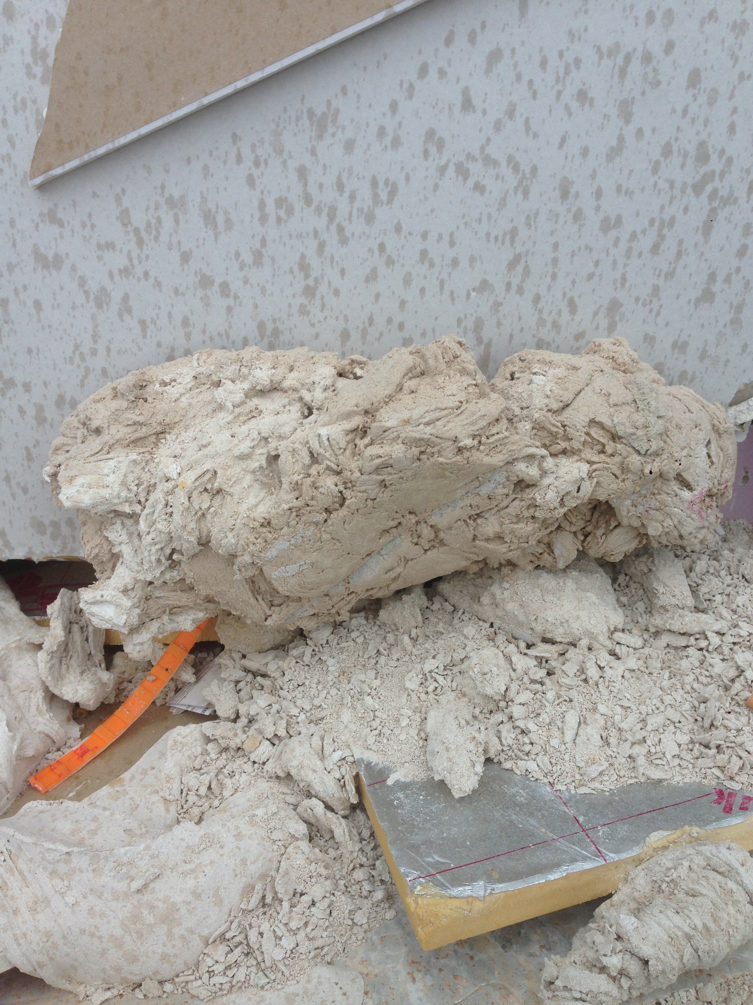

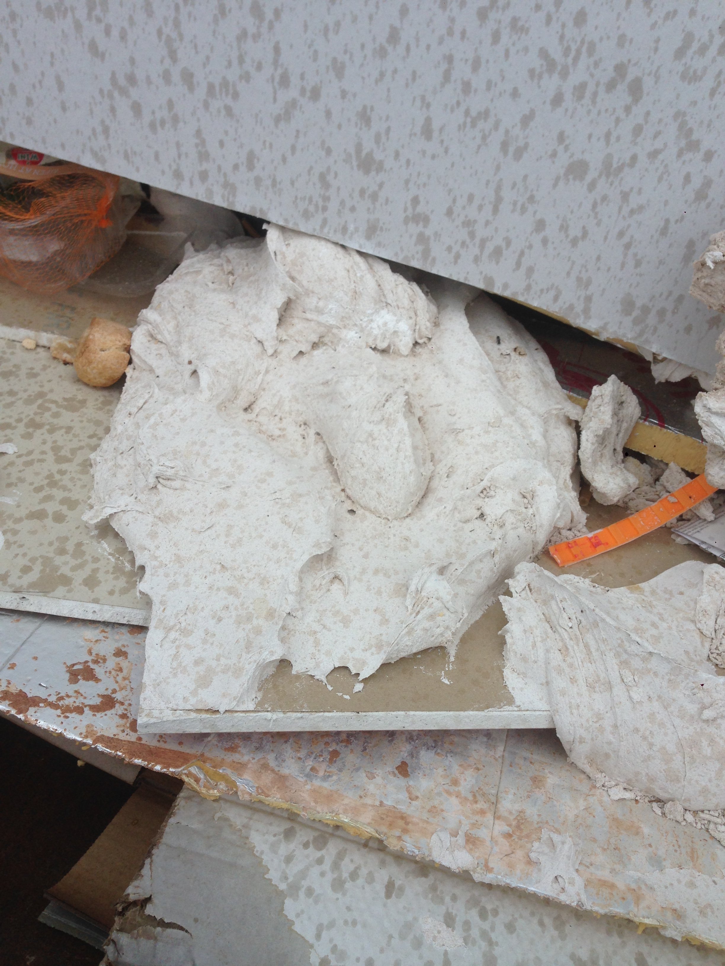

The bags have been burned on the fire so no way of finding out the batch numbers, although I did manage to take some photos of the problem mix against a good mix... the bad was really crumbly, weak and dull in colour against the good mix
