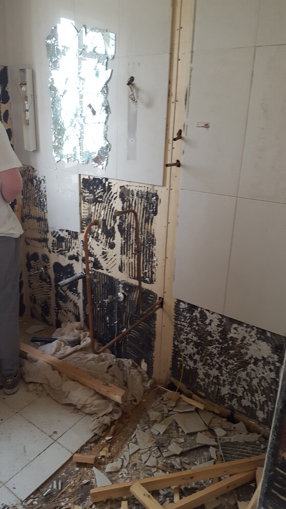

15 year tiling, i have never seen a bathroom sheeted in 18mm ply on the walls. in 15 year i have never had to drain a 5000 litre heating system ( to move a heating pipe 50mm!)
