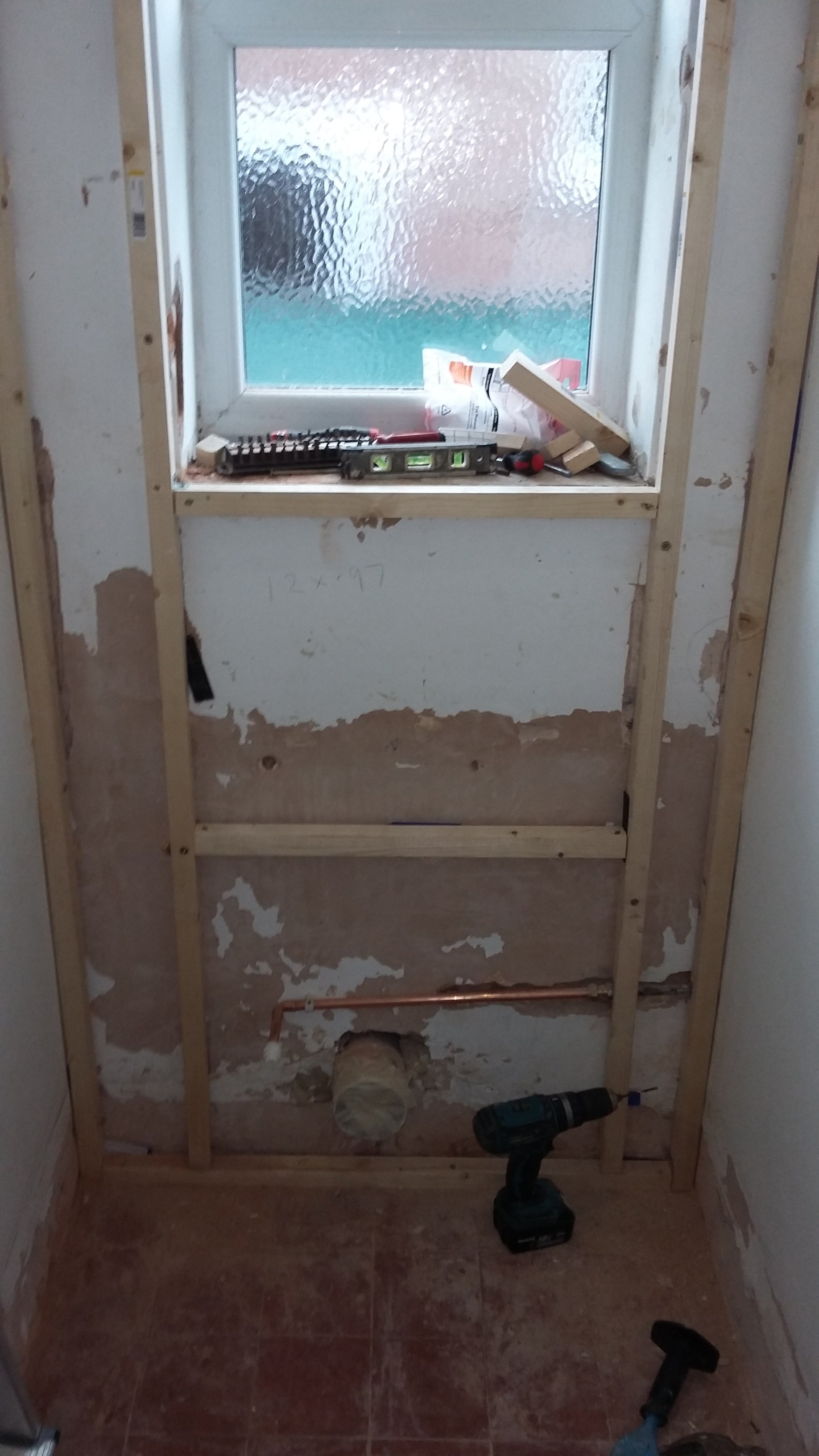

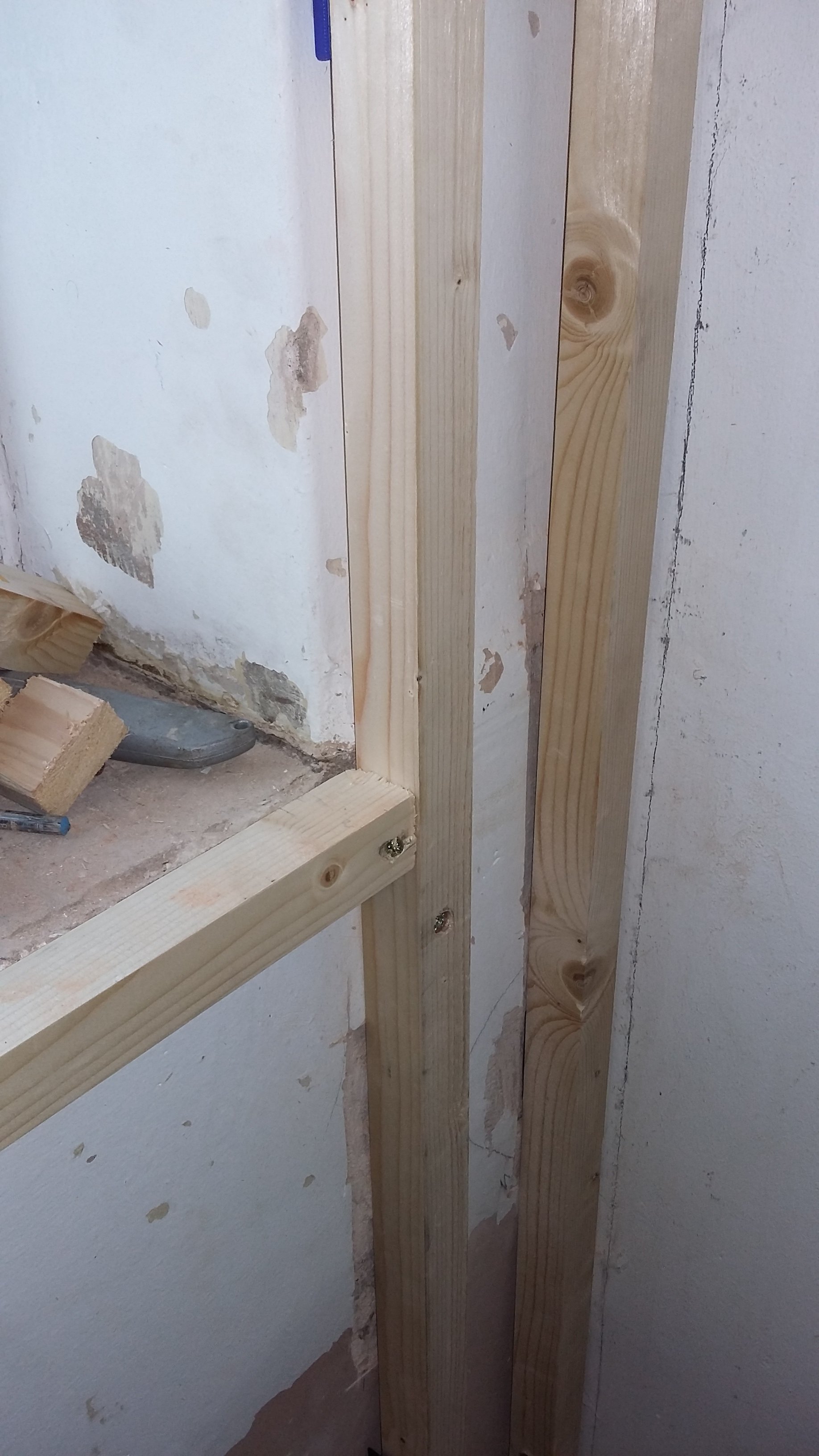

The window wall was out by 80mm top to bottom - got it down to 40mm after taking out a huge bulge under the sill but still no good to tile on even after stripping the wallpaper off (yes it was tiled onto wall paper). Decided best way forward was to stud it out. That would also help with the toilet feed that comes through from utility room in a way that it can't be chased in unless I remove worktops and units and re-pipe from there and I wasn't going to do that.
Not much window frame on show on the sill. It had an offcut of gloss kitchen unit, plasterboard, tiles and then more tiles

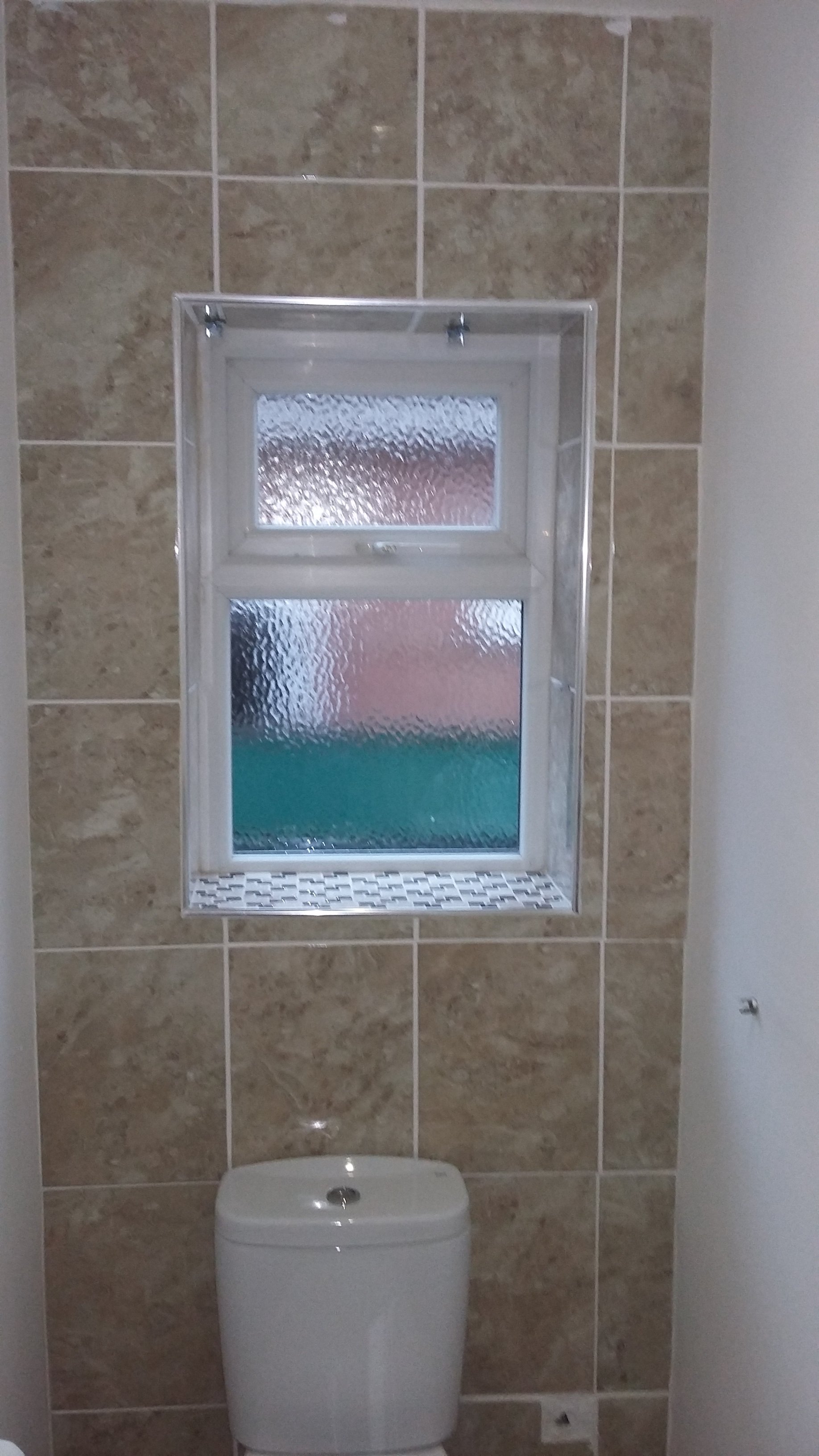

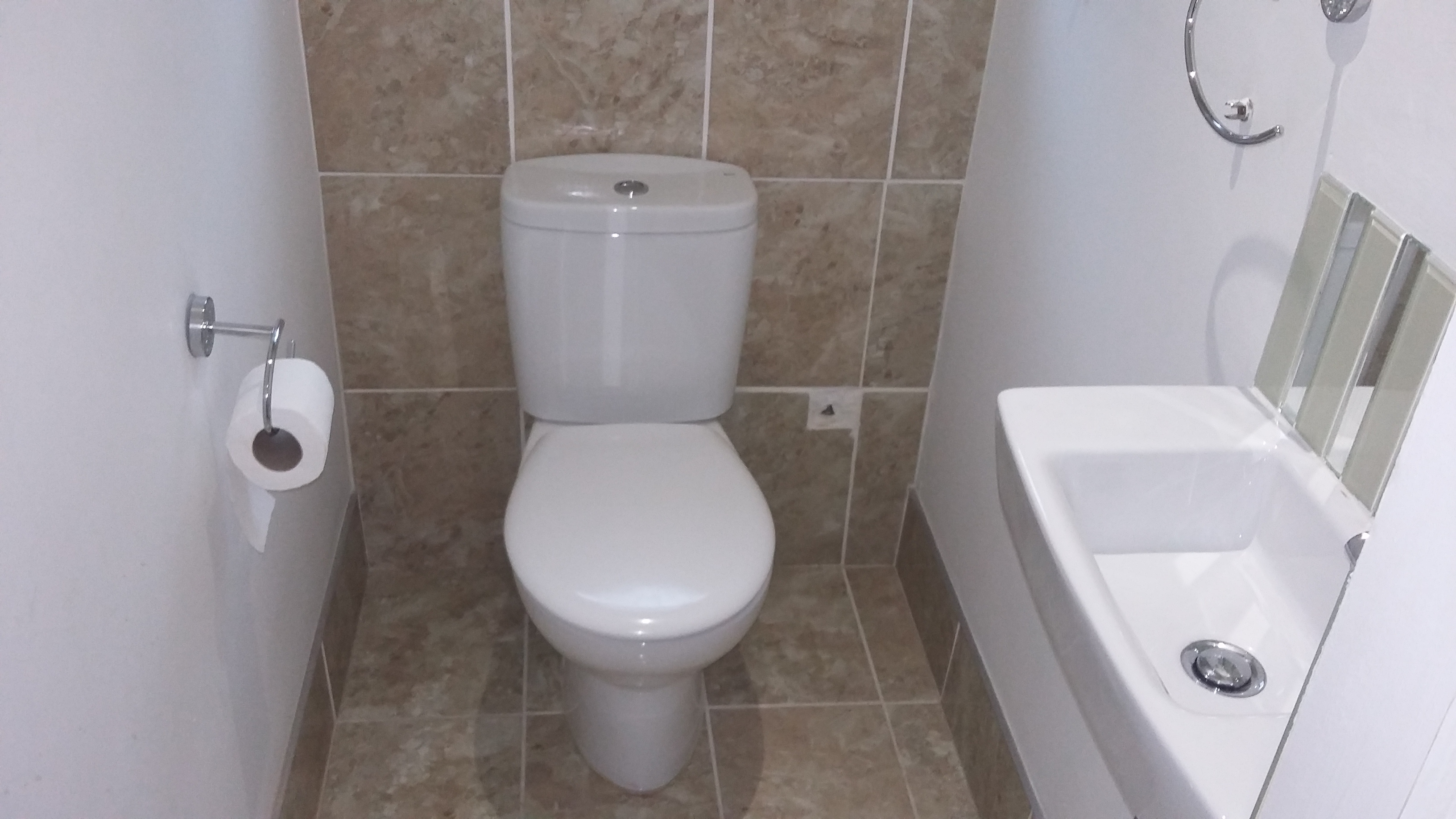

The gaps between pb and reveals was intentional Need to clad the timber and cove the voids from packing out around window with cement board and all should be good.
Question - would you guys centre the wall or window? (normally I'd centre the window as it's a feature) but I'm thinking wall in this case as the window isn't central and nor is the toilet and the tiles are 30x900s and the wall s about 970mm.

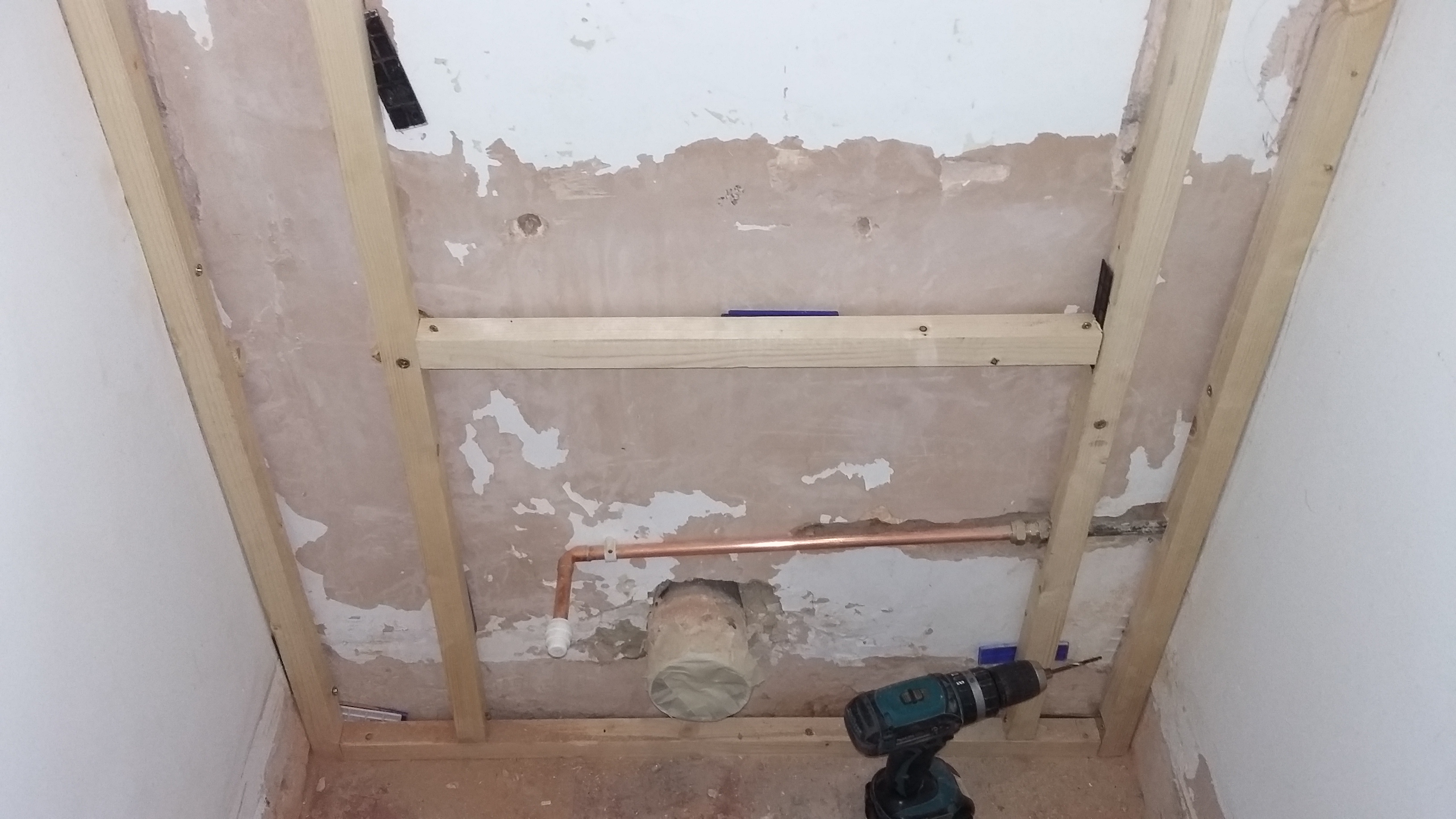

Would rather see a soldered fitting in behind the boarding . Compression is looking fir future probs!
Me too.
State and position of pipe and constant water weeping meant only way to avoid comp fitting was to rip out units and worktops that had been put in a fortnight ago next door in the utility room.
So although I agree it's better to solder a joint or have no joint at all I don't subscribe to the idea that all comp fittings are a ticking time bomb. If there is to be no movement in the pipe, you use a good make, jointing compound on the bevels and fit and tighten correctly then a comp fittings won't suddenly develop a leak.
Iso valves on the other hand are a real no no because they have an O ring that WILL perish one day.
