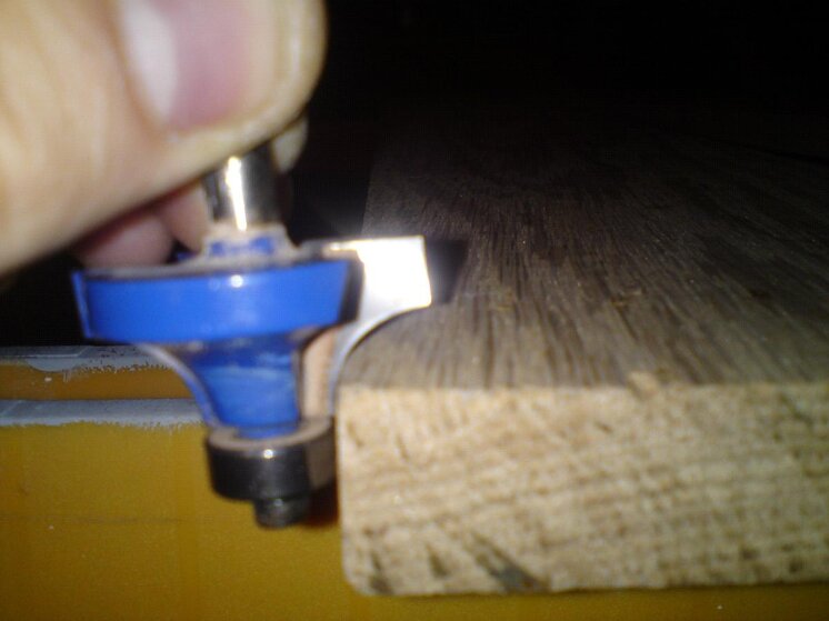

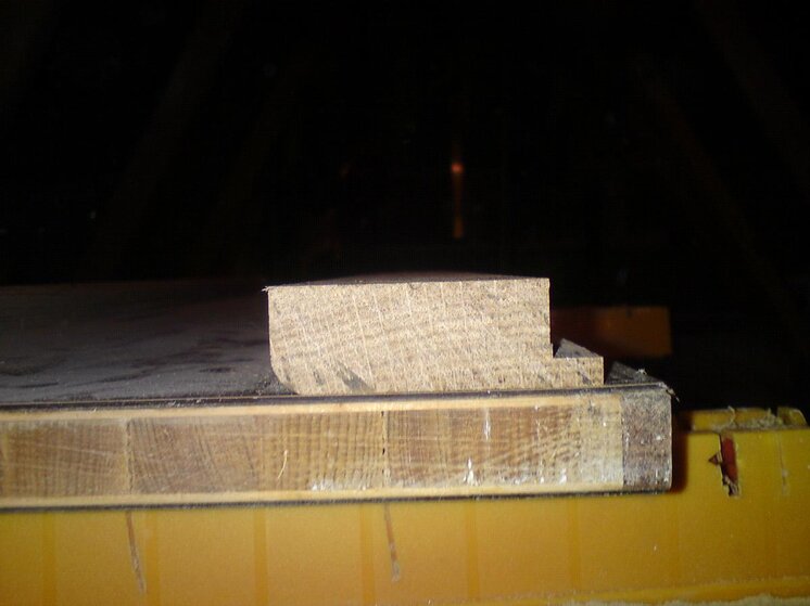

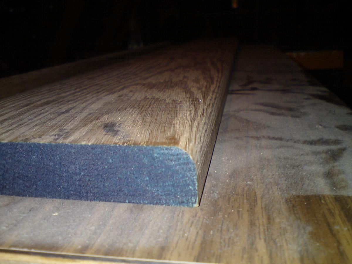

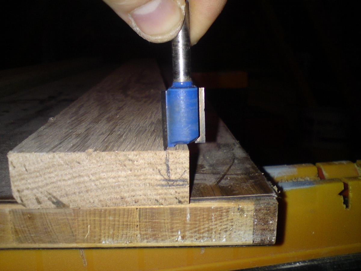

Make your own Oak door bar/ transition strips
cheers for trying mate!
They basically went in the exact oppostie order e.g. if you looked at each pic from the bottome upwards it would have correspond to the text from the top downwards
if that makes sense:lol:
correct order of pics:thumbsup:

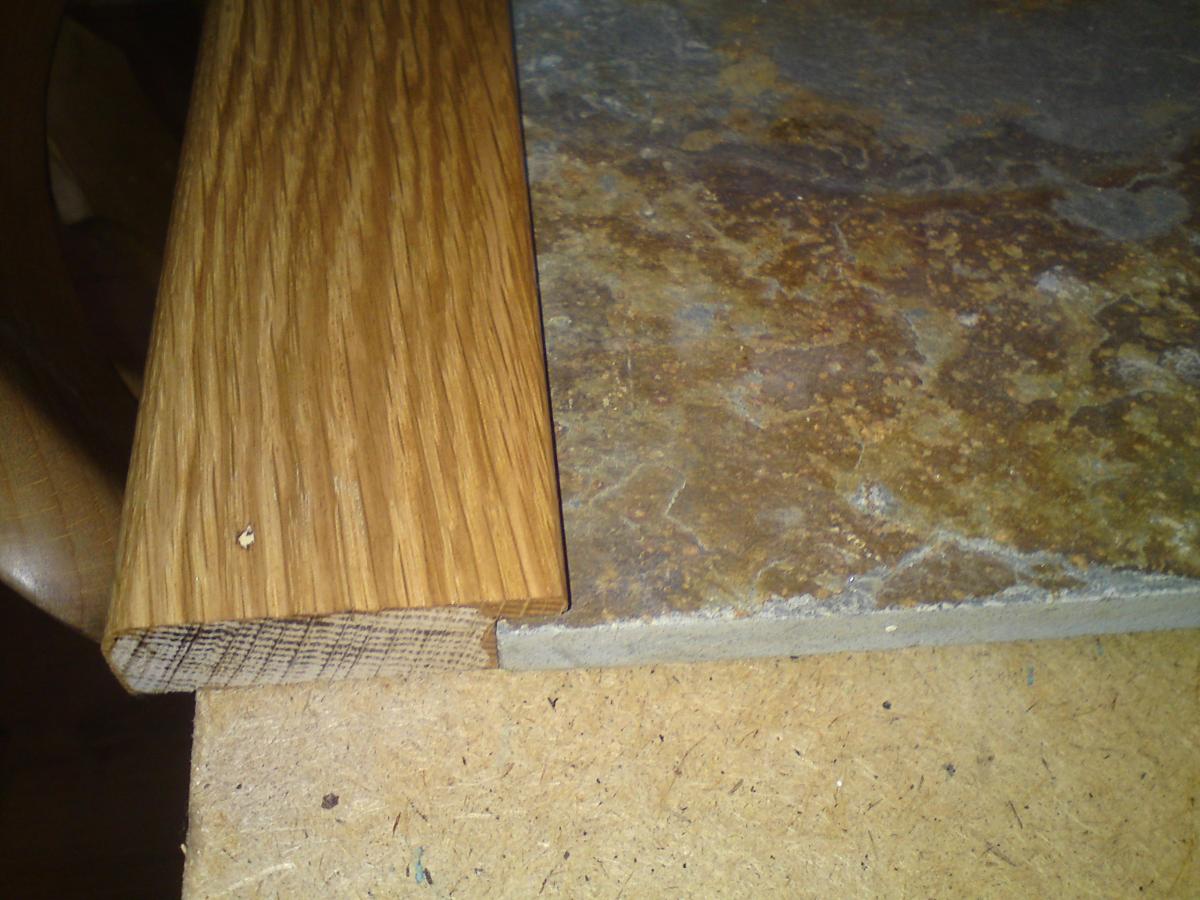

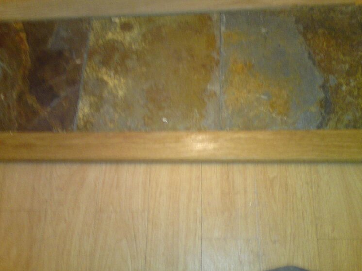

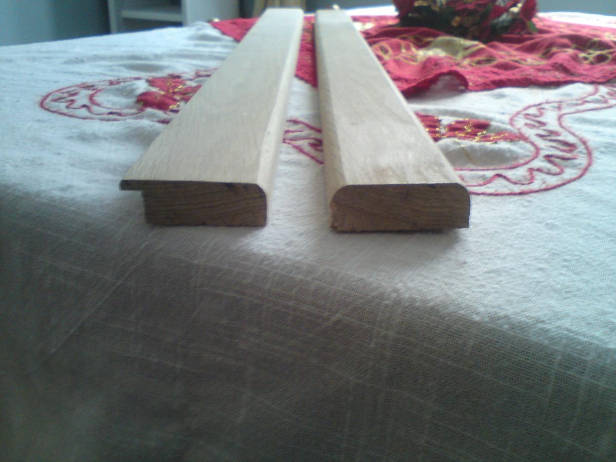

Great thread. Well illustrated with the pics. Worth mentioning these cost from about £16 - £25 and with limited sizes.
exactly mate, if you make yourself, you can do so to whatever thickness you choose, if rebating you can also do this to the depth of any tile you use and you can get lengths of timber upto 4.6mtr in any decent merchants.
